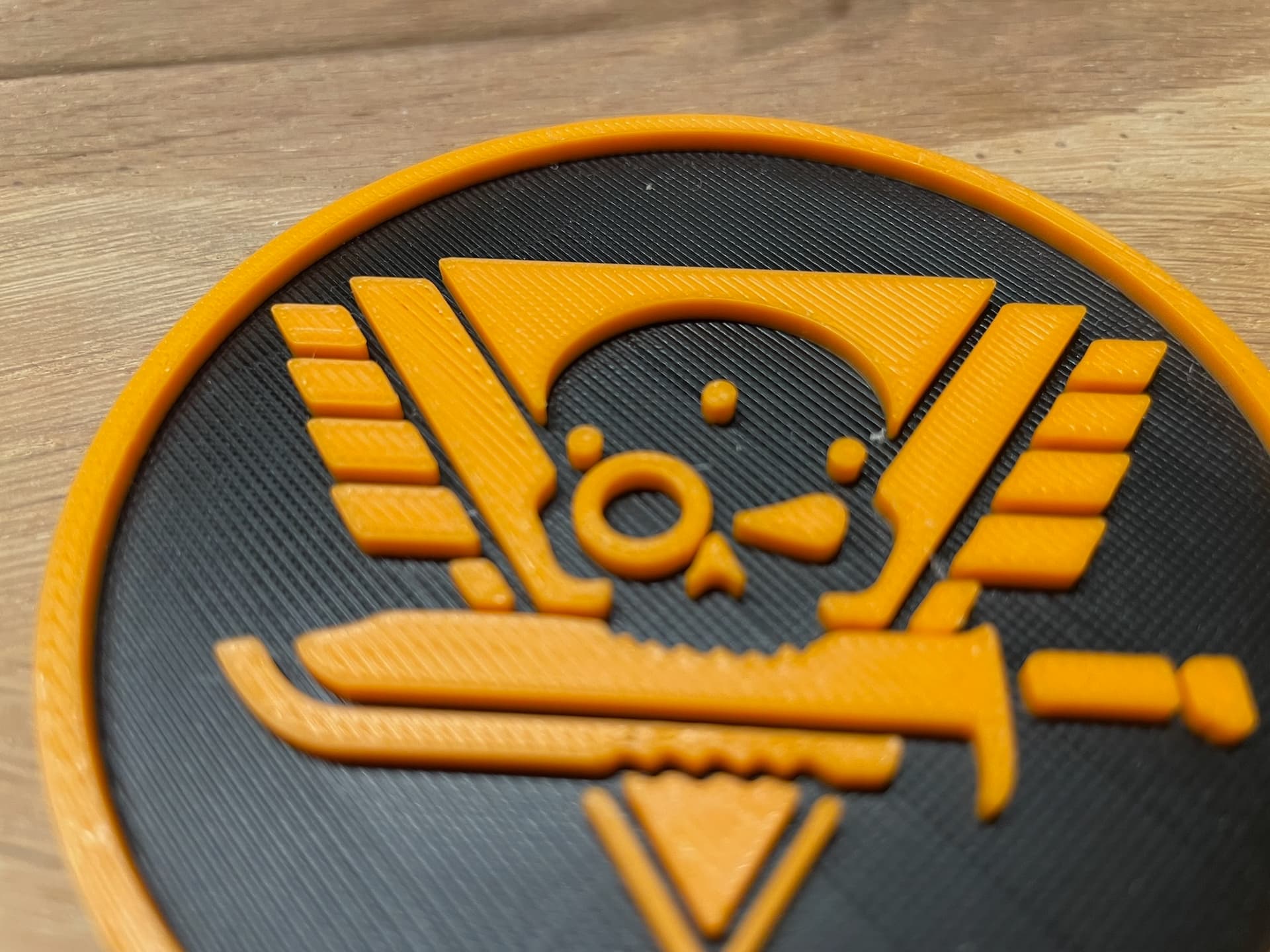

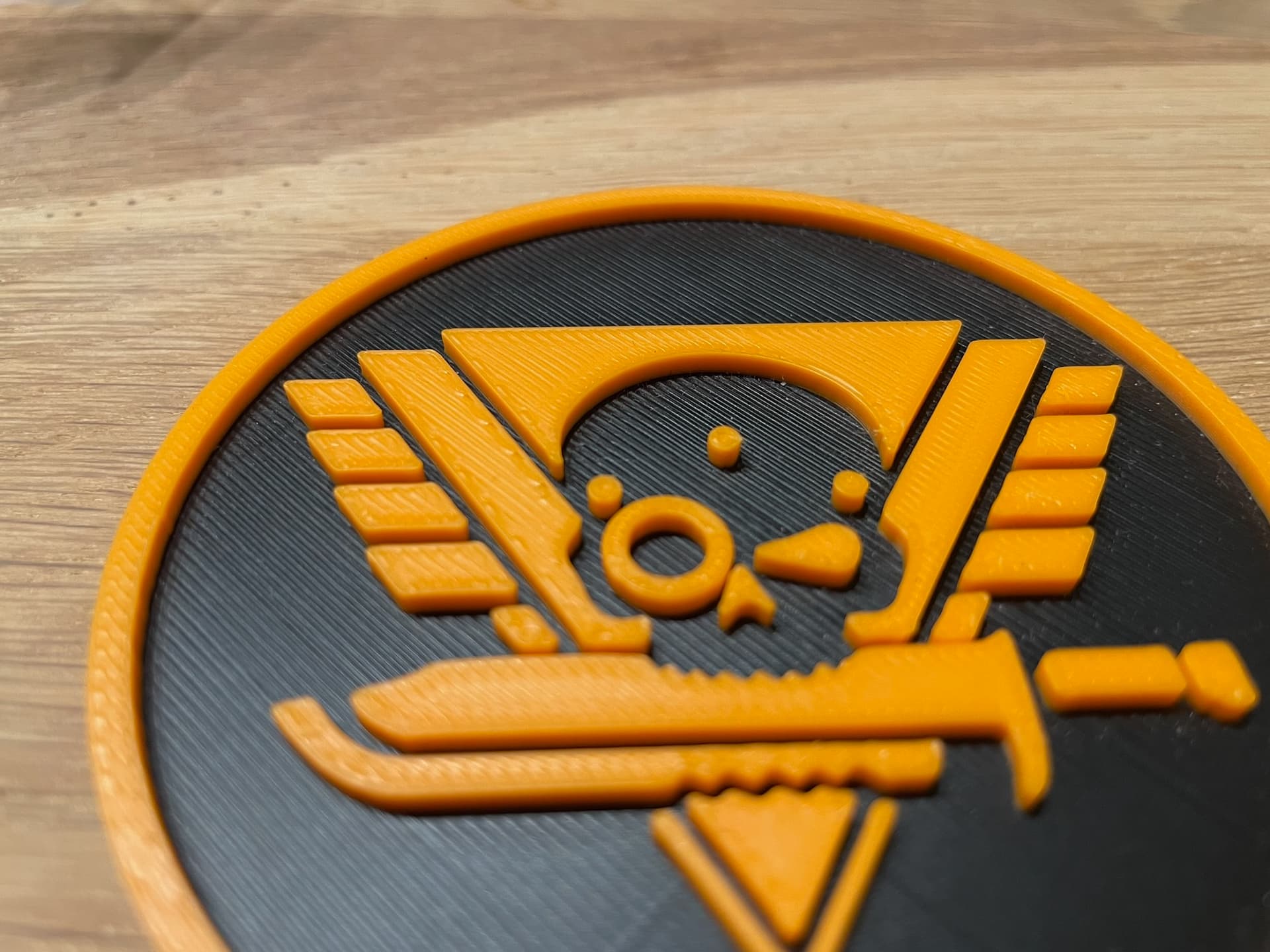

Hi there,
for a couple of weeks I’ve been noticing a degradation in top layer quality in prints with my P2S. It looks like under extrusion. I think it is happening across all colors of PLA Basic. Probably with other materials too, but I don’t have enough prints to make a comparison there. There are currently 840 operating hours on the machine, I have had the machine since it came out in October of last year.
I tried doing a flow rate calibration with Bambu Studio which gives me something about 1.02. But I have the strong impression that printing with a flow rate of 1.02 gives me over extrusion in other parts of prints.
The Bambu wiki says a flow rate of more than 1 hints toward a clogged extruder or nozzle.I’ve already taken the extruder apart, looked pretty clean to me. Also tried a new 0.4 nozzle which didn’t change anything.
I also noticed that the most problematic areas stay the same when printing the same object twice.
I did clean and lubricate the axes a couple of times.
Other things I’ve tried:
  • tightening the belts
  • firmware downgrade to 01.01.00.00
  • replacing the PTFE tubes in the printer, from the buffer to the printer and from the AMS to the buffer. Looked like it improved things on one small test print but I’m not 100% sure.
  • drying the filament
I’m running out of ideas - I’m thinking about replacing the PTFE tubes in the AMS and replacing the extruder gears. But feeding filament from a new AMS HT I’ve got since last week doesn’t change anything, so I doubt it’s the tubes.
Attached are two pictures, the bottom one is of a print I did when the printer was pretty new, the other one from today. I’m doing another print now with a flow rate of 1.02.

So I printed the model shown on the pictures I posted again with a flow rate of 1.02, and the worst areas still show under extrusion, while areas where the problems are less prominent improved.
I don’t know if som settings changed in Bambu Studio or the configuration packages, but I can’t seem to get the initial quality back.
Might have to take some proper pictures tomorrow, the phone camera doesn’t quite cut it, but it’s pretty obvious with the naked eye.
