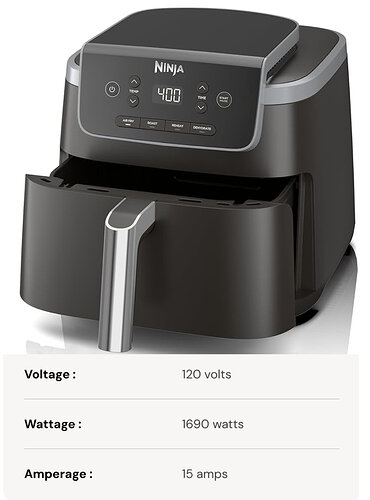

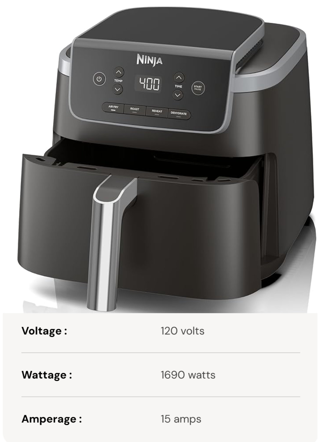

Apart from the comment: Just to give a comparison to get a feel for the wattage. A modern gaming PC also needs 1,000W - or for reference, an air fryer needs 1,750W. Both are 110V - 120V for US market. However, as with the Bambu printer, this varies depending on the situation and mode.
Before anyone misunderstands: No, I am not opposed to a power-saving mode; it is simply intended to provide a sense of the wattage.
