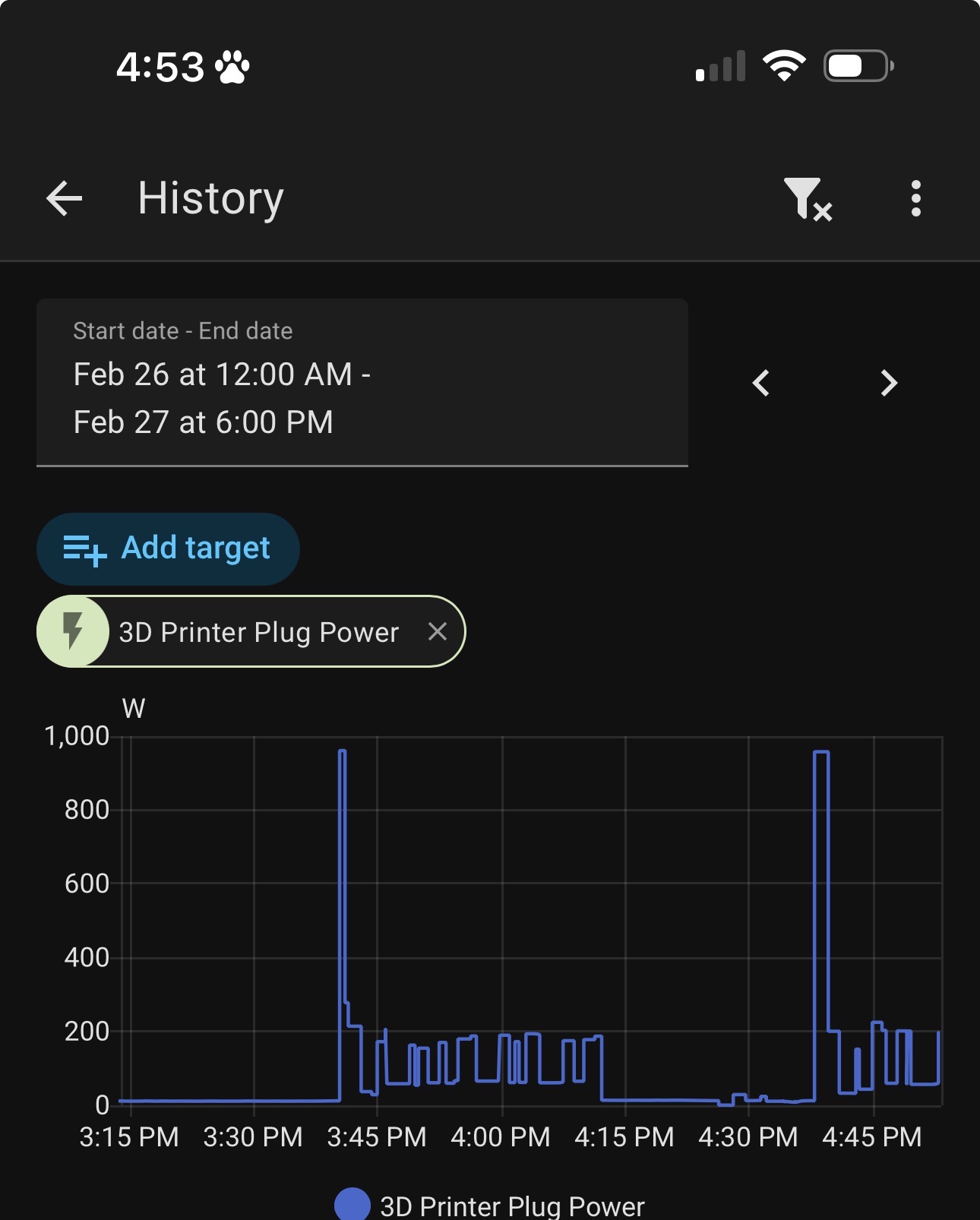

Unfortunately, in most homes you have what you have. I had 2 extra 20 amp circuits pulled into my shop when I built it, but my 3D printer is on the other side of the room and there is no way to switch things around. With the P1S this wasn’t an issue, but in case anyone is wondering, the most recent P2S firmware update didn’t change anything as the below image shows. The spikes you see are two back to back prints, before and after the firmware update.
I did finally bite the bullet and spent another 240.00 for a 1000W UPS and tested that today with no more screaming UPS errors when the printer initiates. That’s a good thing.
I still hope BL does something about that 8 second spike so I can get a second printer on that circuit. Bambu, are you listening?
They may not be able to do much, it’s a line level heater and even if it pulses on and off it’s a high resistive load. Staggering start times will help reduce constant load, but I personally would never trust that because workflows and automations can surprise you.
Not sure what the resolution is on your outlet in HA but it does aggregate data. Live monitoring in emporia vue 32 circuit monitor surprised me when I started some ASA prints on an H2D as it was showing the load higher longer than HA reported.
