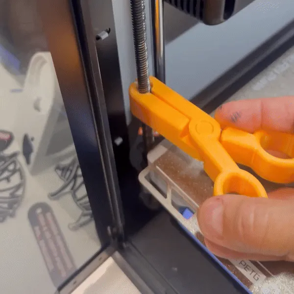

Maybe this will help.
well.. the ones in the front are fine, its the bar in the back. Its off to the right of the rear wall of the printer you can’t even really see it. The rear lead screw is good enough I guess.
I’ve printed a ton of those tools lol

I tried a few 3D-printed tools for cleaning screws; the Rod Sloth is the one I use most. It reaches into the Z-screw opening and cleans the screw pretty easily. I tear a paper towel into squares of about 60mm, and clamp a square to the screw with the tool. Run the bed (and the tool) up and down a few times. Do not hold the tool; just let it ride the screw up and down, and go slowly near the end of travel. Replace the squares as they get dirty and repeat until they come away clean. If you have three tools, you can save time by cleaning all the screws at once.
