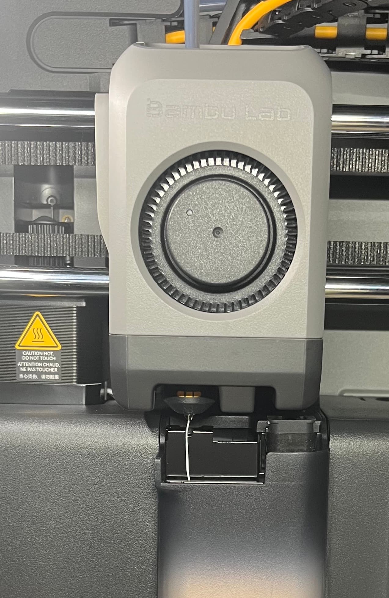

Hi there!
I’m new here, and have had a p2s for a few weeks.
My concern is that either the wiper or end gcode doesn’t seem to work properly. When starting a print, the leftover filament on the nozzle can somethimes be flung onto the plate.
I guessed that adding a run through the wiper in the end gcode will wipe it, although I may be wrong
I’m worried that either the bed leveling will get confused or it will cling to the nozzle and cause a blob. Is there any way to fix this? Either by editing the start/end gcode or some other way.
There’s also a chance that I’m paranoid.
Thanks!

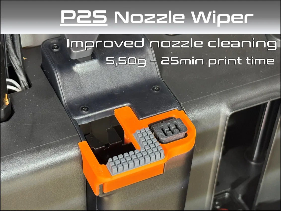

First thing I would suggest is a nozzle wiper,
This is the best so far for P2S, but it does hit the bed for some users, me being one of them, so I sliced off a mm to fix the issue for me, then you need a GCODE to add extra wipes, I just need to figure out the X and Y position to make my printer wipe every 20 layers.
Would be easy to get the printer to wipe at the end of print, as there is a section in the machine settings for GCODE
I’m using the nozzle wiper mentioned above. Works for me.

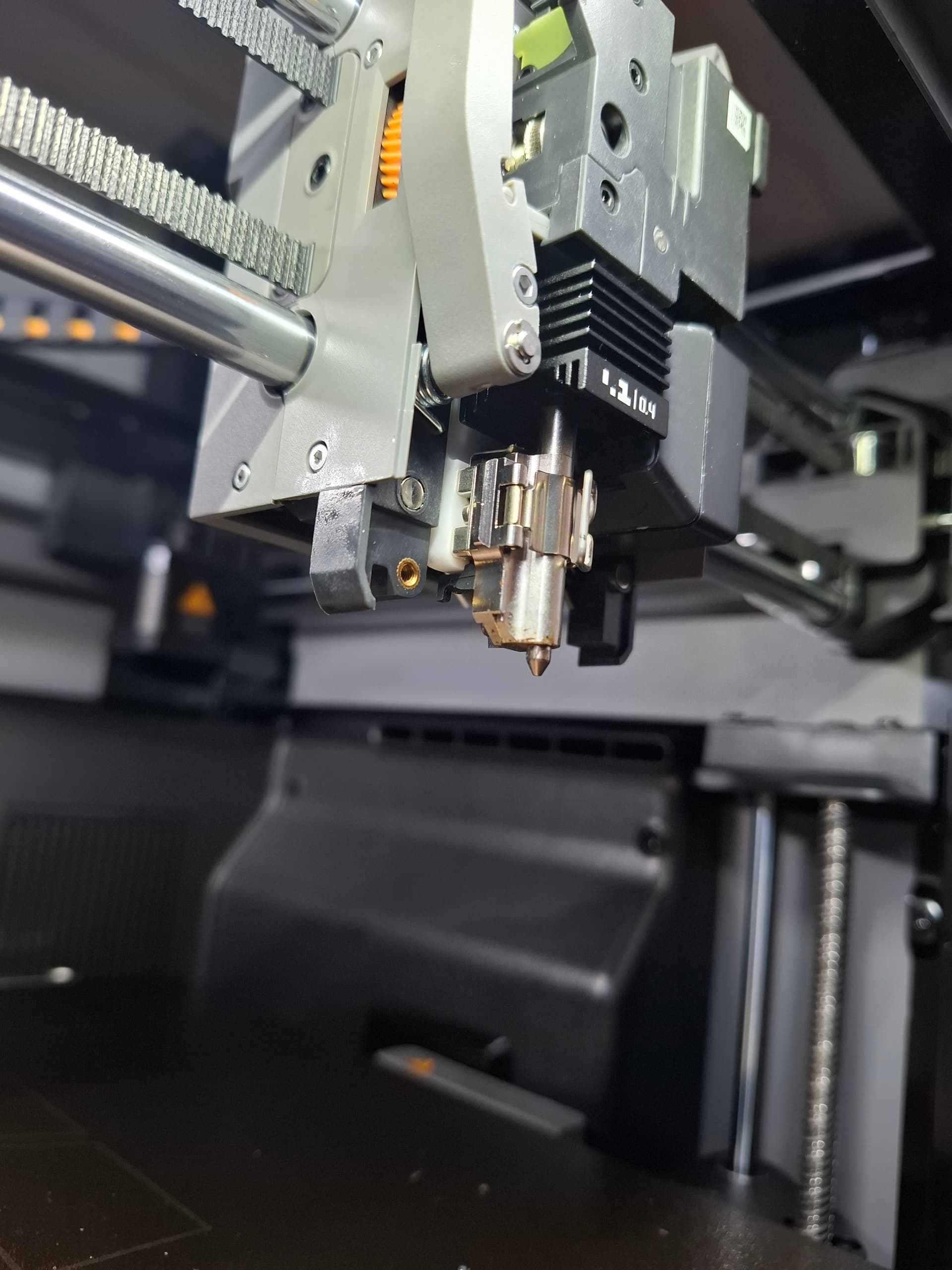

However im seeing another issue. I’m getting a lot of filament buildup under the silicone sock. When the hotend is cold, i cant even remove the nozzle. Theres always filament seeping between the nozzle and heating assembly. every 20 hours i have to clean it. Anyone else having this issue?
Funny you should mention that, as I was about to post this. After a lot of experimenting I have come to the conclusion the nozzle clumping is the cause of all my PETG printing issues,
The extra filament you mention builds up around the outside of the nozzle, eventually it gets to a size where it interferes with the prints, causing a scraping effect, worst on first layers as it has nothing to adhere too.
So, fixes,
  1. solve the nozzle clumping issue, perhaps reduce flow rate
  2. add extra wipes to every 20 layer or so.
BTW, to clean this, set your nozzle temp to 300 degrees C, carefully wipe the nozzle yourself with a thick layer of kitchen roll.,

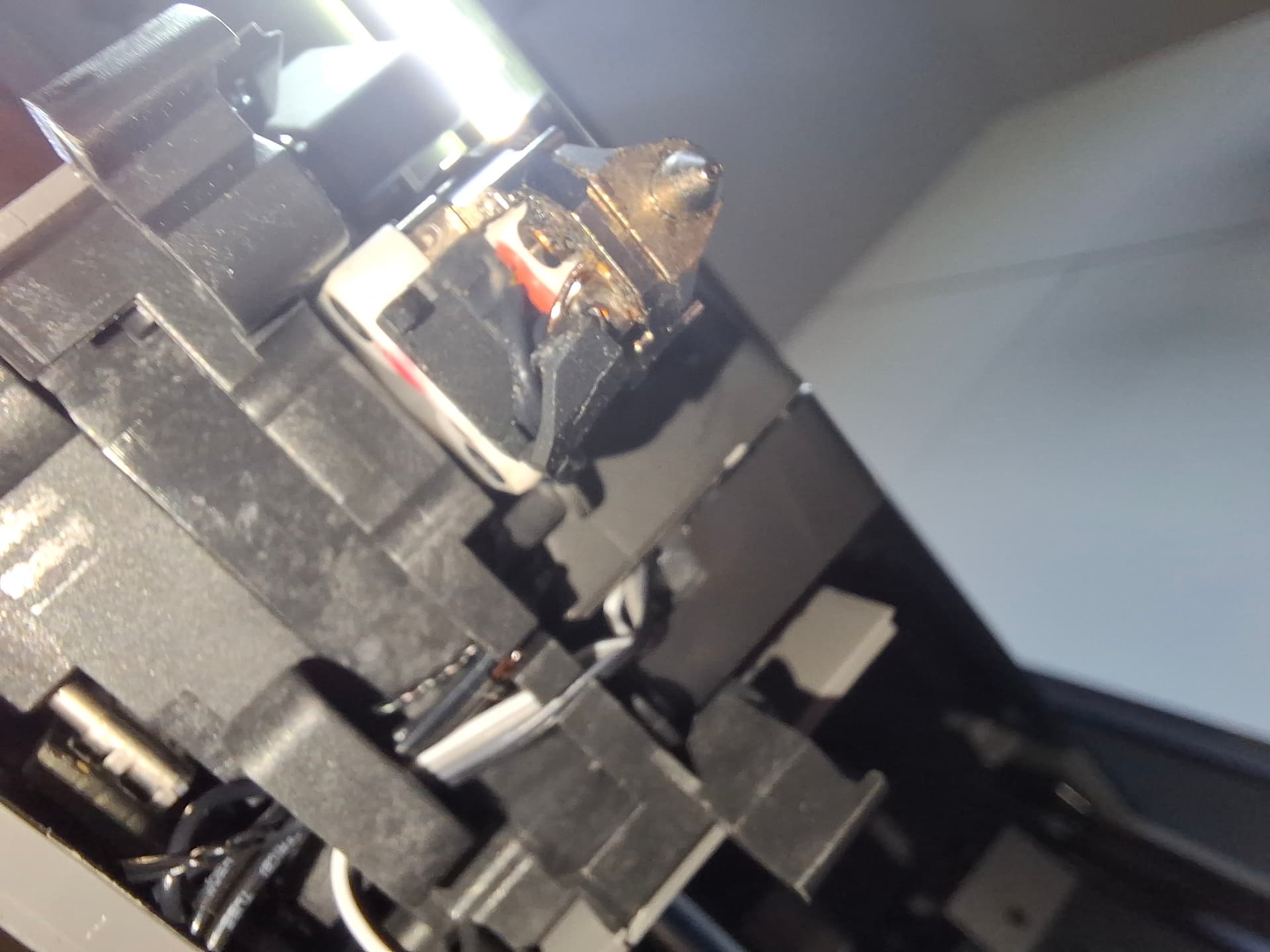

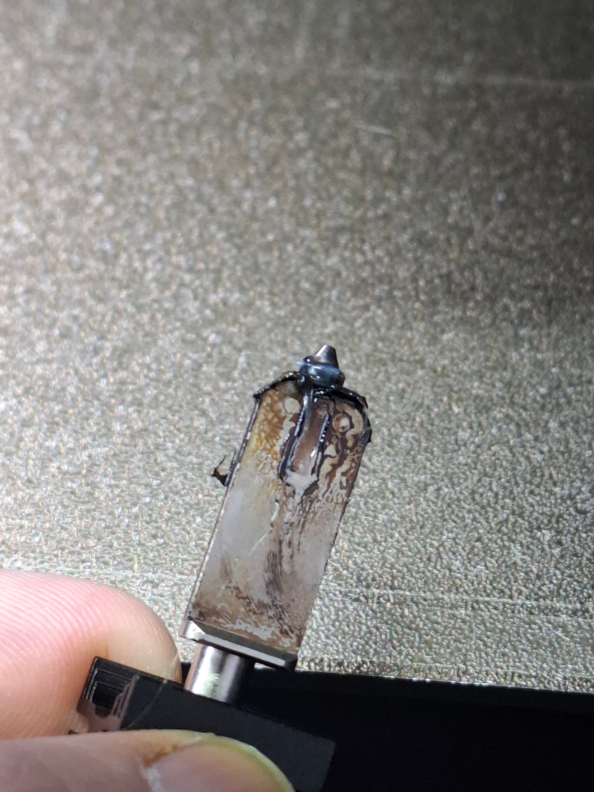

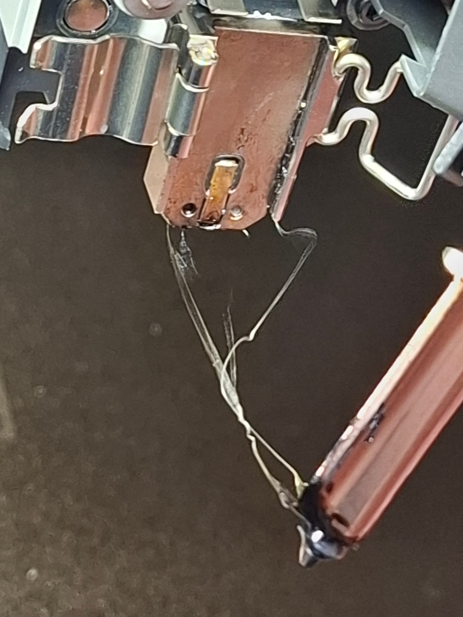

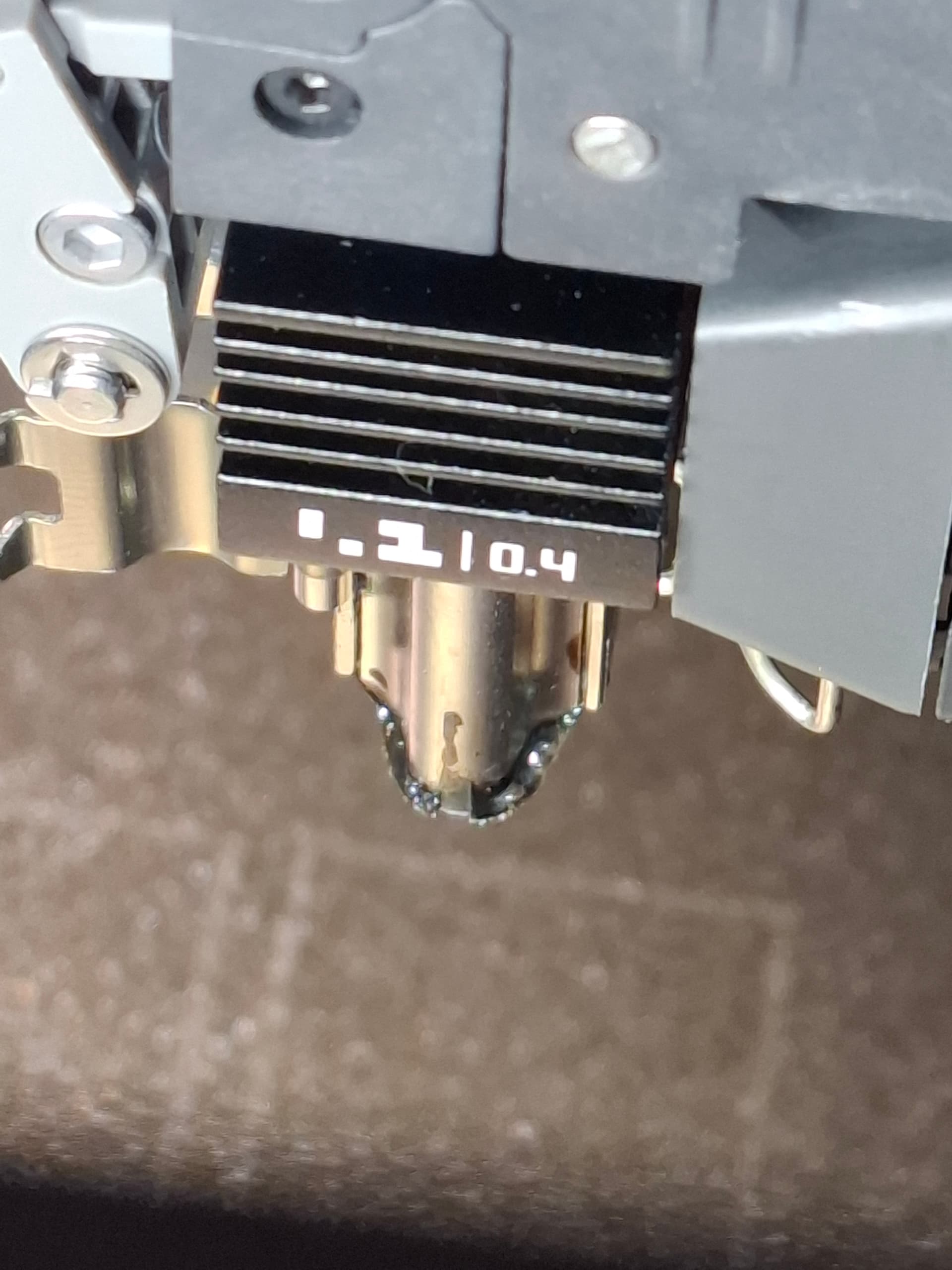

About the wiper:
Just had a 10 hour print, PETG with PLA interface for support.
~60 filament changes.
This is what my nozzle looks like after…
Theres resedue around the tip, behind the nozzle, even behind the heating element:

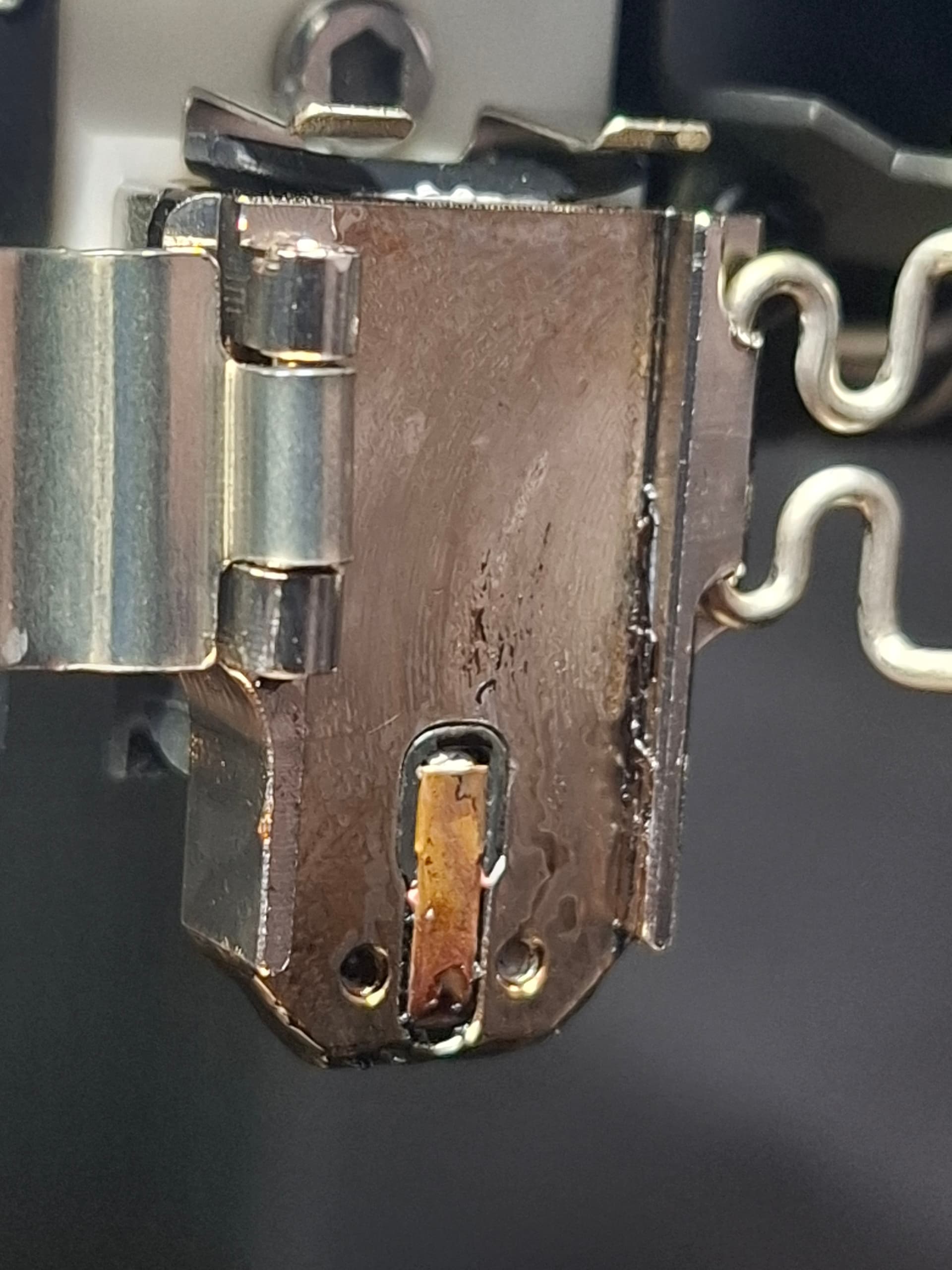

And yes, the nozzle does sit correctly and the clamp closes as intended:

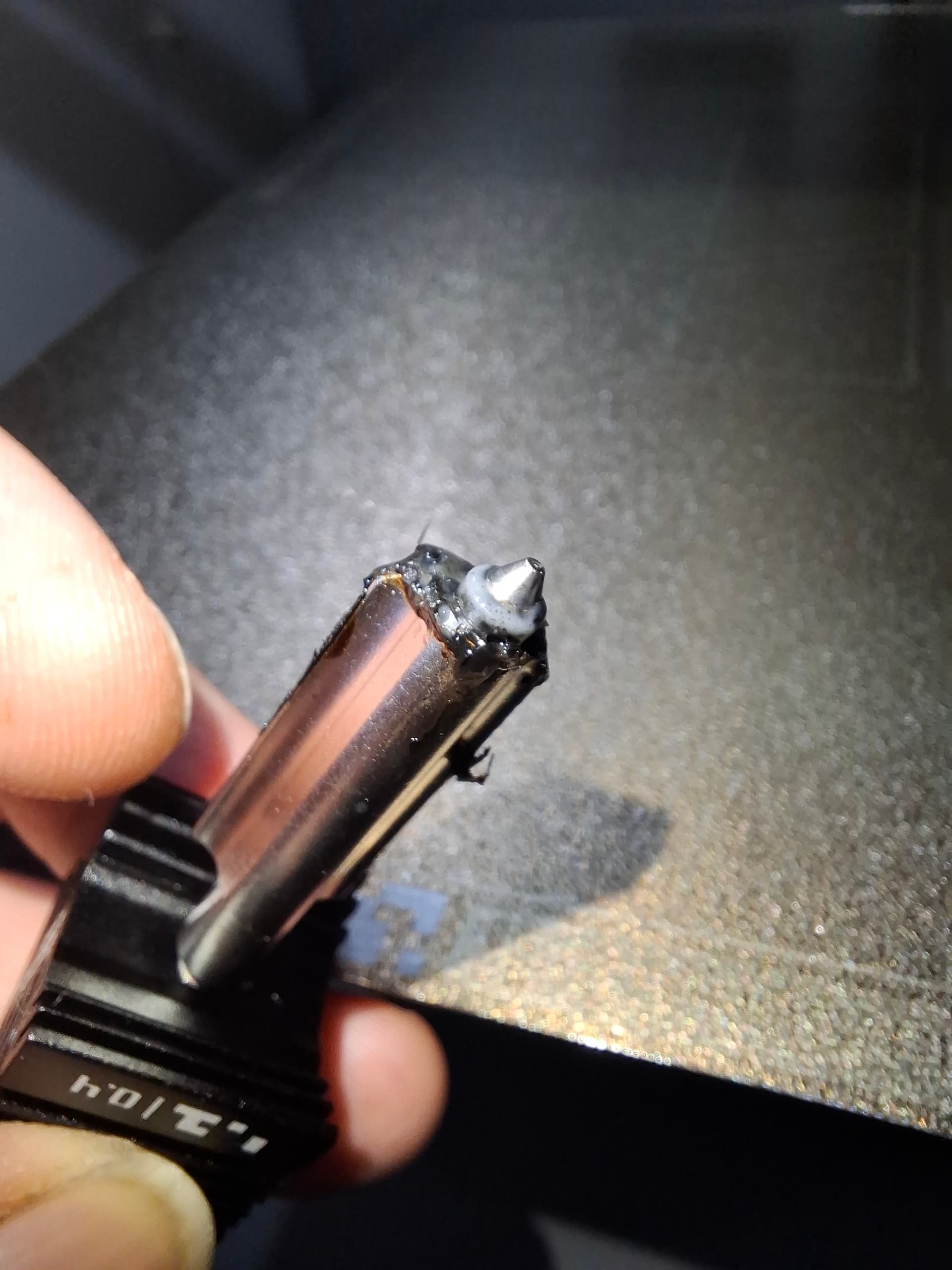

Anyone else having this amount problems? I cant even remove the nozzle without preheating to loosen things up. I have never experienced something like this on my A1.
My nozzle looks the same, with some filament attached to the base where it doesn’t belong. But I cannot get my nozzle off so don’t know what the backside looks like. :smiley: (help)
I think the wiper sometimes pushes filament upwards instead of collecting it.
For me it helped to heat the nozzle to 250, wait a minute, then back to 80.
Once it reached back down to 80 i use some papertowel to grab and pull the nozzle. :smiley:
Then i used a scalpel while still warm zu clean the hotend and heater.
