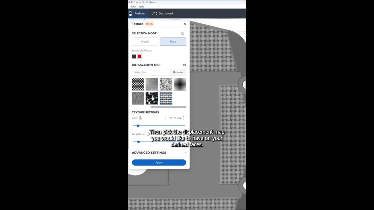

I’d be very interested in this feature, or even better. The example of the textures of IdeaMaker and Formlabs, where you can apply textures directly into the slicer.
