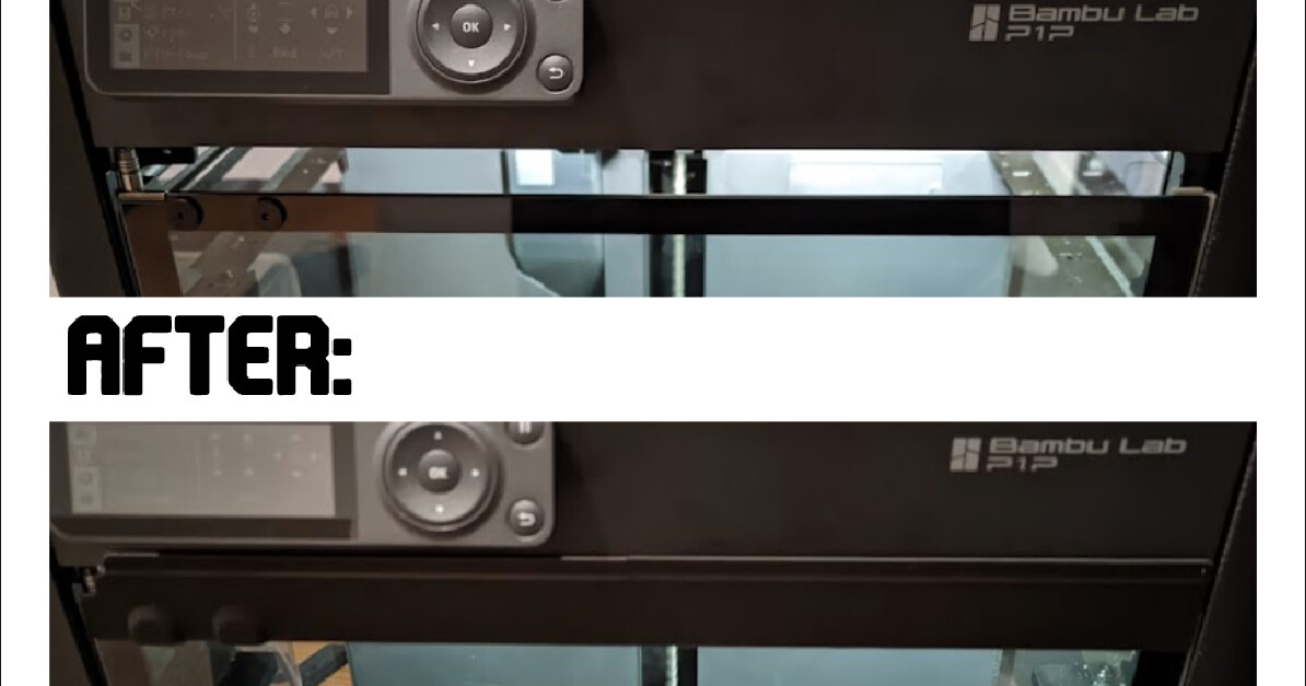

  1. The front bezel of the P1P is about 5mm too short. The P1S bezel covers this gap but the alternative is to use this printable glass-mounted door gap cover
This is what mine looked like before I upgraded to a P1S bezel.
https://us.store.bambulab.com/collections/bundles-kits-p1-series/products/front-cover-p1s

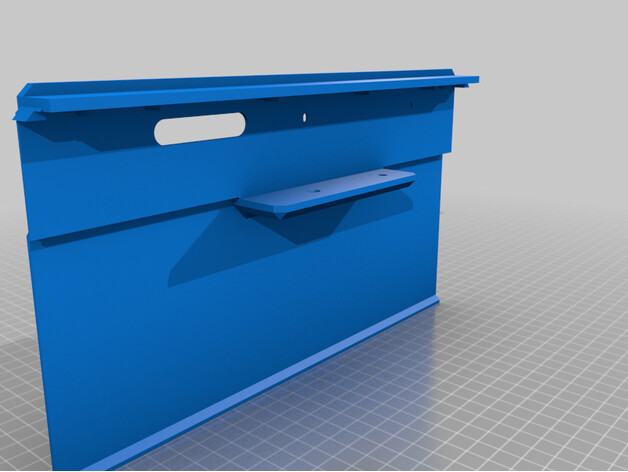

  1. The rear P1S panel kit will replace the P1P sheet metal entirely thus making for more flexible venting options such as an external fan as well as covering the entire back panel opening.
However, you can get away with printing the back panel extender which will cover the gap:
https://us.store.bambulab.com/collections/bundles-kits-p1-series/products/rear-metal-panel-p1s
