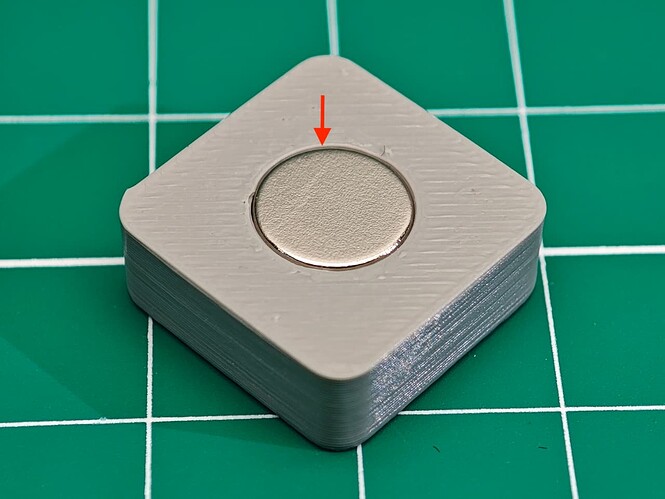

However, in practice, it is common to experience the magnet surface not being flush with the cavity surface. What does this look like? What impact does an unflush installation cause? Let us take a look at it together.
There are mainly two types of unflush installations.
  1. If the magnet surface is raised above the magnet cavity surface, a gap will form between the mating parts. Such a gap will impact the appearance of the print. It may also cause magnets to collide with each other, causing damage. (see the image below)
  2. If the magnet surface is recessed too deeply below the magnet cavity surface, a gap will form between the magnets. Such a gap weakens the magnetic attraction. Consequently, the mating parts do not fit tightly, which affects their performance. In such cases, we can see unflushed surfaces on the connecting surface of the parts. (see the image below)

1.Use magnets designed with negative tolerances
All manufactured objects have tolerances. It means that actual dimensions may differ slightly from the design specifications. Magnets designed with negative tolerances will not exceed the design specifications. But they might be a bit smaller. Materials cool down and shrink during the FDM print process. It results in the dimensions of the magnet cavity being slightly smaller than the design. So, parts designed with negative tolerances are better suited for 3D printing. This helps achieve a precise fit. The image below shows the assembled model using magnets designed with negative tolerances. As such, we recommend using magnets designed with the negative tolerance from Maker’s Supply to boost your print quality. The magnets provided by Maker’s Supply offer the following benefits.
  • Globally standardised specifications: This ensures users and creators receive parts with consistent dimensions, preventing compatibility issues.
  • Strict tolerance control: Using negative tolerance to manage material shrinkage in FDM printing. It ensures the installation surface is flush.
  • Moderate magnetic strength: Offers an optimal magnetic strength for easy use. It helps avoid problems during disassembly and reduces the risk of impact-related damage.
Usually, when using magnets provided by Maker’s Supply, we suggest the following socket dimensions: the magnet socket diameter should be the magnet’s diameter plus 0.2 mm, and the socket depth should match the magnet’s thickness. For easier and secure installation, please consider applying the methods described in the article ‘Ways to Optimise a Magnet Socket’.
