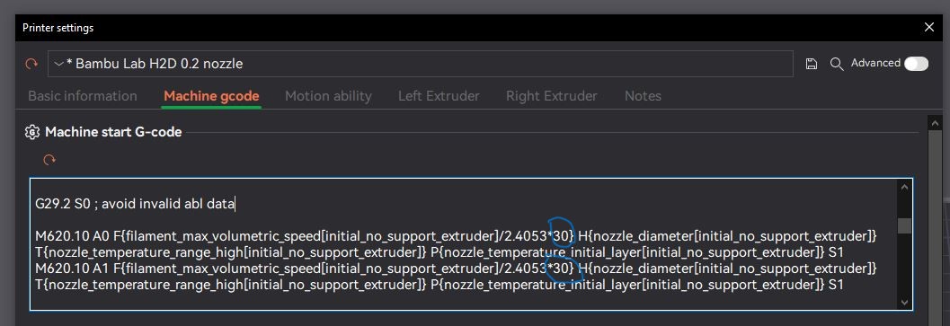

One thing to check, especially if this is an old file from X1C days or such, is that the PLA filament’s long retraction is off. Default is off now for 0.2 H2D for a clean project.

The H2D purge settings are extremely aggressive.
I don’t have 0.2 nozzles - try reducing the purge speed to 30 and see what happens.

Error is gone after switching to the Beta-Version. They did major improvements.
