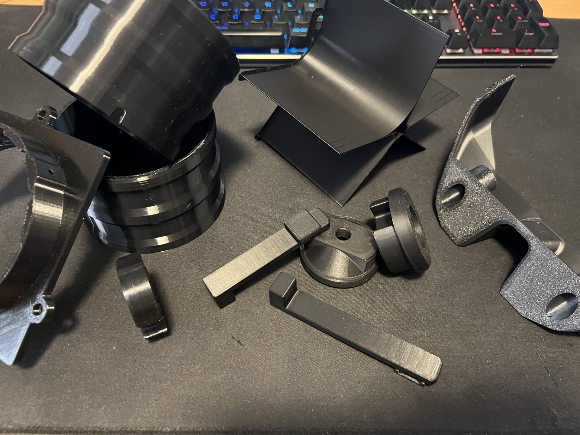

Here are some parts I’ve printed with Extrudr XPETG Matte black or anthracite.
I love this filament. :slight_smile:
The only time I. Have had stringing was when the filament wasn’t dried properly.
Could you please share your settings for the XPETG? I am printing extrudr PETG only, and have perfect results, but my tests with the XPETG didn’t work well at all - it was a pain to use, not only on the x1c, also on my other printers. I must have missed something.

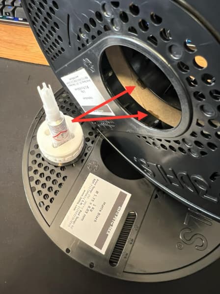

I do have to say though… most of the spools arrived with bad vacuum, humidity and in addition to that - you need to glue the spools as 2 have already opened on me. One by just handling it and another one inside the AMS (their plastic sides don’t stick well on the cardboard center).
Here is how I solved the falling apart.

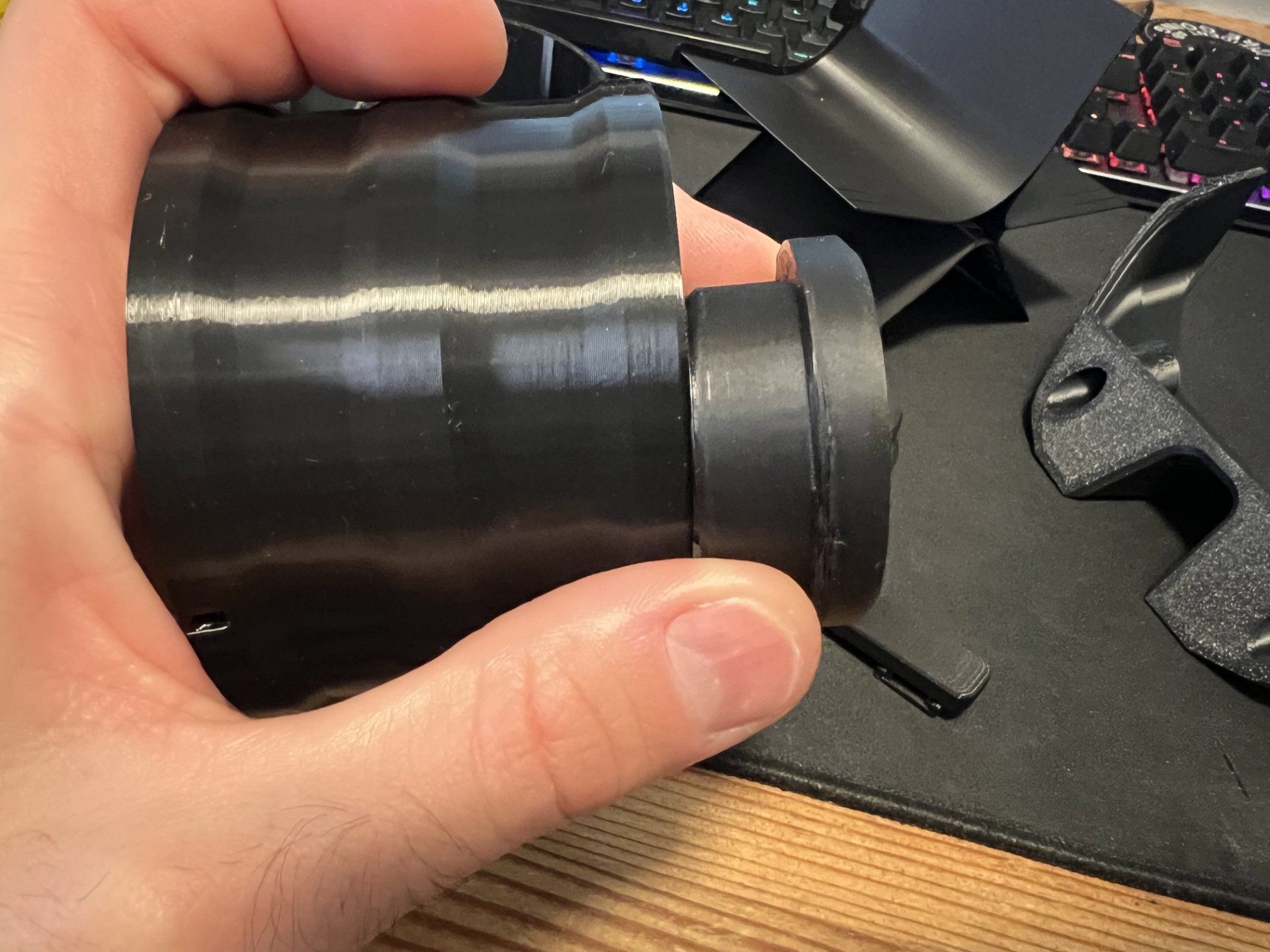

Sure.
Not the best comparison pictures, but from the reflections I think its pretty easy to tell which is normal and which is the matte PETG:
Here a more easier to see difference:
Hope this helps :slight_smile:
Thanks! That is a huge difference indeed! Thank you :slight_smile:
