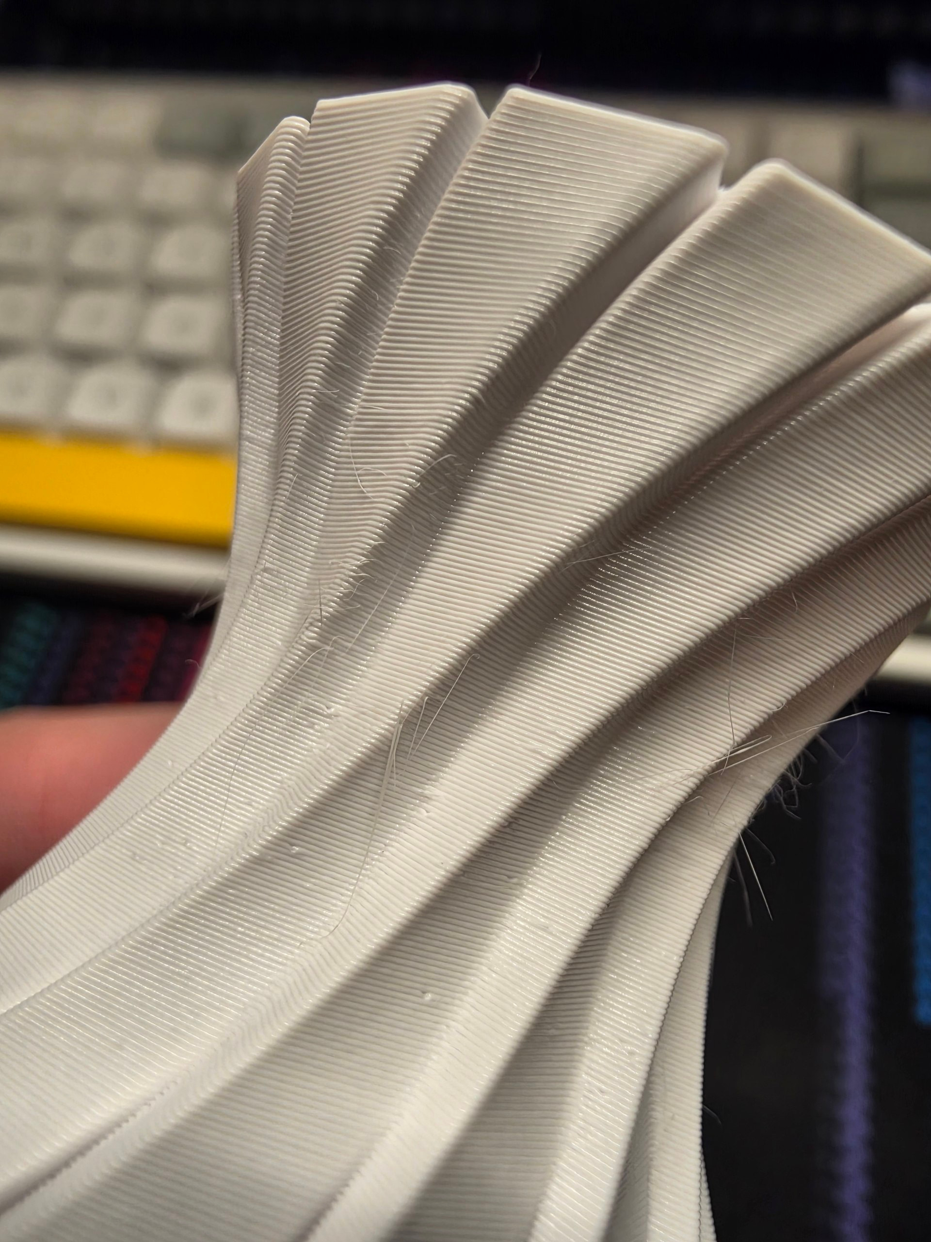

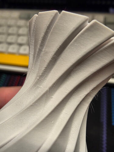

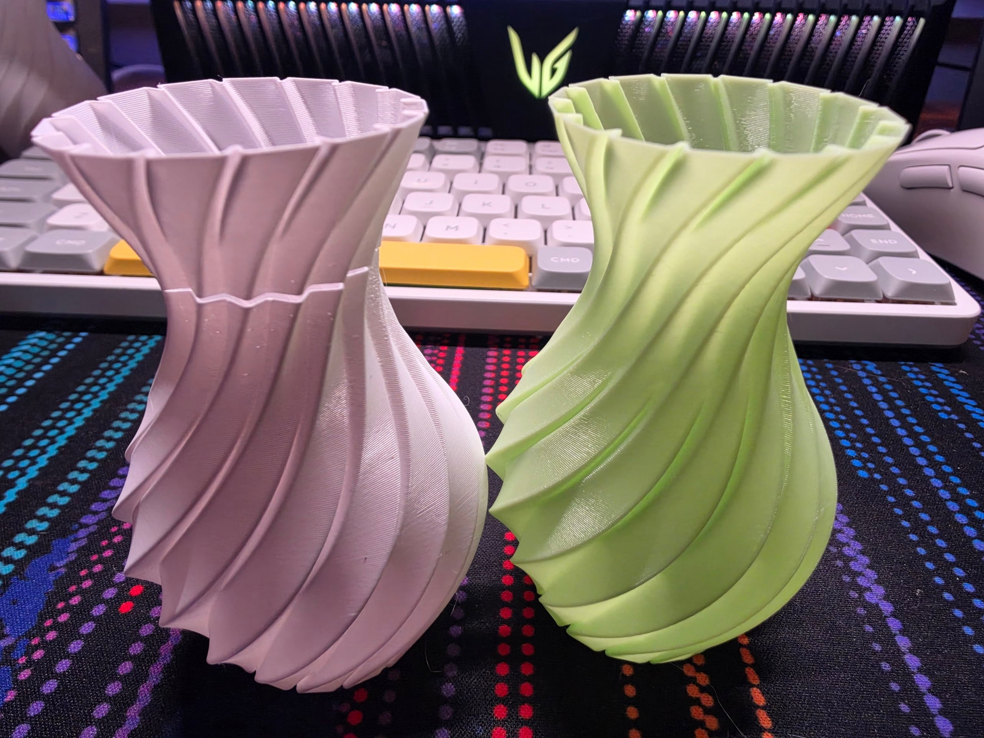

Well… Seems like something is off with the white spool. Either it’s still wet (possible), maybe a bad batch, or a bad color selection.
Full overnight drying is in progress…

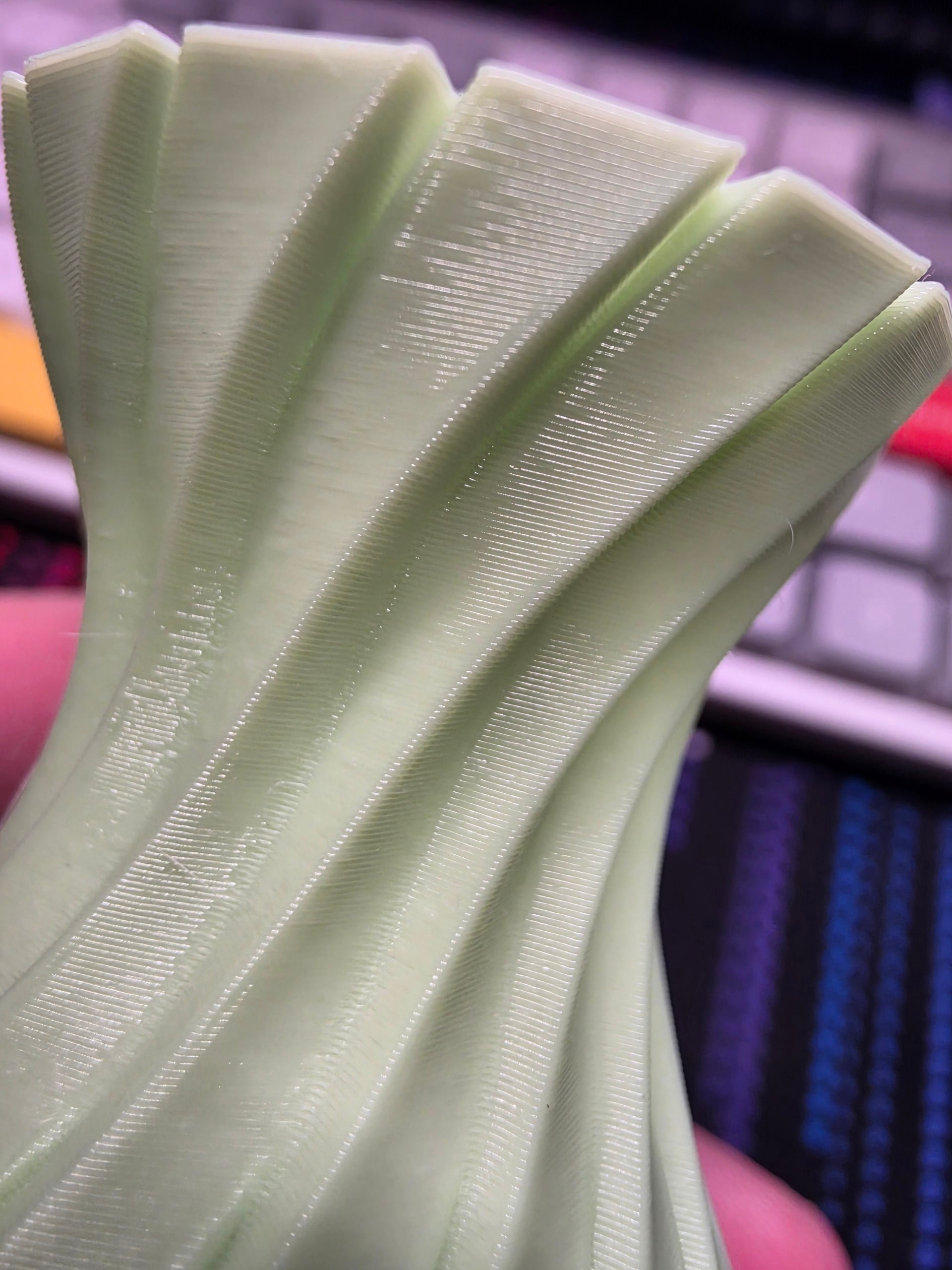

In comparison to Advocado color, it still have zits, quite a bit of the hair and overall surface quality is subpar. Avocado green, on the other hand, looks great. No surface issues.
Again, both filaments were opened up at the same time, dried for identical amount of time in Space Pi 4.

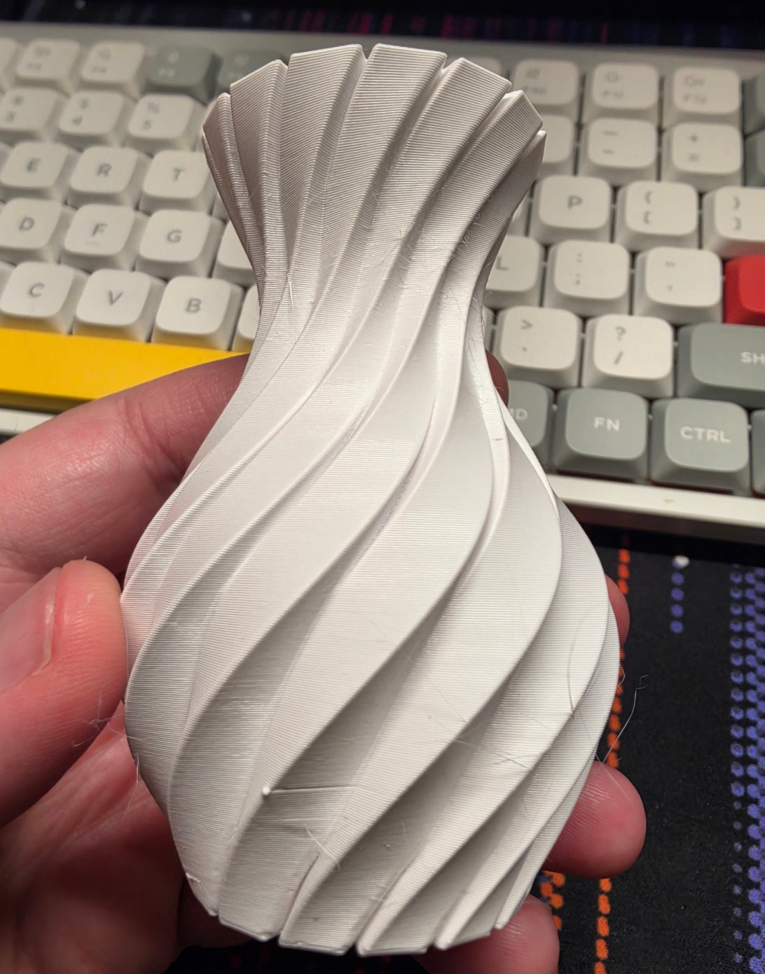

Also, I have to notice that white filament is super brittle. In comparison to a green color, it cracks under a slight press at the top of the vase, while applying the same amount of pressure on a green print is completely fine.
In a small addition, I have to point out at how white the white filament is.

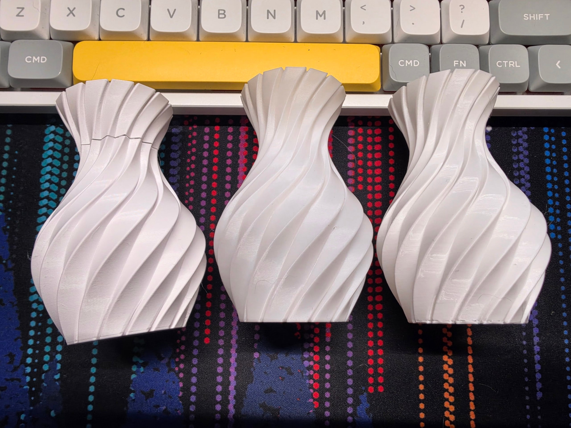

From left to right:
  • Bambu Lab PETG Matte
  • Inslogic PETG Pro (semi gloss)
  • Prusament Signal White (glossy)
Bambu’s matte white filament is somehow brighter than a full gloss PETG from Prusa. For me it tells that it’s likely have a high percentage of titanium dioxide color additive that makes it much weaker than the other.

That Matte White def looks wrong. Mine printed in similar quality to Avocado and seemed the same when handled (tho not a vase)
