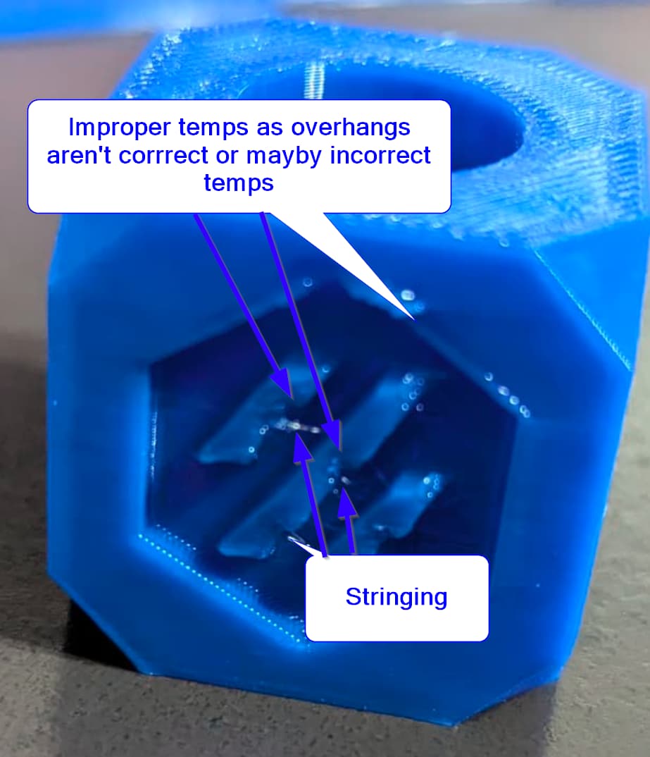

I don’t want to pile on until you get the new extruder in place because there are too many issues which may be fixed with the new extruder and lets hope that’s all there is. But to cite just two of the cube faces and areas he needs to focus on once he gets his machine back into shape are here:
Contrast that with this PETG cube I showed above.
And please note that even that shape is not perfect. I tried to capture an angle and lighting in this photo to show the banding I have not been able to calibrate out.
The point here is that it is that calibration in my experience is a compromise. I’ve never been able to achieve absolute perfection on every aspect. The grey cube BTW is Bambu’s new PETG-HF, admittedly one of their best filaments I’ve used and I think I’ve gone on record enough times stating how inferior I consider their other filaments. The PETG-HF is a winner.
Pick the sample with the largest, smoothest, central section. The edges and borders do not matter for these flow calibrations - that is mainly corrected by adjusting pressure advance (aka K value or dynamic flow).

Well, yes, that would be the logical choice. If your temperature is too far off then it will affect your calibrations. Some of the items seen in this areas as an example can be attributed to incorrect temps.
I tried various iterations… lowering the temperature each time. Very little change in sag in overhangs. So… after chasing this down a literal rabbit hole, I reverted back to my original settings and drastically slowed the print speed, especially on overhangs. This produced an acceptable result, although not perfect.
