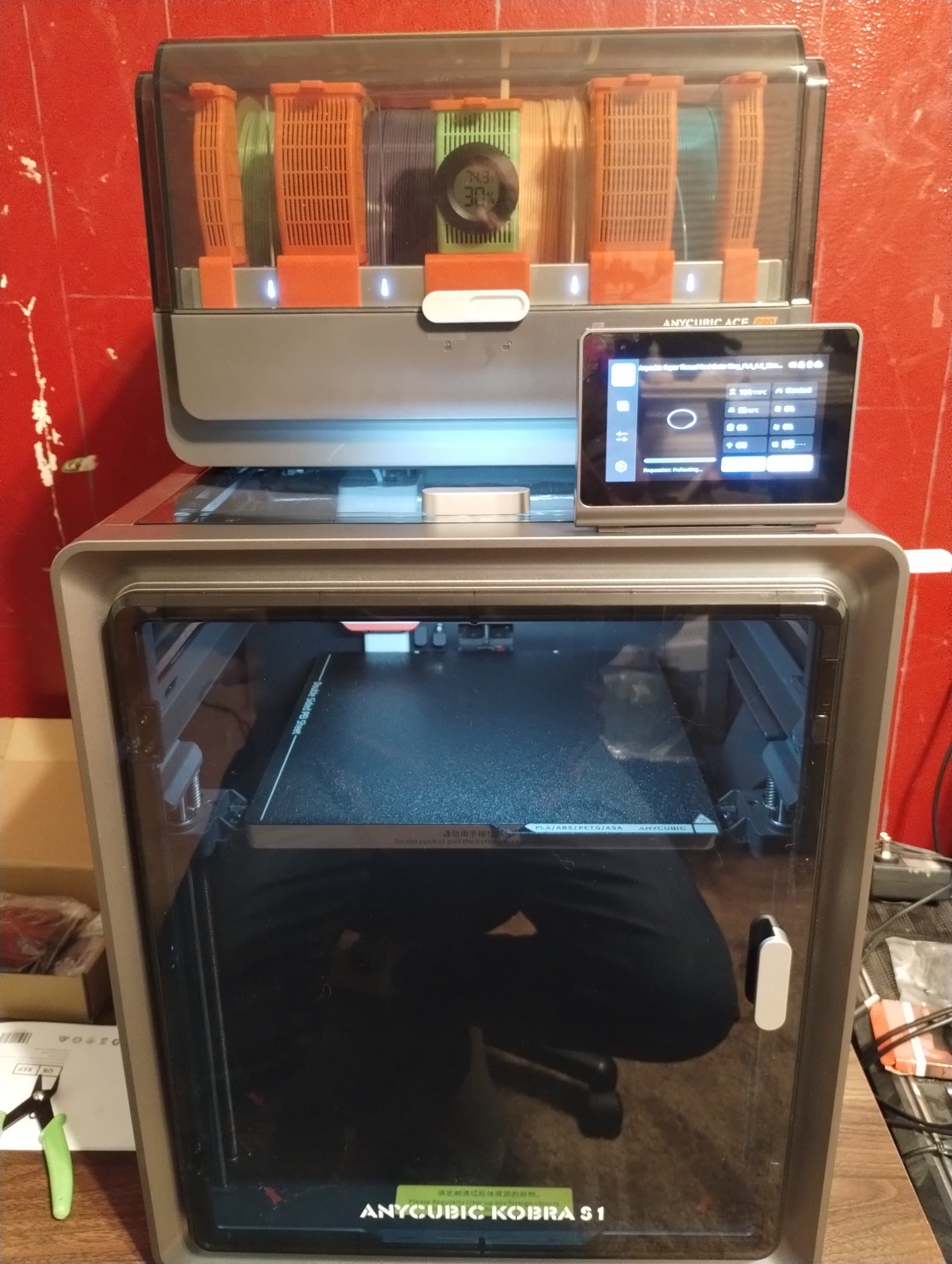

FedEx finally managed to drop off my S1’s today. Only set one up so far. It’s a nice looking printer, but build quality isn’t on the P1S level, which reflects in the price.
Running my old Ace from my old K3. Setup was straight forward, connecting to my Anycubic account. After initial calibrations, I didn’t print the obligatory benchy. In my combo deals, I took advantage of their filament discount. These were probably the worst cardboard spools I’ve received. They’re packed in individual cardboard boxes, 4 boxes taped together and shipped. Had some ‘crushed’ flat spots. On the included usb drive was the spool rings, so started printing those.
I must say, compared to my old K3, print quality is excellent, extremely happy with it. No bed adhesion issues, good first layer, printer is quieter than the k3, fans and all. It’s got a great touch screen. Bigger than what was on the K3.

Self explanatory. Benchy running on second printer. Second printer setup with included Ace. 1st printer was/is setup with the Ace from my old K3.
1st printer/old Ace loaded and read all 4 Anycubic Pantone colors. 2nd printer/new Ace read black and gray high speed PLA in slots one and two. It didn’t read the Anycubic PLA in slots 3 and 4(green and orange). No biggie, set them up on screen. Figured they were not RFID spools.
Printed great from black, gray, then orange. Went to print from green, walked away and came back to this.
It didn’t feed in the funnel below the filament sensor and came out underneath spool rollers. After clearing it out. Loaded all spools. Now it reads the orange PLA, but not the black and gray.
Swapped out the new Ace unit with the new Ace unit from printer one, all colors recognized by the unit and set accordingly.
I’ll send off a support ticket on the flakey Ace unit. After hooking it back up, now all it wants to do upon insertion of filament is roll the filament spool as if it’s winding the filament back on the spool without feeding. I can manually feed the filament with the Ace off, then turn it on and it’ll feed to printer and print fine, but doesn’t detect filament reliably. Well, it prints fine on all slots except three. It’ll feed the filament once I’ve inserted it, but upon starting a print using slot 3, gives a failure to extrude.
The benchy was printed with the 1st units new Ace from slot 3.
Found issue with the faulty Ace unit.
The top two PTFE buffers that show the screw heads should actually be turned 180°, to match the bottom two. All 4 were backwards. That’s a little magnet shown on the top two. With those upside down, the Ace tries to retract as soon as you insert filament. If the Ace is off, you can load filament past the sensor, power on and it’ll feed filament, but will give an occasional extrusion error.
Once I rotated all 4, the Ace works as it should.
