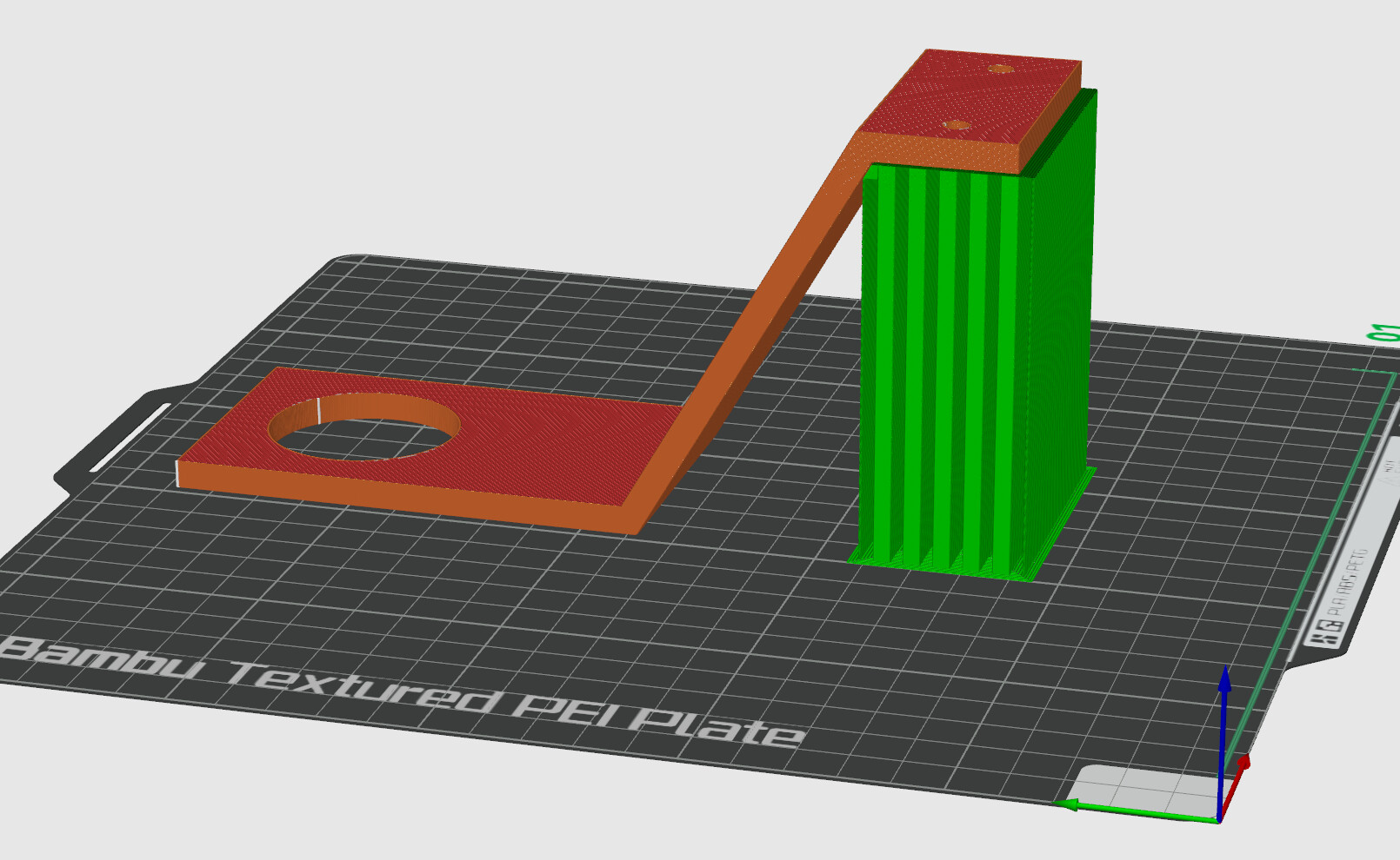

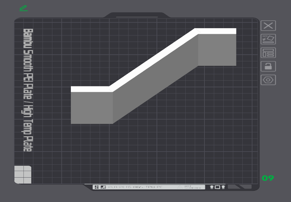

I have a very basic model I want to print with an even surface on the top which needs support. (See Picture)
Model:
I tried both tree and normal support. But either way the support is attached to the surface very strongly that I actually break the model while removing the support. I printed both model + support in Bambu PLA Basic black. I used the 0.2.mm Standard @BLL X1C profile. Support was default settings except I tried both nomal(auto) and tree(auto) as mentioned.

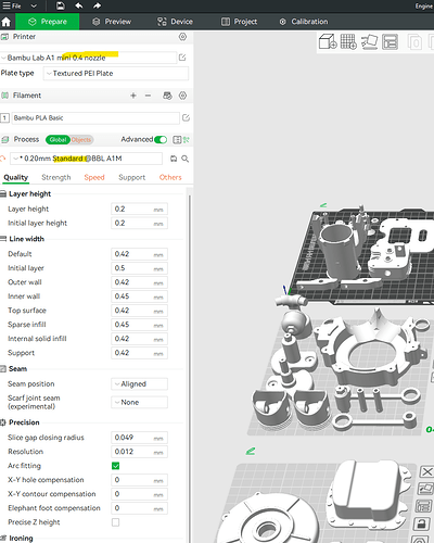

When I open the model in the studio multiple things confuse me.

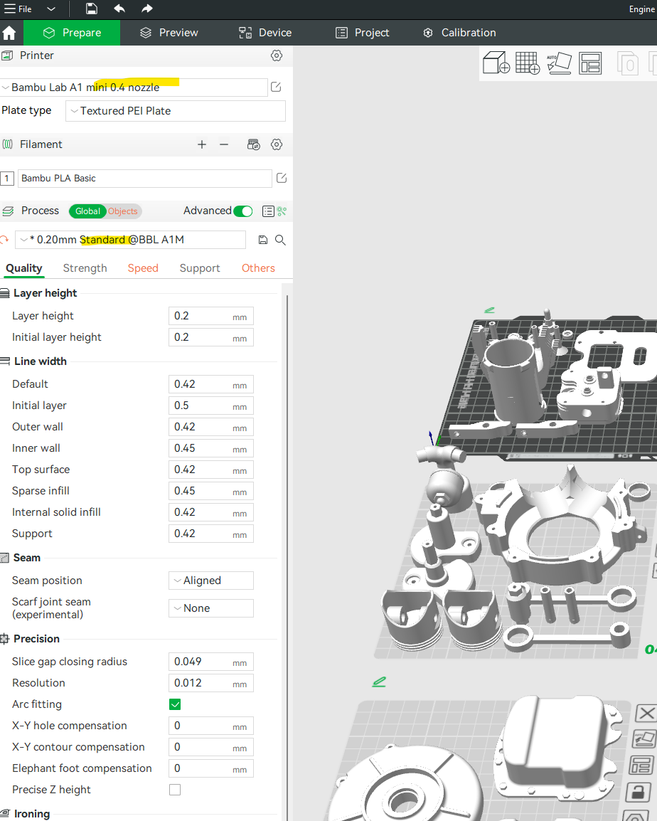

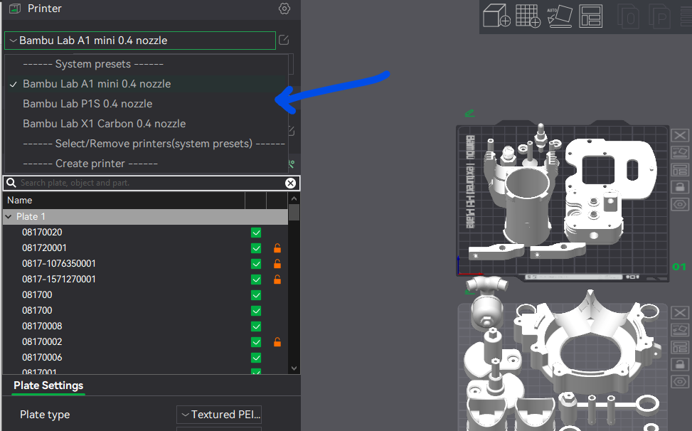

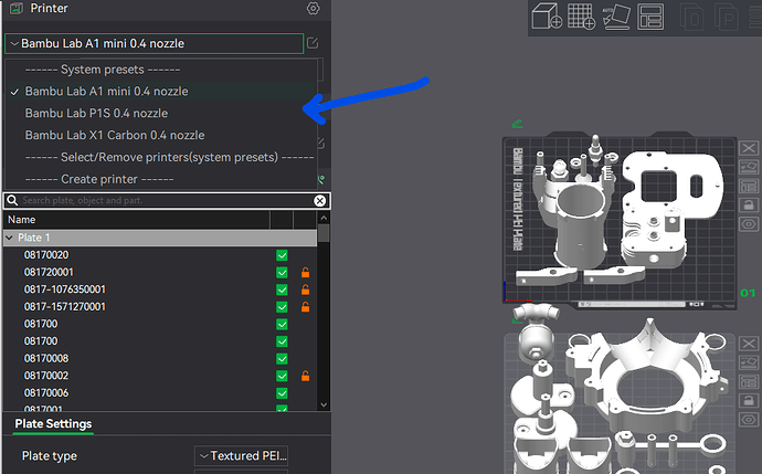

  1. It shows a different printer in the printer selection. I only have a P1S, why does it show a A1 Mini? I assume I have to change that.
  2. It shows a 0.20mm Standard @BLL A1M Process profile. Are these now the settings the designer actually used, or are these the standard settings from that profile? How can I “import” settings from an experienced designer?

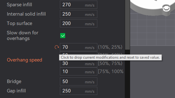

  3. Why are some settings sections orange? What does that mean?

  1. This is common, the designer has released the profile with a specific printer model attached, you need to simply select your model after opening the file
    (for all .3mf you download from makerworld).
  2. When you download a profile from a model page (.3mf) that contains the designers settings, this particular profile was designed for 0.20mm layer height. You have imported the designers settings.
  3. Orange setting means its overriden from the default, if you press the orange arrow it will reset it back to defaults.
Finally, not sure what your issue with support is, it shouldn’t be that complicated assuming default settings. Show us your Support settings for the stuck support print please.

In your case you probably don’t need to use support if you rotate the part 90 degrees and lay it on the bed. This will also strengthen the part as the weakest point is at the layer lines and you want them to be perpendicular to the load.
Yes, use the drop down to select the P1S.

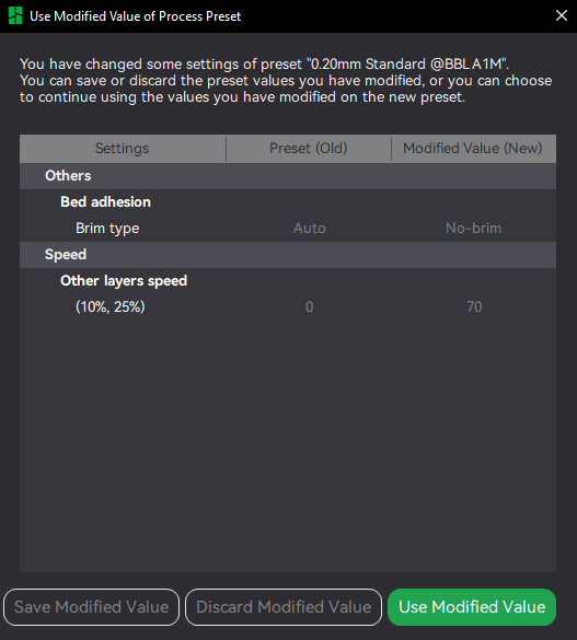

Where is a pop up when you change printers. Select the “Use Modified Values”
This means that the setting is different than the default. IE the designer/you modified it.
If you click the orange semi circle arrow thing it will revert the value back to default.
Boah Jon now I feel a bit stupid. Just lay the thing sideways on the plate. haha totallly zero experience here. but thanks for all the answers and tipps! Let’s print baby yeah! hehehe
Nothing to feel stupid over. It’s just unfamiliar and there is lots to know to get the best prints.
But Jon’s point about layers and extrusion lines is very important. It’s not just getting rid of support. It’s also a strength issue like Jon said.
Your original orientation is a bit like a stack of donuts with each donut being a layer. The adhesion between layers is lower than the strength of the extrusions that make up each layer. In your case, the completed part would be strong in the x and y axes (the donuts) and not so strong in z - the stack.
Turning the part on its side makes the extrusions run from end to end and give lots of strength to resist bending or pulling forces. There’s also lots more layer to layer area so that the overall interlayer adhesion actually goes up and the part gets stronger. The axis that becomes weak is bending along the narrow dimension but being narrow, it’s more able to resist those forces and again, interlayer bonding area is higher because the extrusion paths get way longer.
