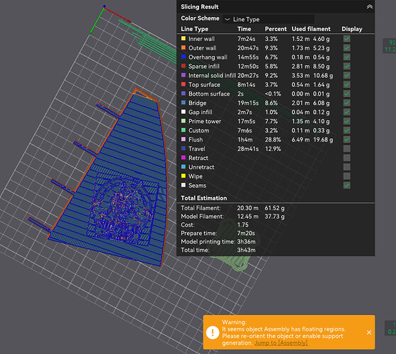

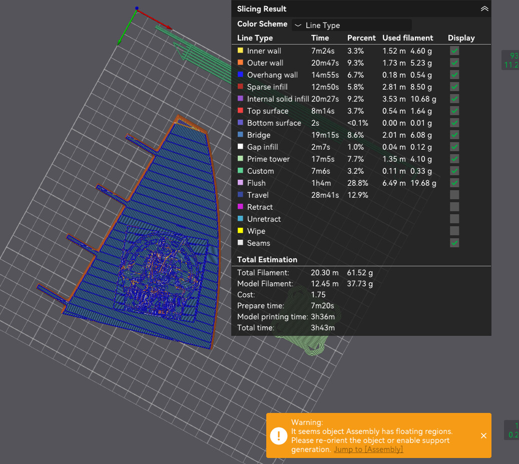

Did you ever get this resolved? I am having the same issue where import my stl logo as a part or modifier, which works perfectly to have the logo on the primary object. However when I flip my object (including the logo) to lay on the build plate the slicer keeps showing the logo not flush so it causes majority of the bottom to be floating region cases print issues. I have
tried to change the scale to reduce thickness and moving up and down. I have attached screen shots for visual. Thank you in advance for the help!

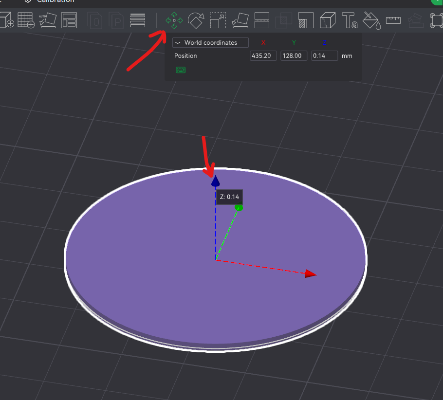

You should be able to use the “Move” tool to drop the part into the bed so the part it flush to the top of the bed.

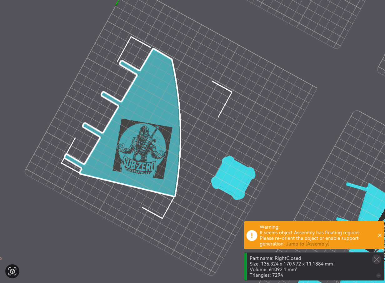

I have it moved correctly now the floating region msg is gone. My next issue is the logo uses 3 colors and are shown on the prime block but are not shown when going to print. How can I tell BS to use all 3 colors for that part of the assembly? TYIA

I have it moved correctly. Now the floating region msg is gone. My next issue is the logo uses 3 colors and are shown on the prime block but are not shown when going to print. How can I tell BS to use all 3 colors for that part of the assembly? I can certainly share the .3mf.

In the “Other” settungs, you need to disable “Flush into objects infill” and “Flush into this object”. Then, it works (albeit with a prime tower).
But do not expect too much as there are limits as to what you can do with a nozzle of a given diameter. Enabling the “Arachne” wall generator in the Quality settings will allow you to print details down to about 60% of the nozzle diameter. “Classical” only does 100%.
