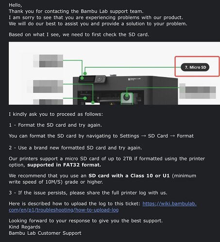

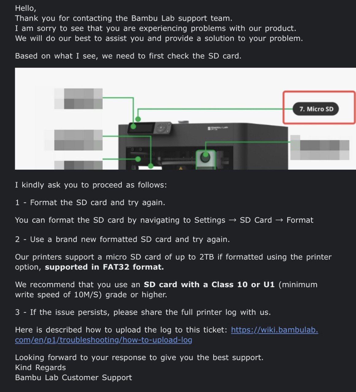

This is the response I received from Bambu Support:

Thanks Timborino!
I will follow your advice and return with feedback.
I’m really not convinced a new SD or reformatted SD is gonna do the trick, plenty of replies above have replaced the SD card already with decent brands but still had this issue.
