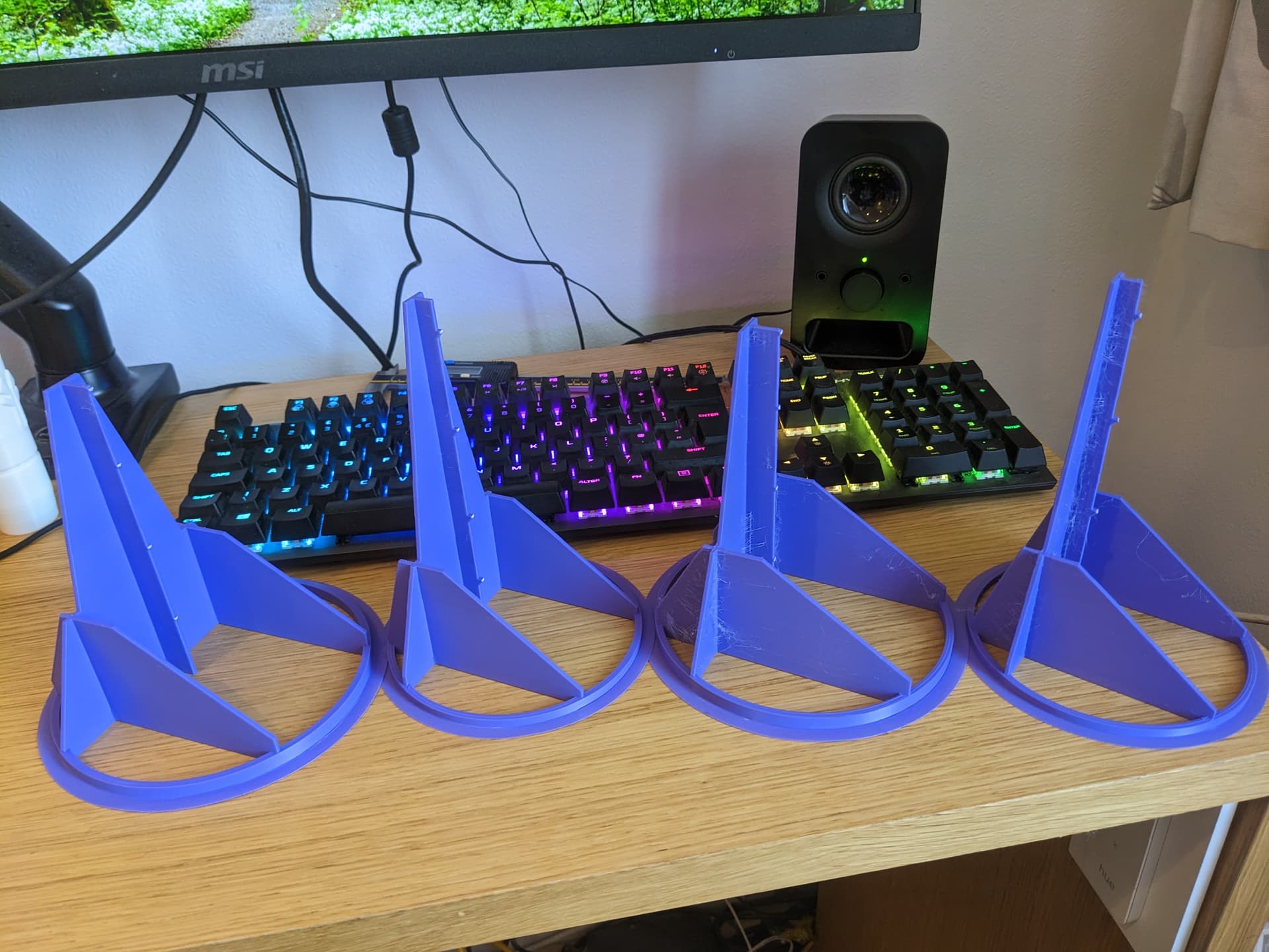

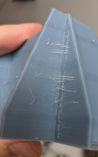

Print quality degrade after Studio 1.7 update

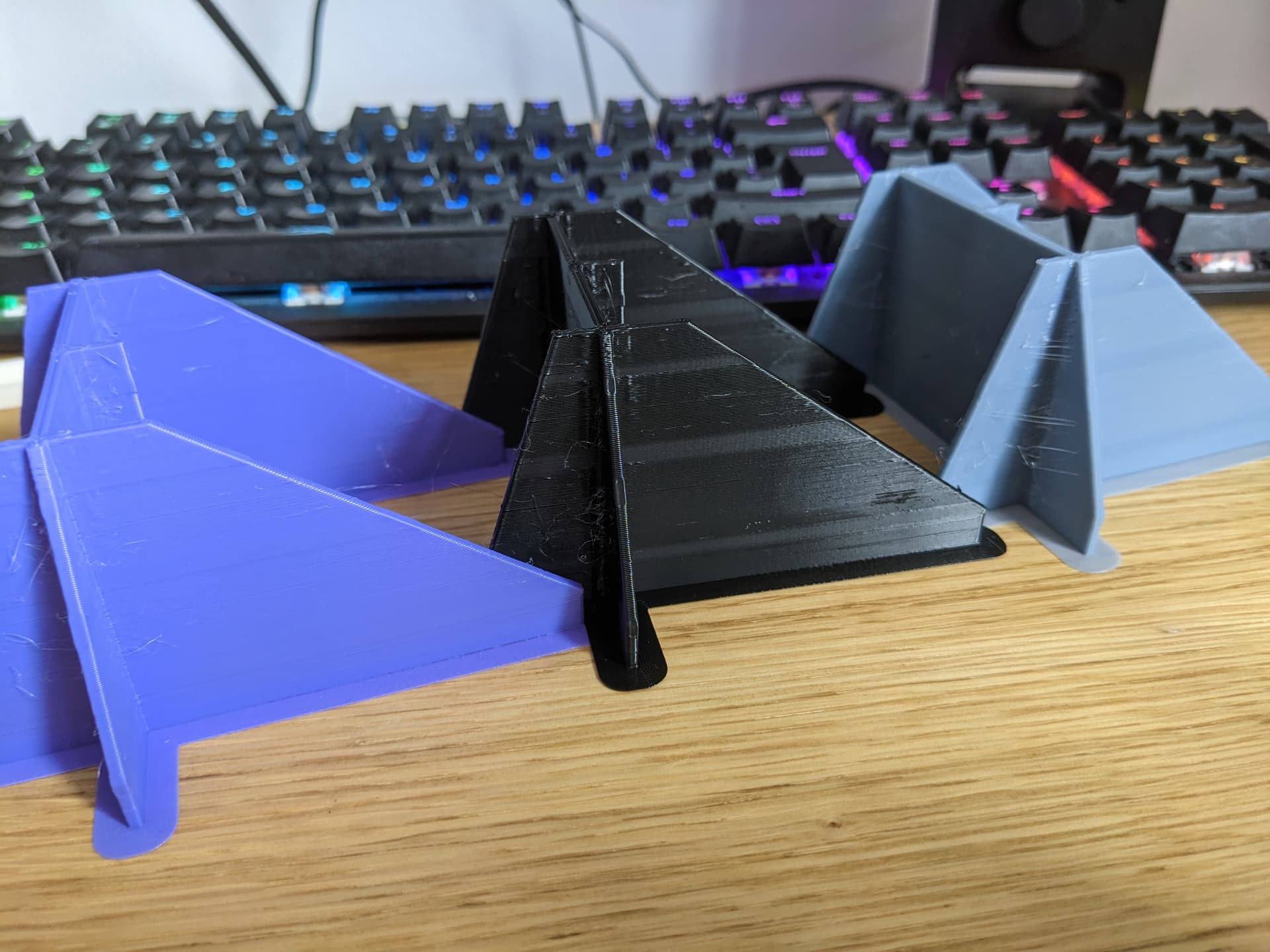

The two prints on the left are pre 1.7.
the two prints on the right are post 1.7
Any ideas?
Is this a calibration thing?

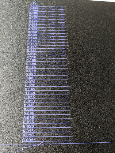

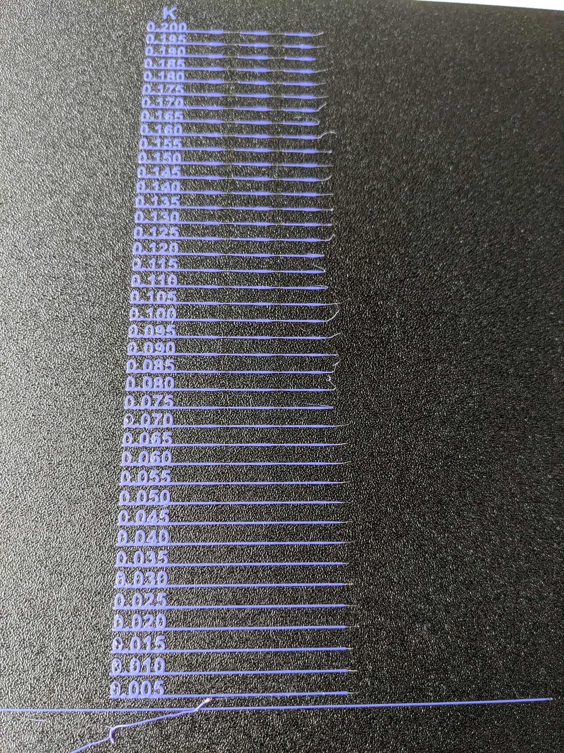

Bamboo labs basic. These were printed off one after the other from a fresh spool with the 1.6 to 1.72 upgrade in between after the first 2. Admittedly its 5 hours per print ( is that enough time for moisture to be a problem? ) It is pretty damp and miserable in the UK atm. But have been running this P1P since launch literally without issue until now. Stringing has never been an issue. I’m just running the calibration flow dynamics calibration now (but I’ve always been fine with K 0.02). Will try a fresh spool after to see if moisture.
Flow dynamics was literally text book. K 0.020 still the best.
However there was a bit of a weird splurge at the bottom of the plate a the start. Sorry cant really see in pic… Maybe indicate a block of some sort. I will run a new spool with test print in a bit.

yep all spools open to the elements, no AMS, no dry boxes or vacuums, never had an issue with moisture that I know off and have happily used PLA spools up to maybe 3 weeks out of bag without any issue. Printer says firmware up to date on 01.03.00.00 the issue definitely started after moving from studio 1.6 to 1.7.
the left purple test piece is the one i started having this issue with 2 days out of the bag.
the black middle one is about 2 weeks out of the bag
and the grey one is a new spool fresh out of the bag and displaying almost exactly the same stringing and other issues (see close up)
so for now Im going to claim this is nothing to do with moisture.
Im thinking this is an incompatibility with a very finely tuned print profile (deliberately slowed down for high tolerance parts with overhangs printed without supports.) and the new slicer update.
i will check for blockages and do that resonance thing calibration.
Also I have an old gcode export of an almost identical piece will try that later.
Frustrating as I have a paid job needed printing for this week.

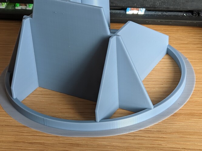

OK its definitely the slicer update
This is just printed now a gcode of the same model with the same settings generated by 1.6. Literally perfect.

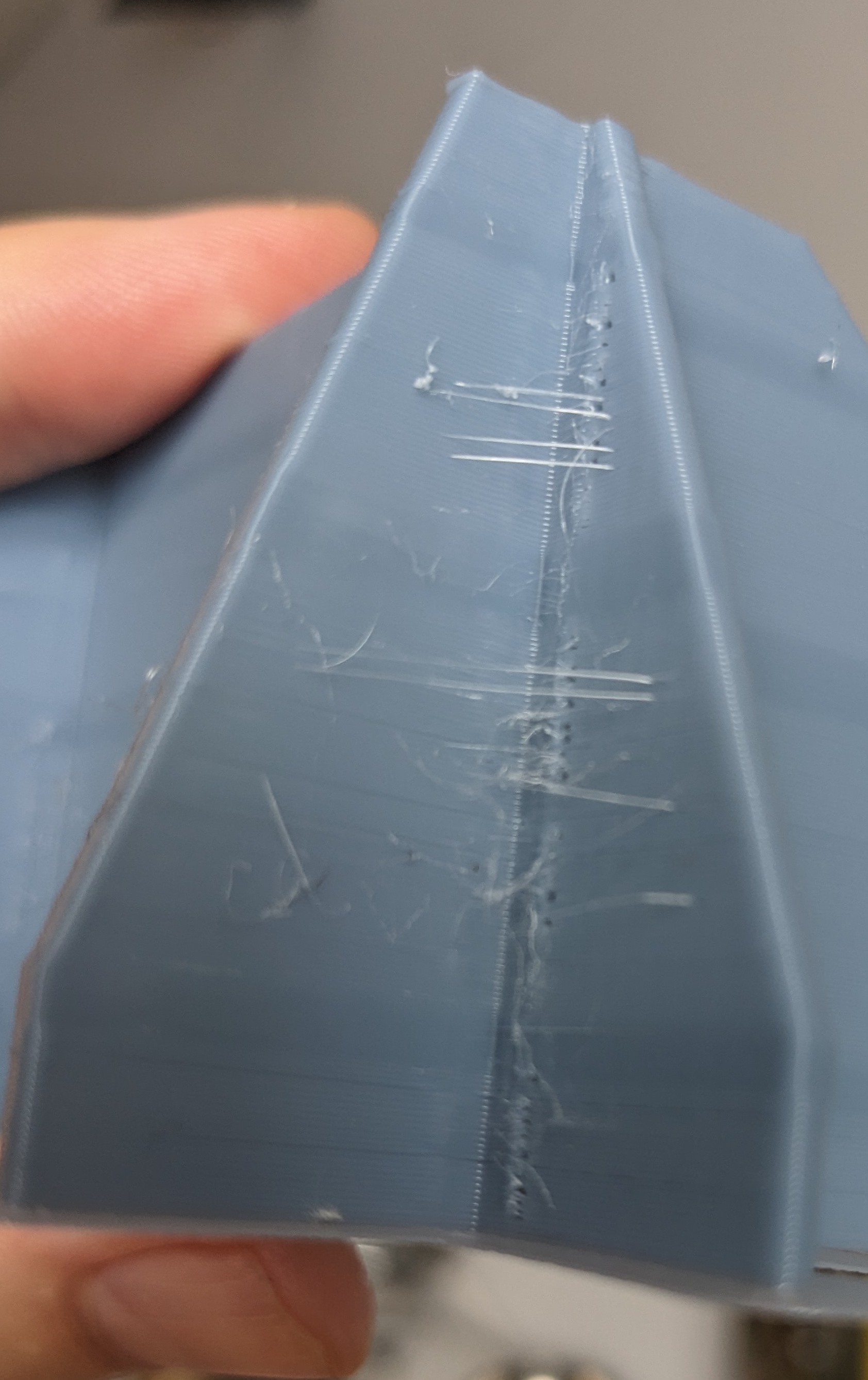

Two simple boxes printed a few minutes apart:
  • Same filament and settings.
  • “Generic PLA” & “0.16 Optimal”.
    The only things I changed were setting Seam Position to Back and No-Brim.
  • 1.6.2 = Produces perfect corners
  • 1.7.2 = All four corners are a rough stringy mess. Updating firmware made a slight improvement, but didn’t fix it
I just wasted hours troubleshooting for this exact issue. Bambu answered your bug report:
“This is bug caused by wall generator and wall printing order. There has a bug at latest version. The wall order is absolutely wrong at arachne wall generator. We are fixing ASAP. Currently you can switch to classic wall generator as workaround”
I guess I’ll stop trying and just wait for the official fix. Thanks for raising the issue.

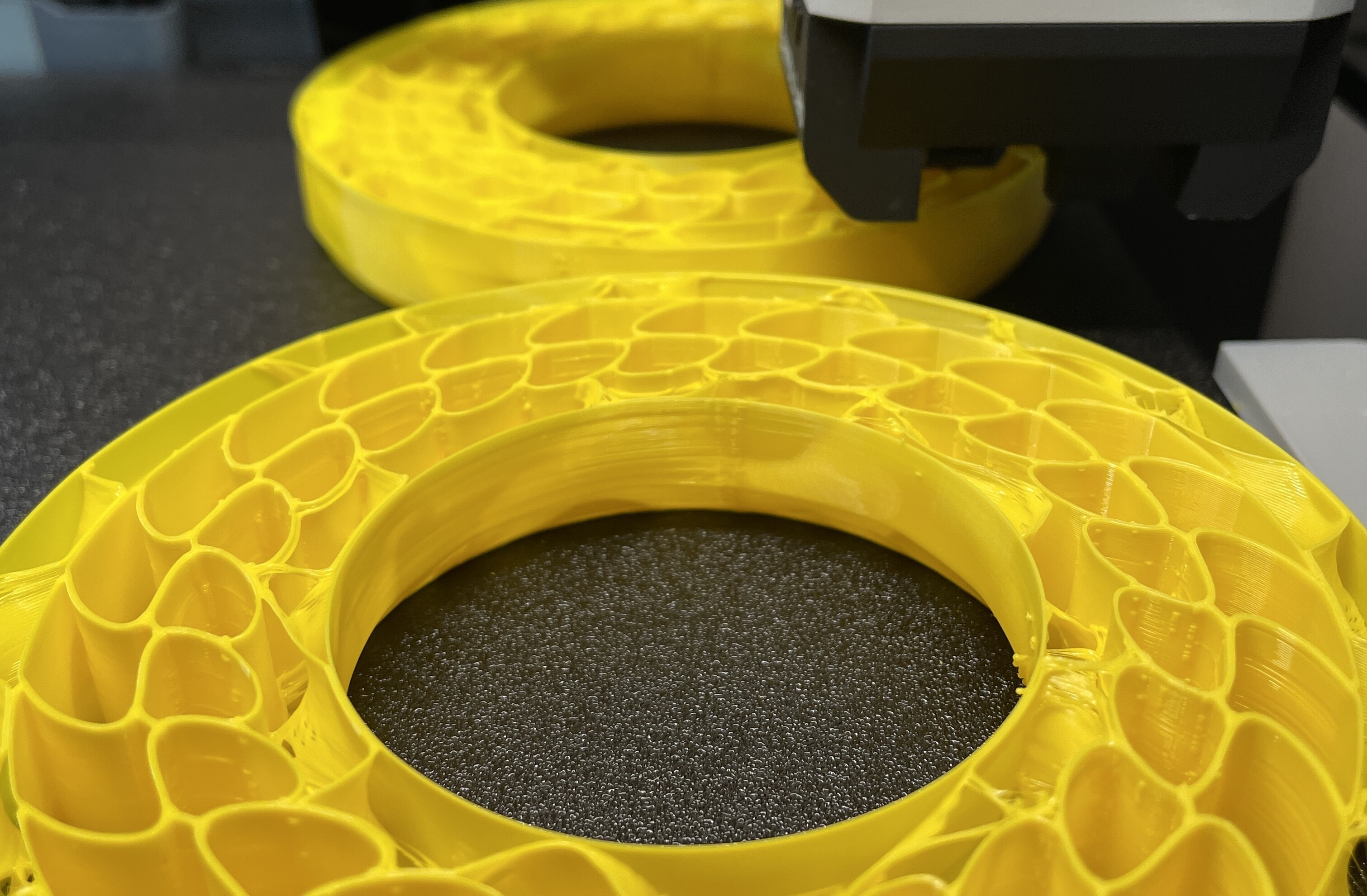

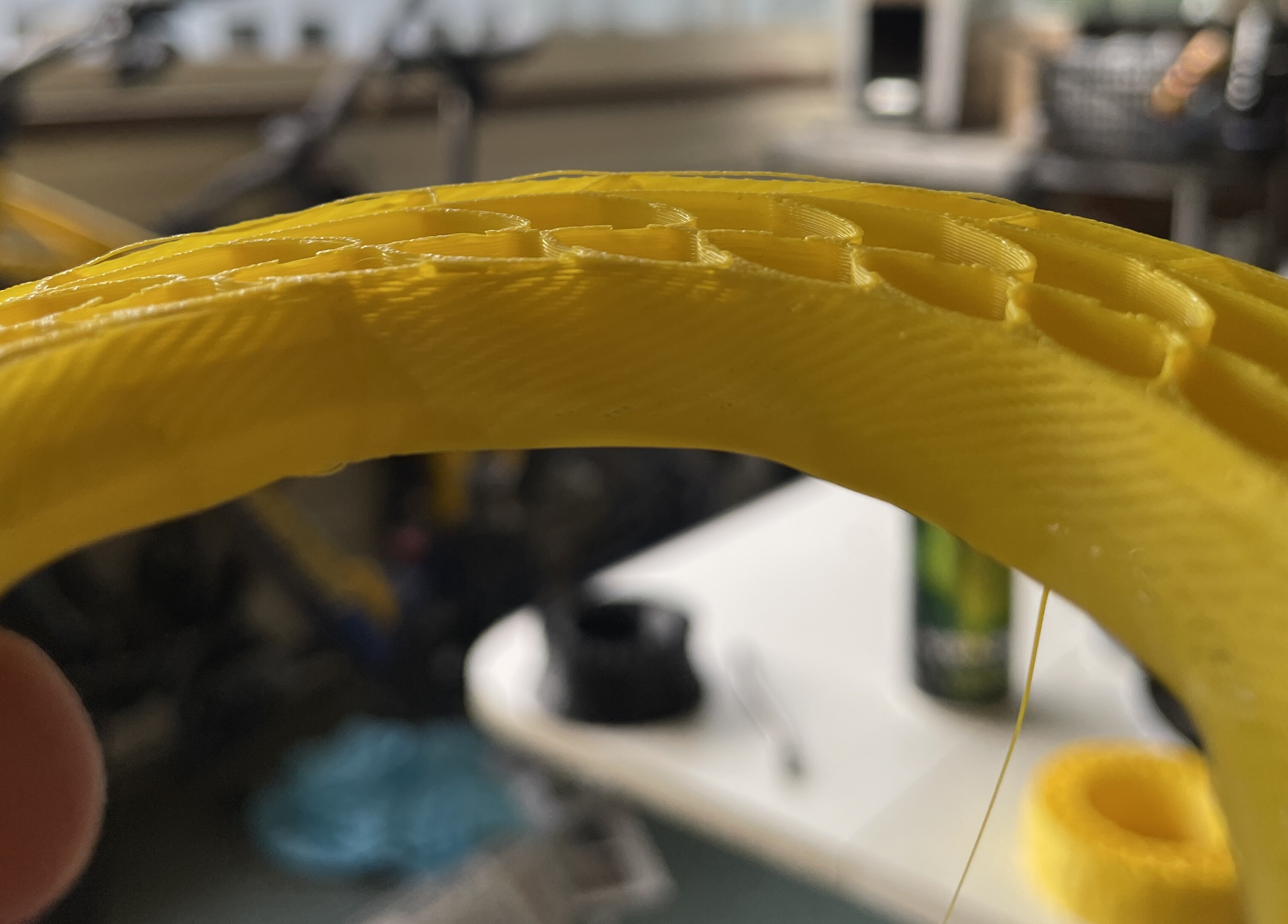

I have the same problem printing tpu. I had the crispest print on the old slicer but on the latest version it the prints comes out with a lot of errors. Lines not connecting, bad layer adhesion and lot of stringing. And the time for the print is reduced by 10% and it uses less filament on the same settings.
This is with the new slicer.
This is the old slicer.
I’m printing extremely “lean” to get the softest prints possible, so the difference is very noticeable.
