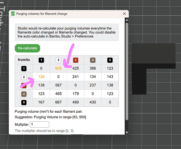

i used Bambulabs settings and tried a simple support test, it breaks directly on the layer where the PLA got printed
make sure the purge is set for cases (pla->petg) and (petg->pla). I am unable to load the 3mf at hte moment.
I loaded the 3mf, and these are the saved purge values:
You’re not yet at the highest flushing. Increase to literal maximum, 900.
edit: a note, a strong 90 degree angle on the Z layer boundary is going to be weak no matter what, so make sure you are tempering your expectations about what “its still weak on one spot” means to you with this specific test model. It shouldn’t come apart on its own or from finger pressure; but its gonna snap from hand pressure
i did do the full flushing volume, i just forgot to save it before
and i also decreased the max Volumetric speed and increased the Brim width so it it is 100% sure no contamination is there
