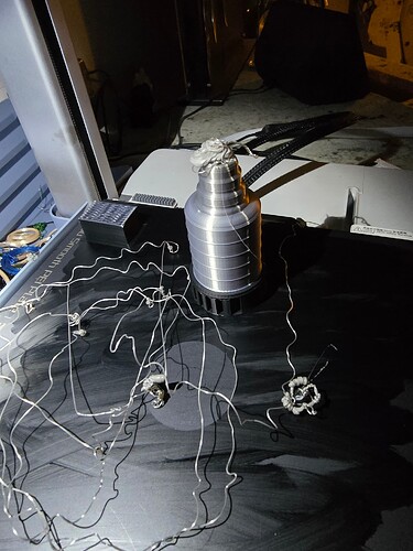

My current print…

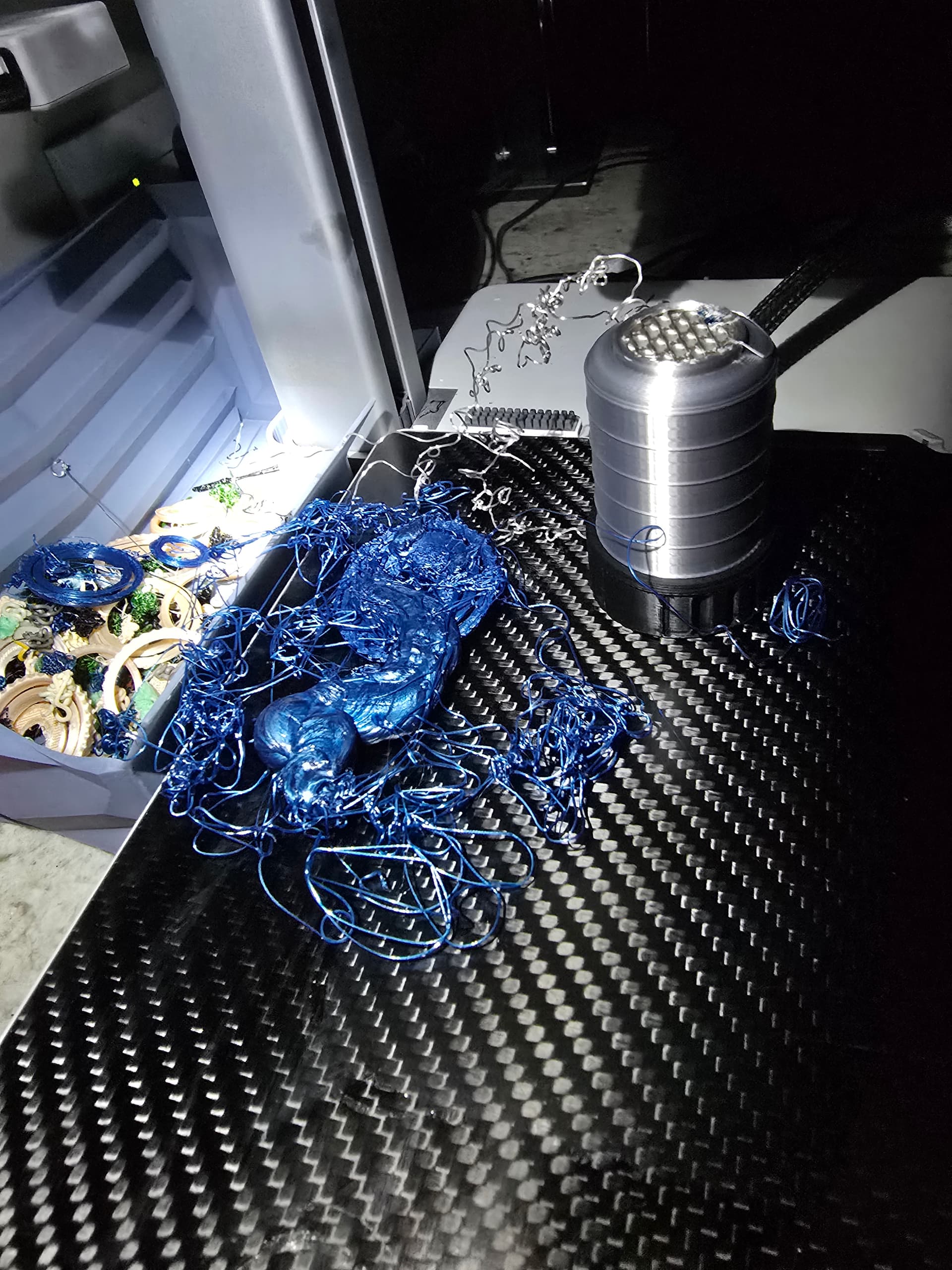

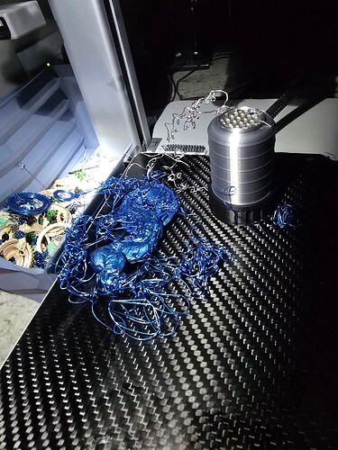

This is a follow up post to my previous post about my printer not working post BOD.
Ive checked every screw and every belt, I’ve washed the plate, I’ve used magigoo, I’ve NOT used magigoo, I’ve changed zhop height, I’ve changed zhop type, I’ve tried PLA and PETG, I’ve tried different nozzles, I’ve dried the filaments, I’ve tried saying nice things to the printer, I’ve tried being mean to the printer, nothing seems to help I haven’t had a fully successful print since before the BOD.
The only thing I have noticed is that parts on the front half of the build plate print fully probably 80% of the time, parts on the back half fail 90% of the time. Usually at about the 20% mark.
The photo shows a failed fidget spinner, next to a failed Stanley Cup. The Stanley Cup is more or less where it was placed on plate in Bambu Studio, the blue fidget was originally in the front right corner of the plate.
That photo shows fidgets that were placed on the back half of the plate during various prints and all failed about the same point.

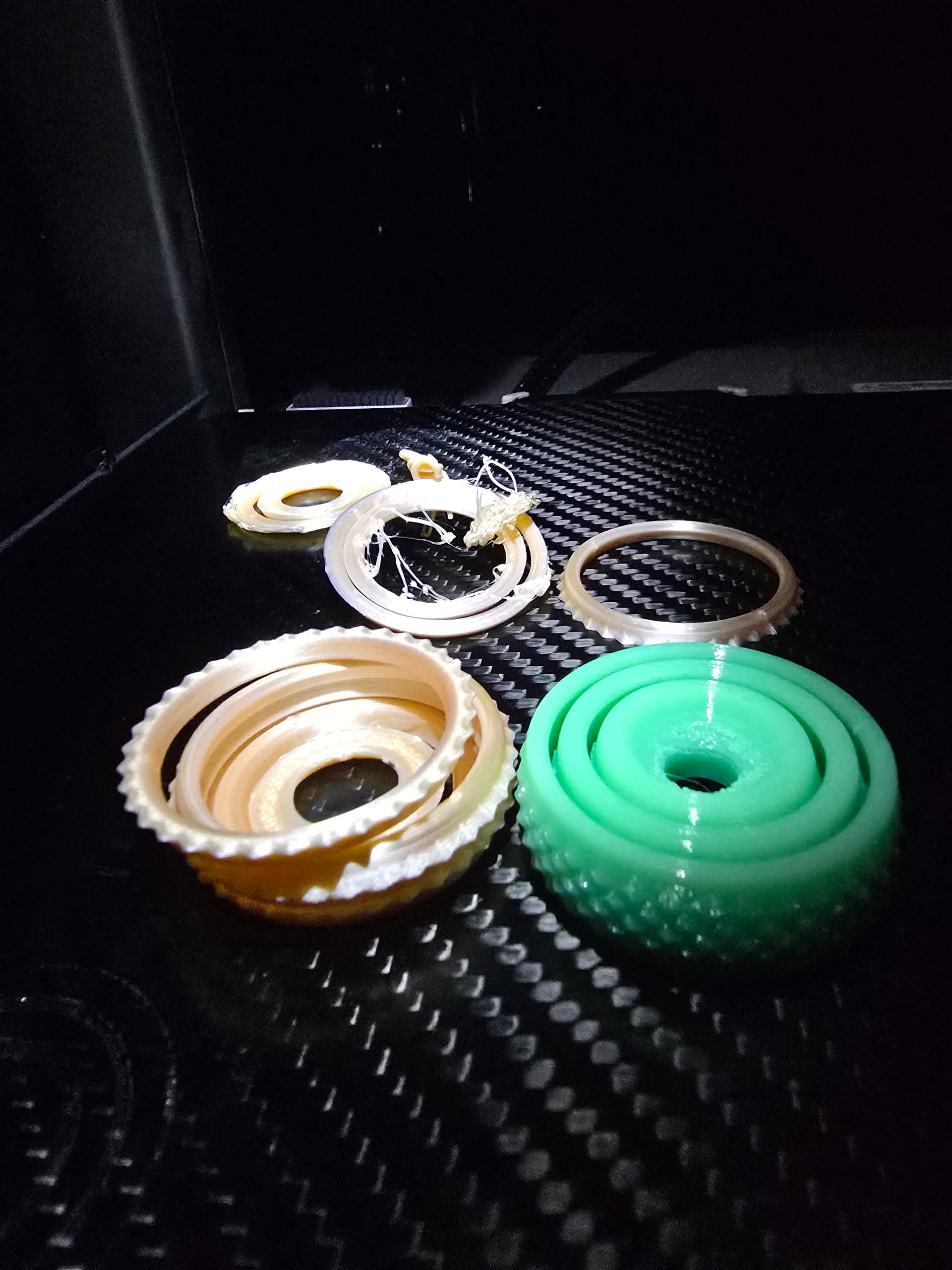

Hello fine people of the BambuLab community!
I have printed this file many times in PLA, but when I print it in PETG it prints terribly. The surface looks fine, but its prints WAY too loose, as in the rings of the fidget spinner dont spin and with almost no effort at all will all come apart.
Any idea why, and how do I get that to not do that?
Using a bambu lab A1 using various types of PETG filament, they have all been properly dried.
I have included the 3mf in question
Spinners.3mf (610.1 KB)
You will want to modify your X-Y hole and X-Y contour compensation.
Positive numbers for the hole make the hole larger. Negative numbers make the hole smaller. Same goes for contour. Larger number grow the outside of an object and negative shrink. This will help you tighten up the gaps between the rings.
Here is an exaggerated slice which is what you want to experiment with.
Well in a weird twist…changing absolutely nothing, except filament…from Flashforge PETG high speed blue to IEMEI (or similar collection of random letters) PETG translucent gradient blue to green, it printed so tight I could barely rotate the rings by hand, much less actually spin them normally.
So close yet so far away.
Tried switching plates again…at least this one made it MOST of the way…
