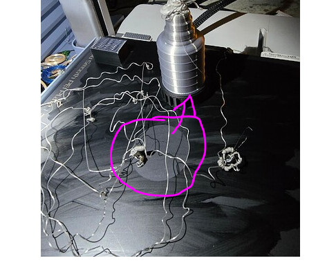

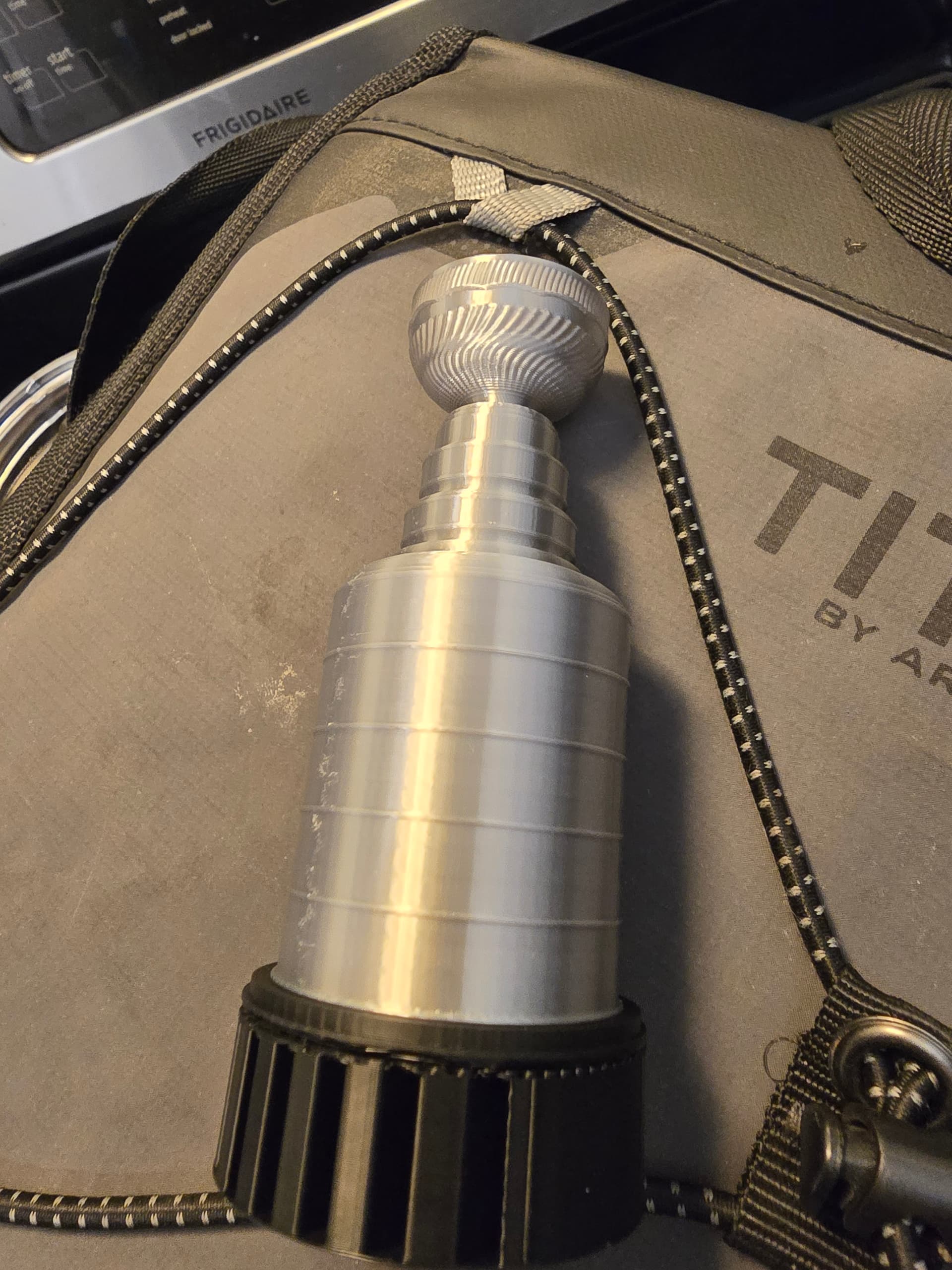

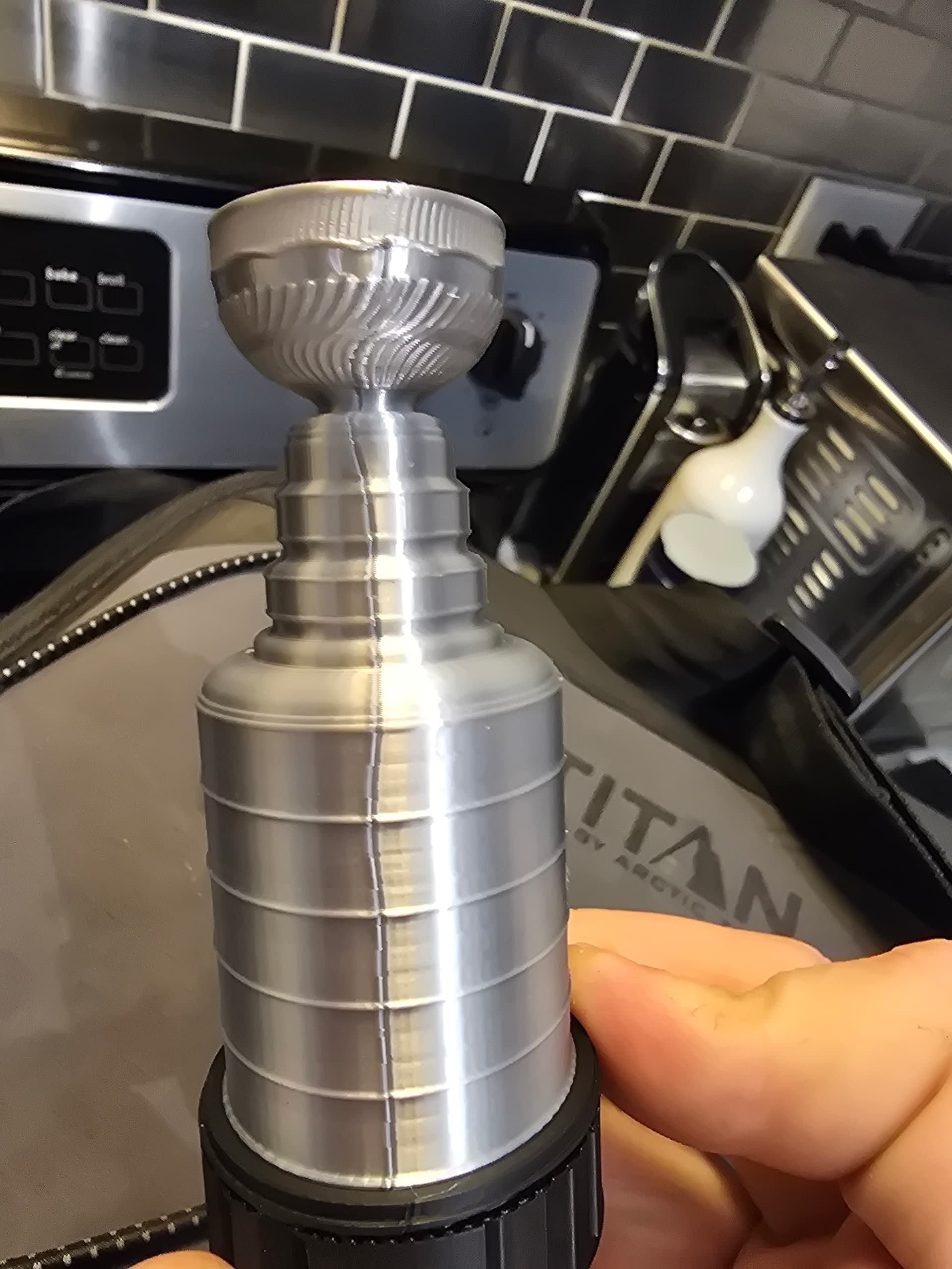

Print a 500% scale totally not for a giant Lego man Stanley Cup, it fails 80% through

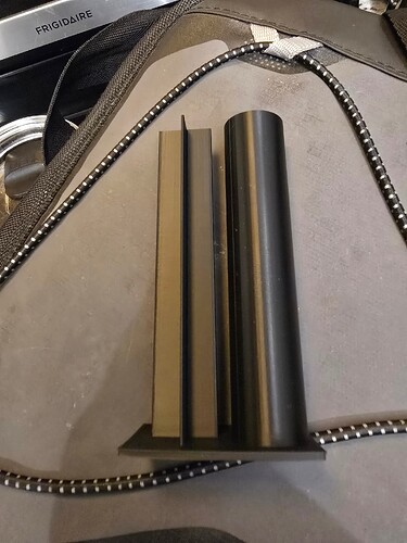

Print a tower test…perfectly fine…wtf

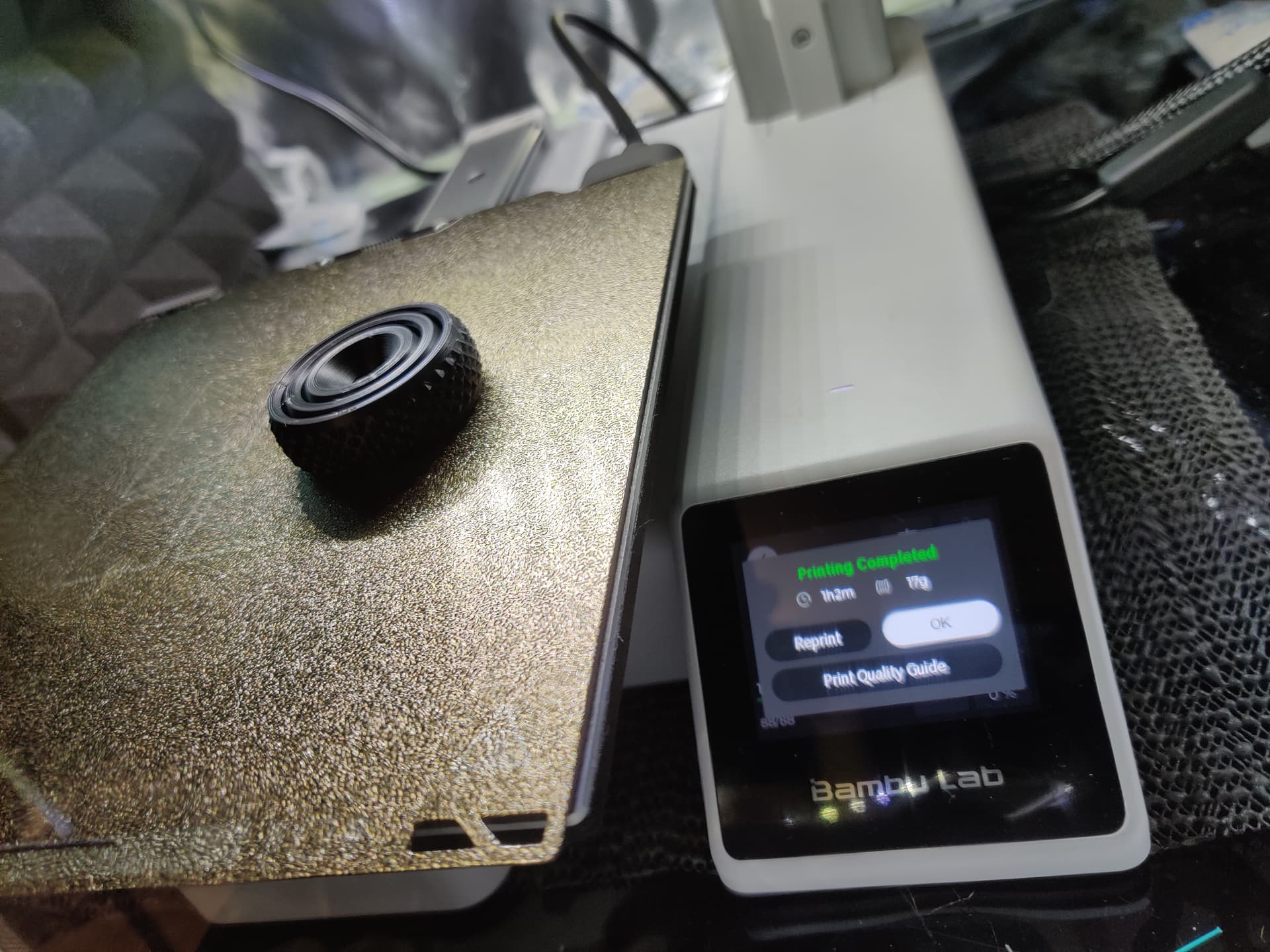

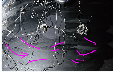

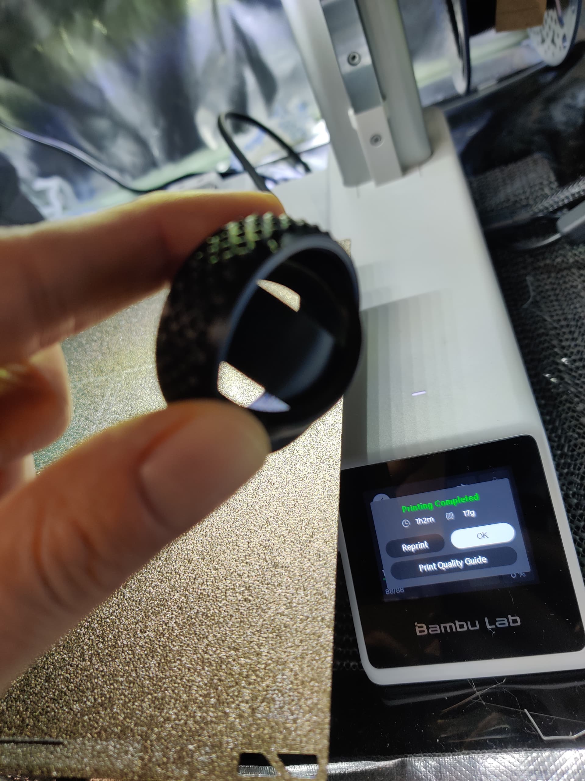

Started this print at 9pm last night and woke up to this.
All I did was press reprint on the A1 screen changing nothing, and ended up with this.

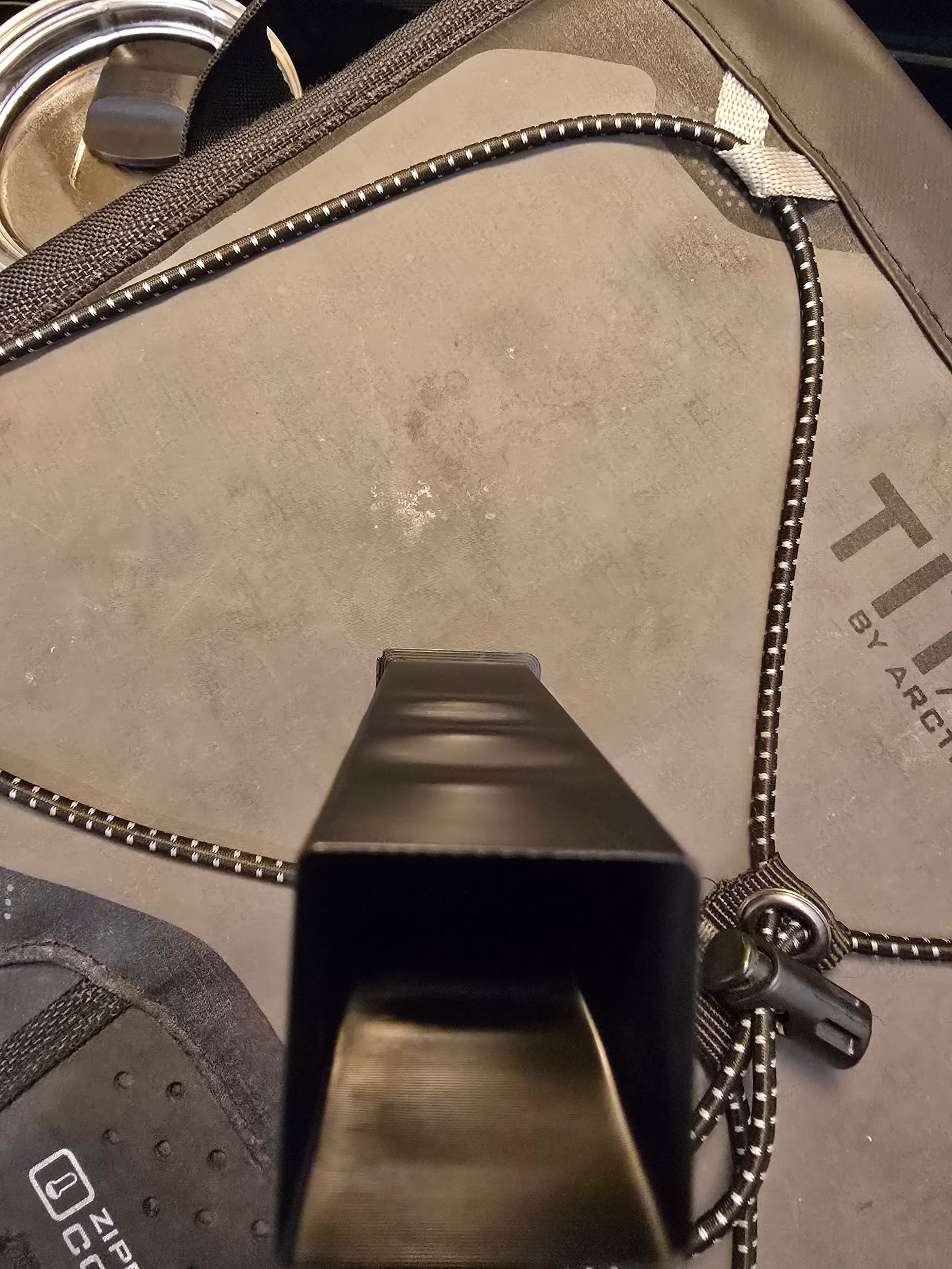

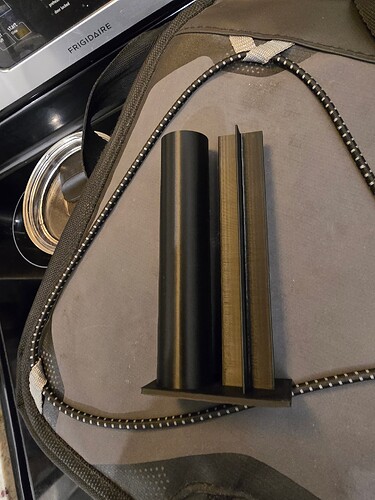

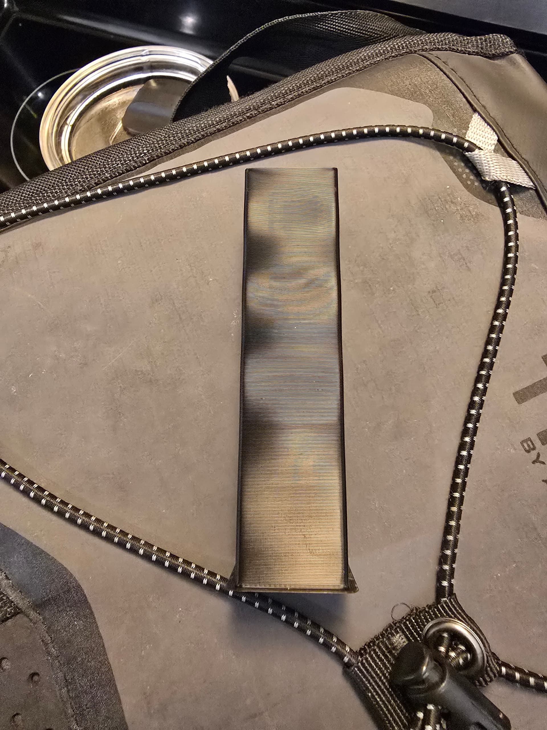

Ran these two prints while I was at work. So I have quite literally done nothing to the printer and nothing you suggested.
The square one is wavy because it’s thin AF but the round and t one while I’m sure isn’t PERFECT it’s by far better than the spaghetti I have been printing…wtf
I think I would be less confused if it was just 100% failure.

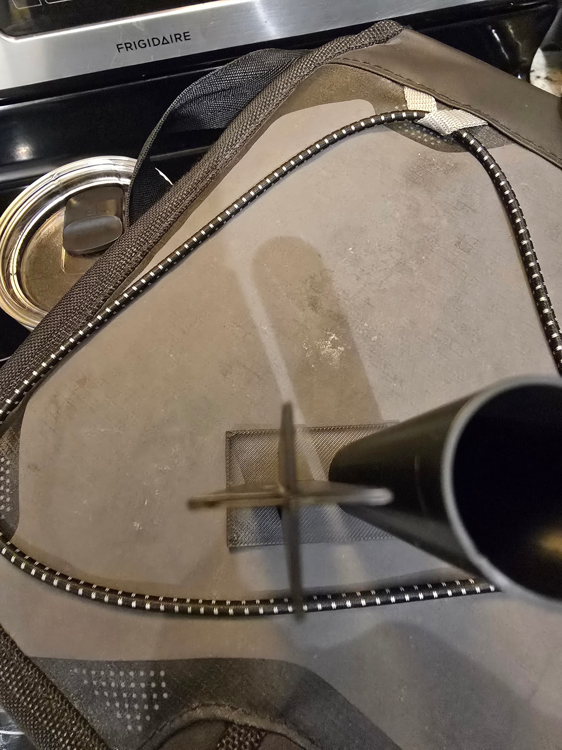

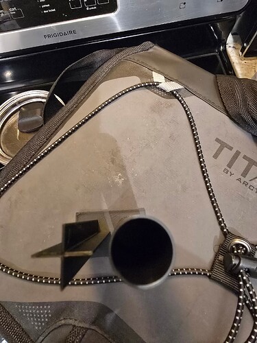

I see a patch, did the print move when you “found” it failed? or did you move this for the picture?
I also see on those 2 towers a nice thick base.
If that print moved - this very well might be the temps playing up, especially with petg and stuff. if you said 6 months ago it was ok - well very possible that was an entire different season you know? humidity, temps air currents everything changes from season to season. I’m still on the fence about temps but that might just well be it seeing as we are getting success on test prints.

nope that is where i found it. I actually remembered to take a photo BEFORE i moved the failed print for once.
the printer was still printing nothing when i stopped it
ok so we shall test further but my vegas bet right now is 10 bucks on black - air temp flux during print

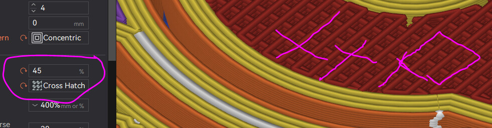

near the plate is fine but higher up the nozzle hits infill (grid usually - change to gyroid as a test to prevent nozzle crossing over) and the force vs speed is enough to kick the print off the plate.

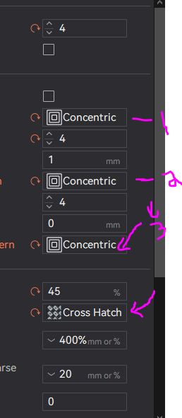

In your do not change file I changed this and sent the file it’s printing now to see >
once you edit the pattern to concentric on 1 and 2 there is little point to keeping crossing grid on 3 so i changed it to concentric.
The infill never use grid that will cause nozzle clip, there are 8 total infills that do not clip it’s well documented I have it written somewhere you can search, just use the new cross hatch if you must.
Also on your wheels here there is almost no point to infill I made mine solid, concentric
even with cross hatch look at the lines - it’s actually drawing “grid” the gap is so close.
As I don’t want grid, i want cross hatch and the gap is too small - might as well solid fill it at the cost of 0.72g of filament VS the 45% fill. if this stops issues it’s a bonus, if there is a reason to make them 1.2 empty…maybe rc car weight or something then cross hatch is still the best bet as the nozzle direction will try to avoid crossing over.

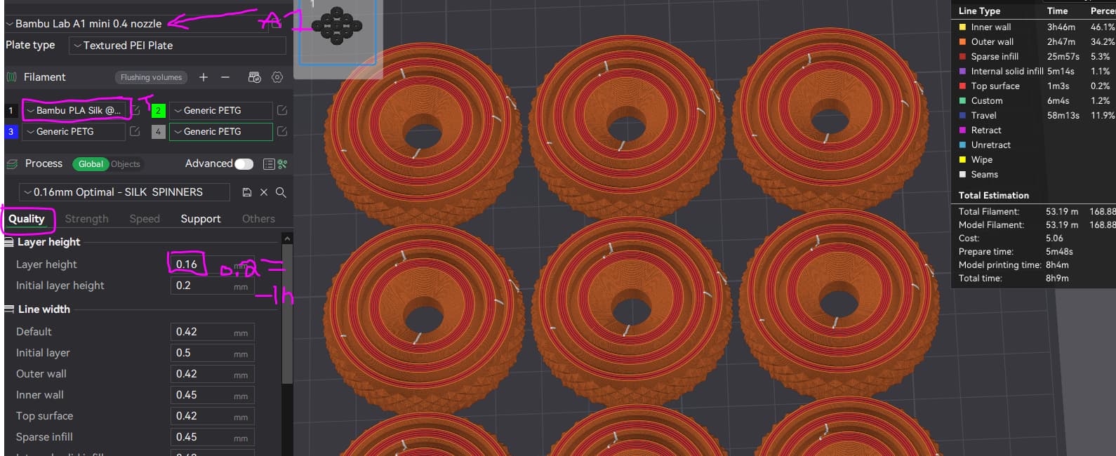

Fidget spinners DO NOT CHANGE - CHANGED.3mf (440.8 KB)

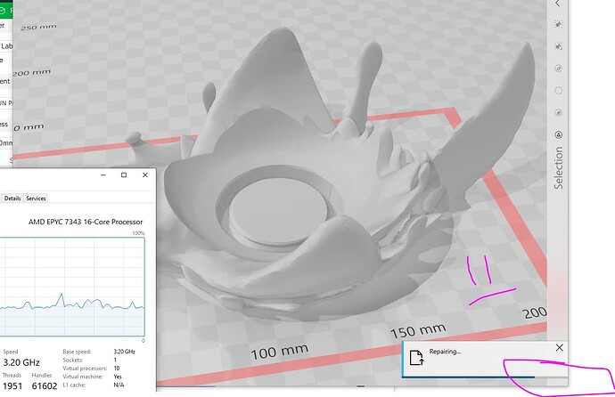

Here if you want to look > a1 mini printer, pei plate, your settings, scarf to 8% and the edits above thats all. oh on my esun pla+ because all other filaments suck naa naa
(honestly look into pla+ if you don’t use it… it is literally ±8% of everything petg is. strength, durability, bending everything. roughly only that far off it so close i just use pla+ almost exclusively now days.)
2nd edit. i just realized this was a spinner jesuz …i thought it was a frickin wheel that’s what i get for doing 50 things at once…

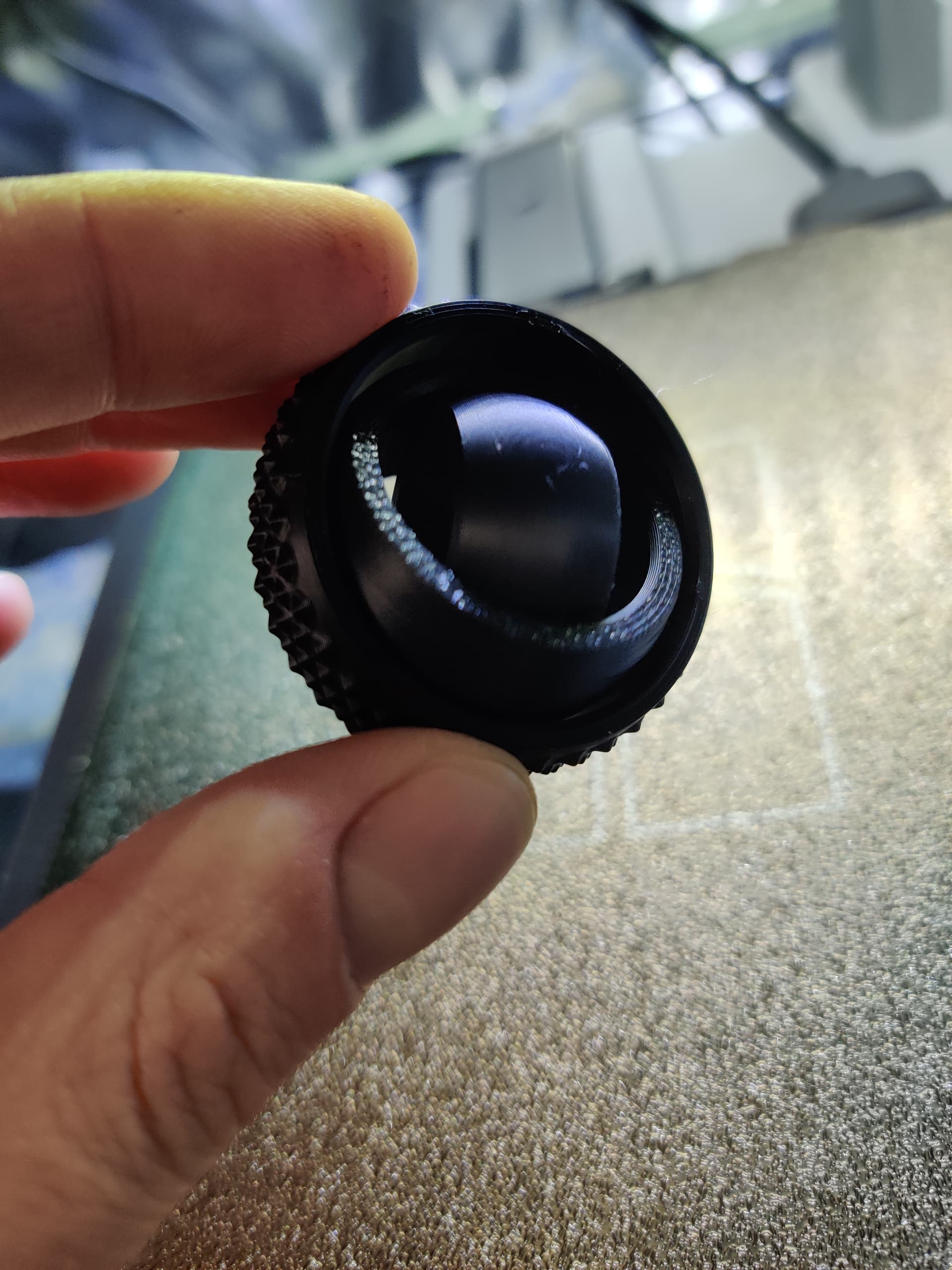

U see, well 100% infill worked fine here, gives a nice spin as well. I popped it off the hot plate as well no problems it is a perfect print.

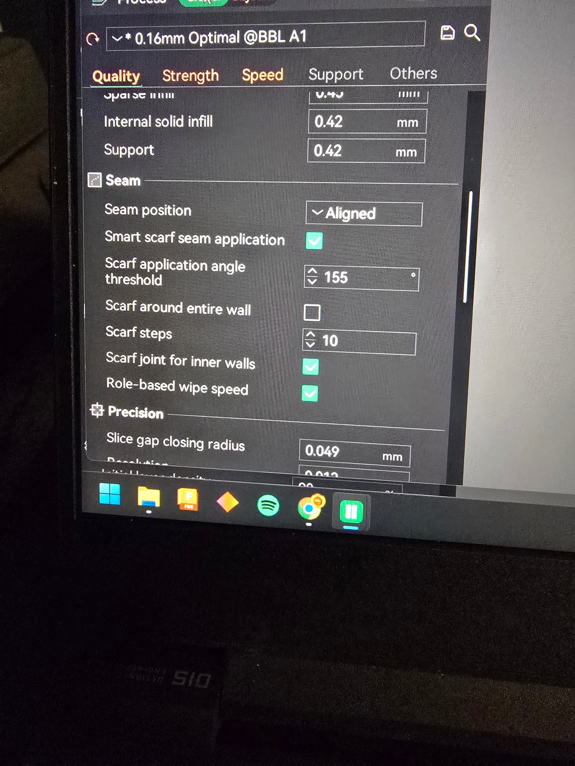

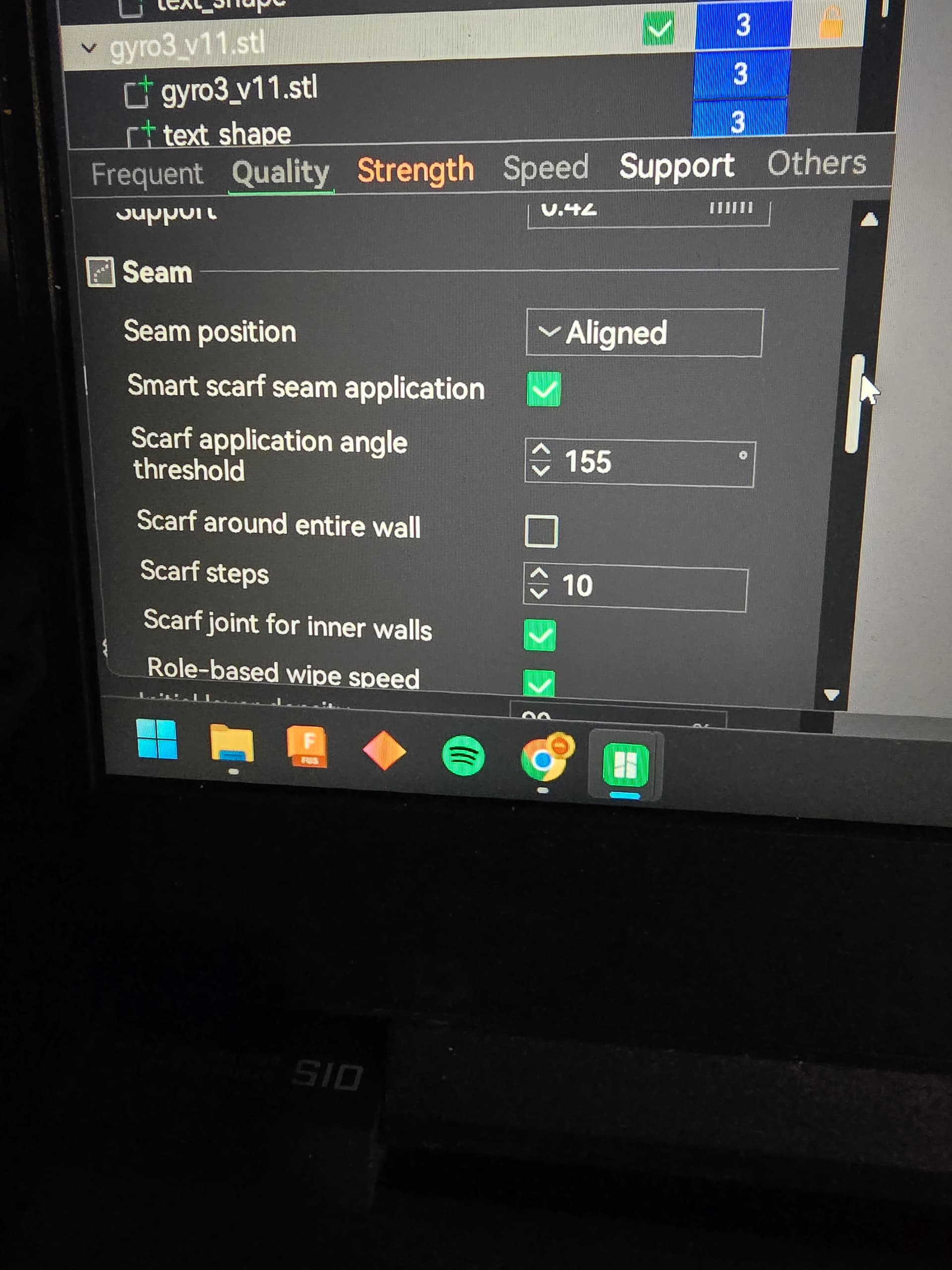

Two (hopefully) final questions…Global vs Objects when do each of those parameters get used? I have an a1 so when i open your fidgets do not change - changed file i obviously have to change the printer to A1. It asks if i want to use or discard. I choose use…i noticed that the global parameters match what you set above, but if i click on the individual model and select objects its more or less my original settings.

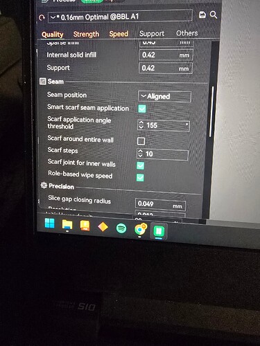

also…wtf is scarf and how do i change it to 8%

I noticed my concentric infill was a moot point as for whatever reason it refuses to draw in a circle inside, but on larger models it does work. Usually with the new cross hatch or gyroid (safest) infill you don’t need past 25% if even that…15% the default is already too much in most cases I start with 10 and see from there. Obviously changing this changes the properties of the print as well.
your fidget spinner I would honestly try once solid like i made IT SPINS FOREVER omg thanks for sharing that my kids already made it vanish and are asking for more. the extra 100% solid weight makes it a real nice toy there.

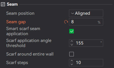

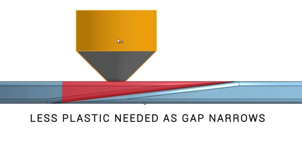

Scarf is something I’ve been testing and I personally find 8% down from the 15% is the sweet spot, going lower somehow adds small holes due to the speed of the print, maybe reducing this will help but i don’t give a sh*t there will always be a seam.
note there is a search magnifying glass to look stuff up in the settings if you can’t find it.
And as to what it is - a debate basically. and how good your printers are. The gist is here
But don’t, you can’t get invisible so hence the debate. Some have gotten close but it all depends on a slew of things and literally never changing them. on FDM you get a seam. I find personally 8% is about the sweet spot for regular speed printing. If you aren’t sure just don’t touch it.

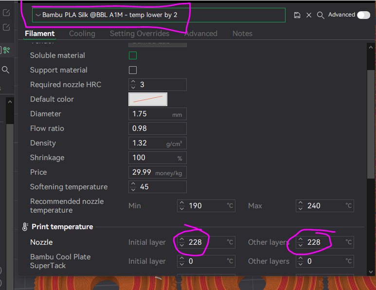

As people here in my house want more spinners you get lucky tonight haha, Also silk is a bit tricky, I made a profile i will print tomorrow in silk myself, so all you need (in theory it will keep my settings) to do is change the printer to your A1 and change nothing else, send it and 8h later your 9 spinners will come out. BUT i don’t think 016 is needed…making this one change with this same file to 02 layer height will shave off 1 hour. But legit it takes 45min per spinner normally so the 8h for silk is very damn fast for solids!
You can try as-is then with this one change to compare the two as you seem to be manufacturing these so quality might be important to you. I’ll post back when i get a set done to let you know.
Note this is a special silk setting slice and it will suck using it for say pla+ or matte. there are special temp and speed settings you need to use for silk to get it super bright and shiny. You can however use it on other silk junk, that will make it very nice! You can go as high as 235 for silk but it makes it very stringy depending on brand and quality, i found the sweet spot to be 228 forced across the print vs shine vs 0 stringing vs speeds. it’s all a fine balance.
IF the settings for whatever reason do not carry over this edit of the silk filament TO these temps and resaving to your own to select should match mine to recreate.
Project Spinners 8h 016LHO SILK.3mf (551.0 KB)

Also I figured out why, in part I was confused about scarf. There’s no option to set degree
