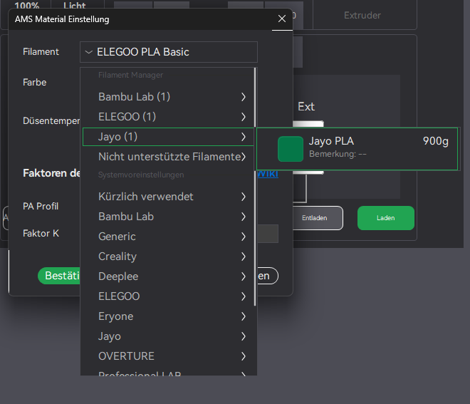

The official live update has been released, yet I still cannot select the “unsupported filaments” option in the AMS material settings, even though the filament has been properly registered in the manager. It appears in the list, but cannot be selected. Furthermore, third-party filaments of the same type but in different colors are also not being recognized.

I’m also seeing that even if you can select 3rd party filaments, you can not change the color in the AMS settings. Trying to post a bug thread but… apparently being a user for 6 months on this forum isn’t enough to gain me permissions to post a new thread?

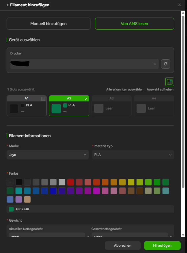

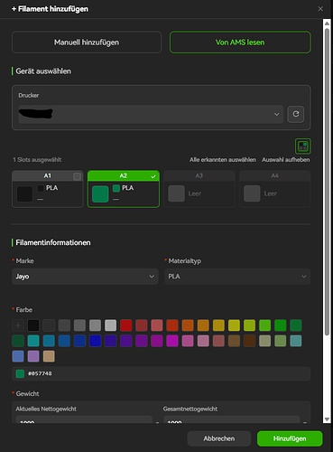

I think I’ve found a workaround.
Try adding your third-party filaments using the “Read from AMS” option. After that, I had all the third-party brands listed separately in the settings and have been able to add them so far…
Unfortunately, you have to go through the cumbersome process of loading all the filaments into the AMS before you can add them.
Works. I can now see the estimated weight was updated.
