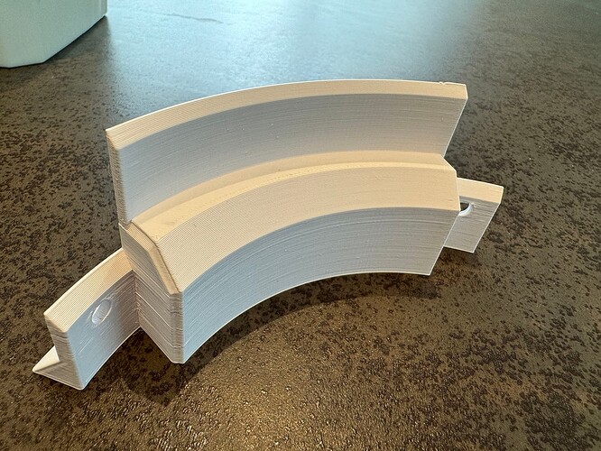

Hi, i need your help. I bought some petg hf. But i really dont get it to print straight walls. I get a lot of layer lines visible on my A1.
The roll is dried to 14% for 30hr now. I tried with different infills, normal and gyroid, i tried with very slow outer salls (50mm/s), 100% speed and 50% speed. Did all possible calibrations, tried a second roll of petghf, tried different models but the results at the 90degrees walls are always like this. Any other ideas?
My Flowrate is at 1.02, but i tried 0.99 /0.98/ 0.94. Temperatur is at 240, and i tried 235 too.
4 & 5 outer walls. Testet with outerwalls first too.
Also on the 45° angle it looks very clean and good.
Also tried with petghs from esun and other pla’s, no problem there.

My gut feeling insufficient cooling and/or excessive volumetric flow rate for the type of PETG. 4-5 walls sounds excessive for a lot of uses - it’s certainly possible to tune for that, but it’s a lot of hot plastic concentrated in one place, and the wall speeds may have to be turned down even more than usual in order to ensure that the plastic cools down faster. This really looks like the plastic isn’t completely cooled enough every layer and prints are too fast.

Oh, it probably is related to speed and cooling unfortunately. They don’t tell you this but when you increase the density of FDM parts beyond the standard density, heat buildup can get significant and start distorting parts. 2 → 4 walls is huge, and 15% → 30% infill is also huge. I have done 4+ wall prints before and without tuning, even with a lot of brands of PLA, I’ve seen exactly the same type of layer lines that you see. I would consider at least going back to the default 15% infill, as most parts simply do not benefit significantly from more infill (if anything, more outer layers is better for strength than more infill)
Most of the time, I find it’s a better idea to start tuning speeds with the filament settings using the maximum volumetric flow rate instead of speeds. To maintain high speeds even with the very high density part, try increasing the cooling settings (probably min fan speed threshold and max fan speed threshold) for PETG HF. Unfortunately, for some materials, this can significantly decrease layer strength, so you will have to experiment. The safer setting would have to be go decrease volumetric flow rate, but this will push your speeds down to something closer to what normal grades of PETG can achieve. I think you will probably have to do a combination of both. The default fan speed for PETG HF is very low so there might be a lot of room for improvement.

So after testing a day, this is my best result:
It is better, some parts are even perfect, but still the walls a bit bumpy.
Always with 3 walls and 15% infill.
I tried temperatures from 235 up to 260, different flowratios from 0.92 to 1, cooling, gyroid&standard infill, different wall thickness, some low speeds, and readjustet the K-Value from 0.035 to 0.03.
I think I can live with the settings for this project, but I will switch to another petg brand the next time. My eSun hs walls are most of the time better than this, althogh all other parts are much cleaner with the petg hf.

I would start with drying the filament again. Check that you have a hygrometer the can measure %RH well below 10%. I had a similar issue with ā€œwetā€ filament. I bought some PETG-CF and dried it till the hygrometer showed 13%RH. The result looked terrible as you can see in the picture.
After drying it 6h longer the hygrometer showed only 7%RH and this was the printing result:
Between the two prints settings have not been changed. It is just the same gcode-file stored on the A1 sd-card printed again. Now I dry my filament before printing down to at least 7 to 8%RH .

You can use dry air in your filament dryer to dry to low filament moisture anywhere regardless of ambient humidity. Ambient humidity imposes an artificial floor to how low you can dry to. A dry air purge removes that limitation.
You can generate a low flow of dry air with an aquarium pump, a straw to make the air flow through the desiccant, and a container of desiccant like silica gel beads. It works like a charm.
I created a print that puts it all together but you need to know how to do a little fine soldering but you can see it’s just a pump, a straw, and a container of silica gel beads. It truly does work. Every time too.
