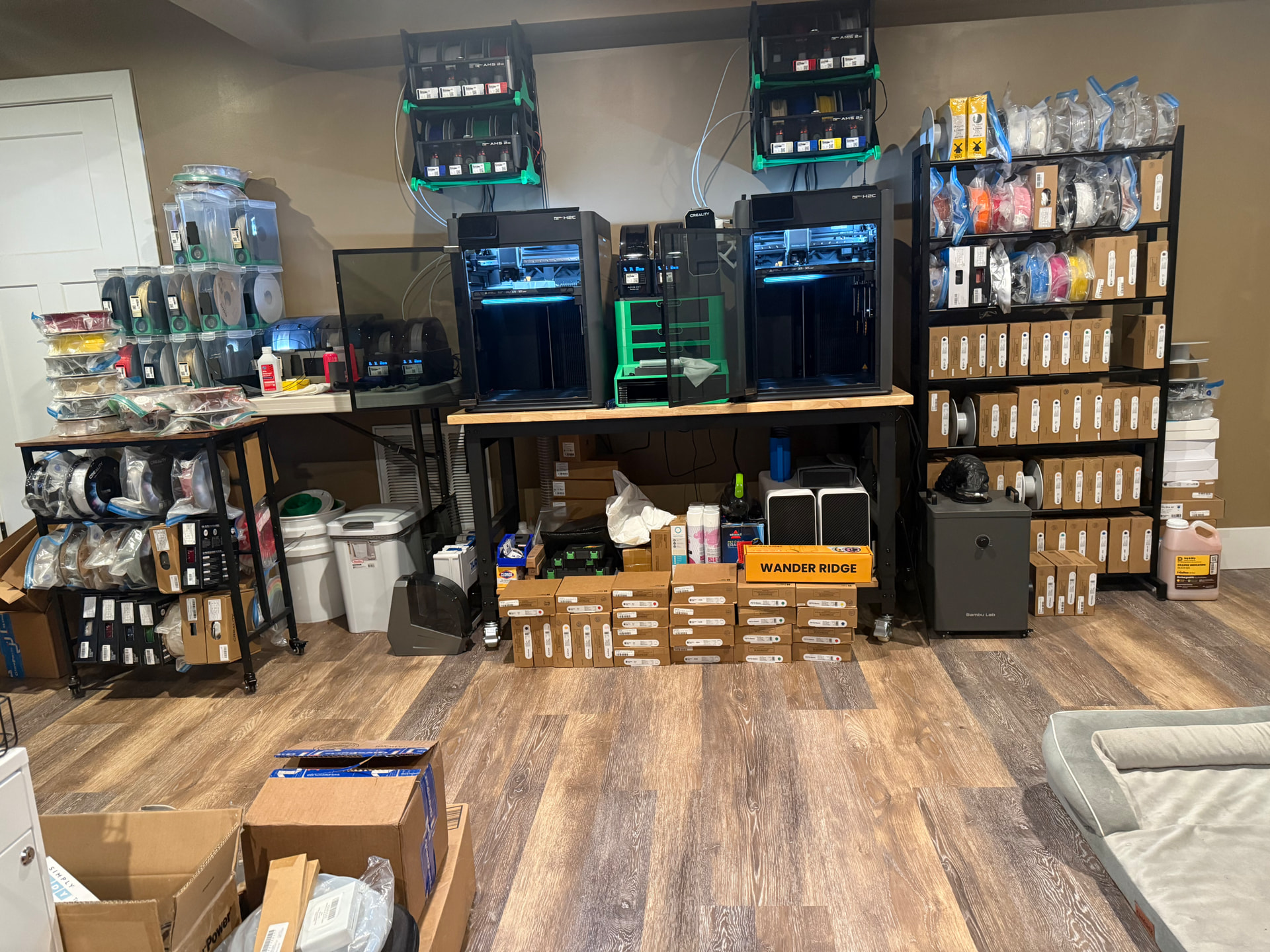

I’ve found that not all PTFE is created equal. I was buying cheap stuff off of Amazon with limited success. Now I just buy it direct from Bambu and I no longer have issues. This is my setup. Two AMS 2 Pros each on the right nozzle, and two AMS HTs each on the left nozzle. No feed issues.

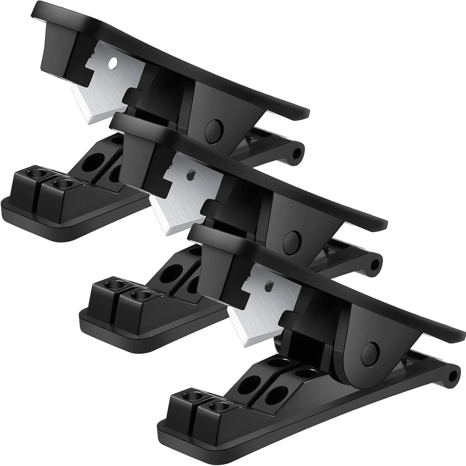

Juuuust in case… when I cut PTFE tubes I have learned that it’s really important that the end be cut square, not on an angle, and to use a sharp razor for the cut, not scissors. Scissors will tend to make the cut end pinch into an oval shape that will catch filament. Angled cuts may not sit flush to the fittings and create a point where filament can hang up on a crack.
I got one of those when I ordered a bunch of PTFE tubing. It seems to cut nicely.
Hi Kerwin,
Firstly.. love the setup!! :slight_smile:
If I may, how long are your PTFE tubes from your AMS? (roughly)
My setup is similar to yours, except my AMS units sit under my printer with filament feeing upwards.
Not sure if thats contributing in any way, but it is annoying me!
Yes, I did buy my tubes from Amazon.. so I am happy to purchase form Bambu to get my setup to work, but I am not sure how or why that would causing my issues?
