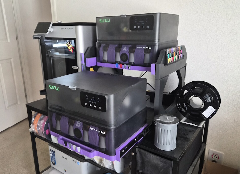

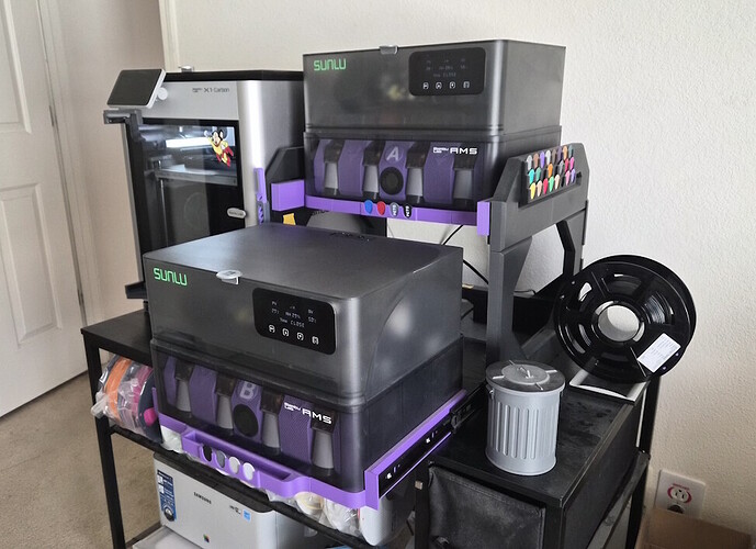

When I first added my second AMS I had ordered some clear PTFE from Amazon. I ended up printing a 2 level rack for the 2 AMS units. The bottom tray pulls out for access to the lower AMs and required longer PTFE tubes. My very first print from the bottom AMS with the longer PTFE tube had retraction problems. Tried different filaments and it consistently had issues. I did have some of the Bambu branded PTFE in the house and replaced the tube and bingo, problem solved. Its been over a year and Ive never. You can see here that drawer open. I probably added about 18” to the length of that tube
had the problem again.

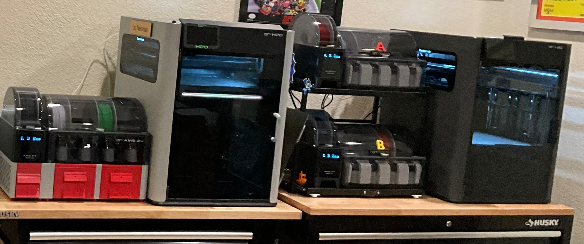

My only statement that I can make about Bambu’s specifications is that my 2x AMS Pro 2 do work. Occasional resistance errors, but the filament always loads. Those tube lengths are approximately 1.5m (give or take a little but pretty much near the 1.5m mark). My 2x HT’s are the problem. Now, they sit appropriately 100mm higher than the AMS Pro 2, so those cables (for the HT) are in fact shorter than the AMS 2 Pro. Its the shorter cables that aren’t working.. and its driving me somewhat bonkers as to why!
Now to add more to the mystery.. ready? hahah.. I in fact do have a FTS. My 2x AMS Pro run directly into the FTS, which I have mounted at the base of my H2C. From there, they run upwards, into a 4-in-1 adapter which then leads up into the nozzle/toolhead. So, if we want to get technical, I would say for my AMS 2 Pro connections.. the ENTIRE cable length (or filament run) is near 2.0m (give or take a little) and works fine. My HT’s don’t connect to the FTS. I’ve bypassed that and they go directly into the 4-in-1 adapter and into the nozzle/toolhead. So their cable length is far less than what connects my AMS 2 Pro, and as mentioned, they dont work :frowning:
PS I am away for work, though I will post a pic of my setup when I get home, this coming Friday evening. That will give you all an idea of my setup

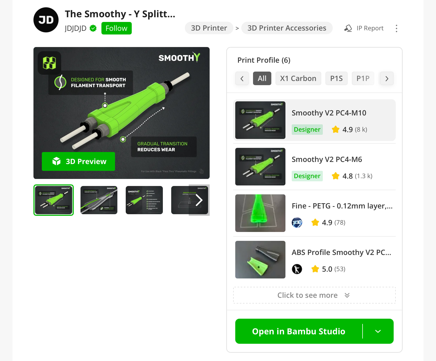

I went through a similar experience. Here’s the thread.
Cut to the chase - Smoothy for the H2C twin AMS-HTs. It’ll fix what ails ya.
https://makerworld.com/en/models/18174-the-smoothy-y-splitter-connector?from=search#profileId-17021

I wish I could take credit for that AMS rack but I found it here on MakerWorld. As you can see I have the origional AMS and added the SunLu dryers. They actually AWESOME but with the textured covers you couldn’t see the filaments so I did modify it a bit to add the color chip holders into the rack and had to raise the top shelf by about 15mm to fit the Sunlu heater so I guess its a remix and Ill take credit for that! LOL
