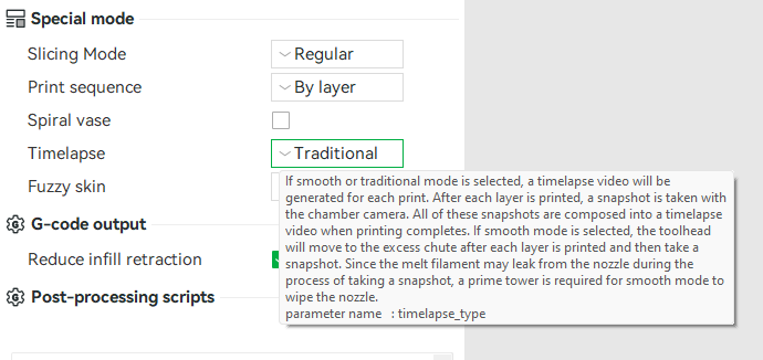

During printing approximately every 18-20 seconds, the hotend heads towards the purge wiper for a pause/cleaning, this can be useful for quality but lengthens the final printing time. Is it true that it is due to the fact that timelapse is activated? Or is it a function that can be set by Bambustudio? Thank you

For future readers reference here is a thread detailing how to turn it off.
Mine goes from time to time near the purge point but not exactly. No timelapse (i do not see the point of it on the bed slinger :D) but still not sure if it does it only on multi-color prints or it does them on single color too?
Me too in single color and no timelapse, it seems to clean fast the hothend but i’m not sure.
