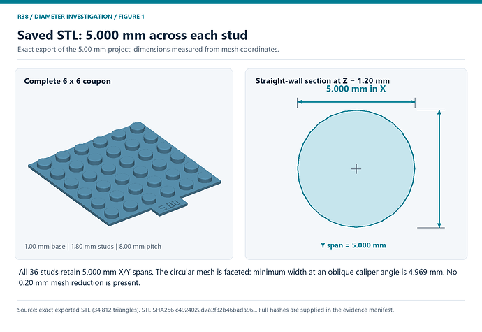

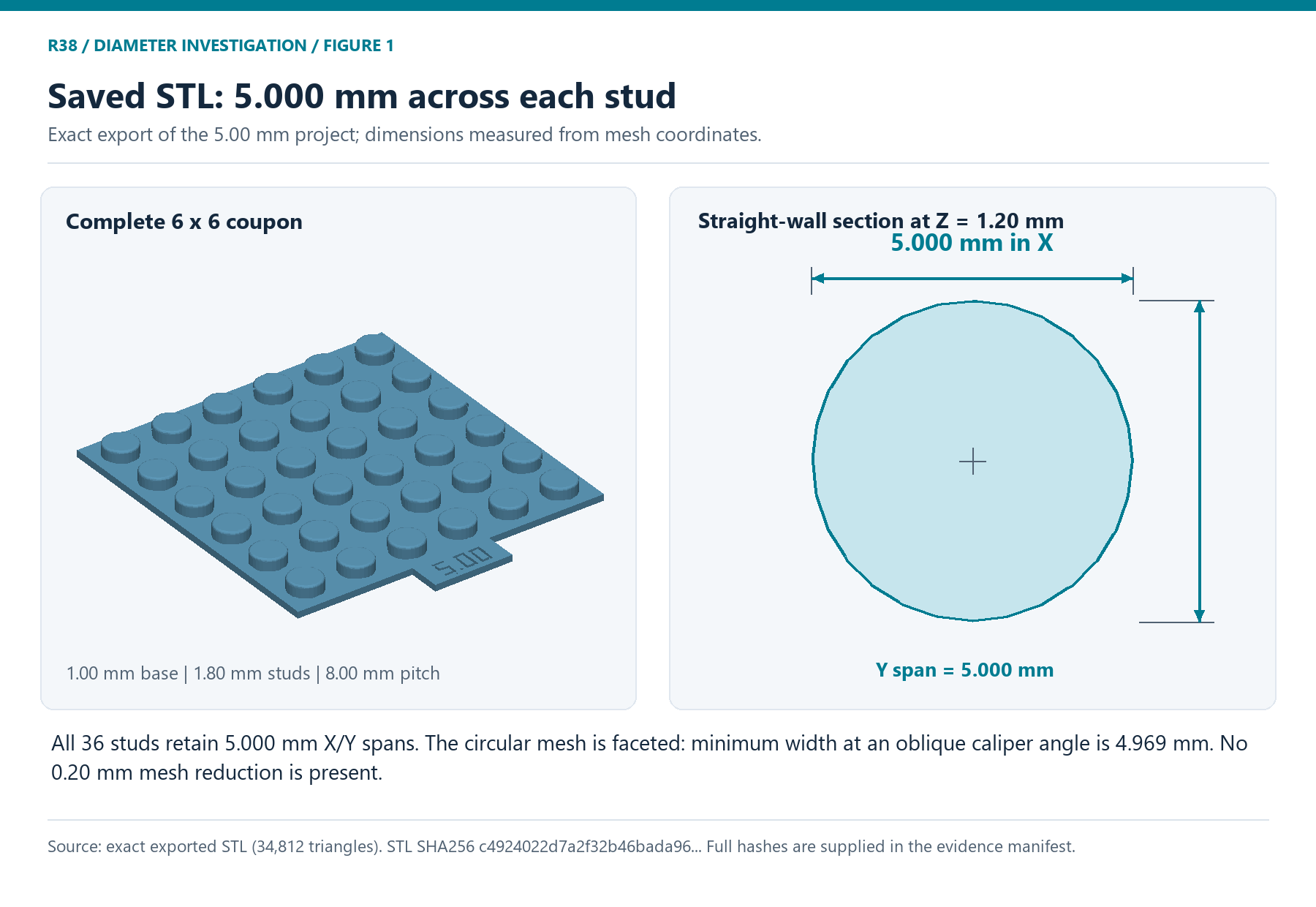

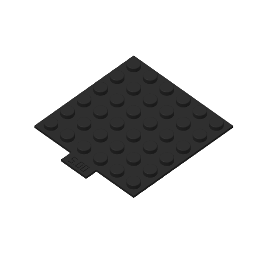

1. Saved STL geometry
The STL is exported from the actual saved 3MF mesh and checked by re-reading its coordinates. All 36 straight-wall sections measure 5.000 mm in X and Y. The retained circular mesh is faceted: its minimum oblique caliper width is 4.96856 mm. This small mesh approximation is documented and is not a 0.20 mm reduction.

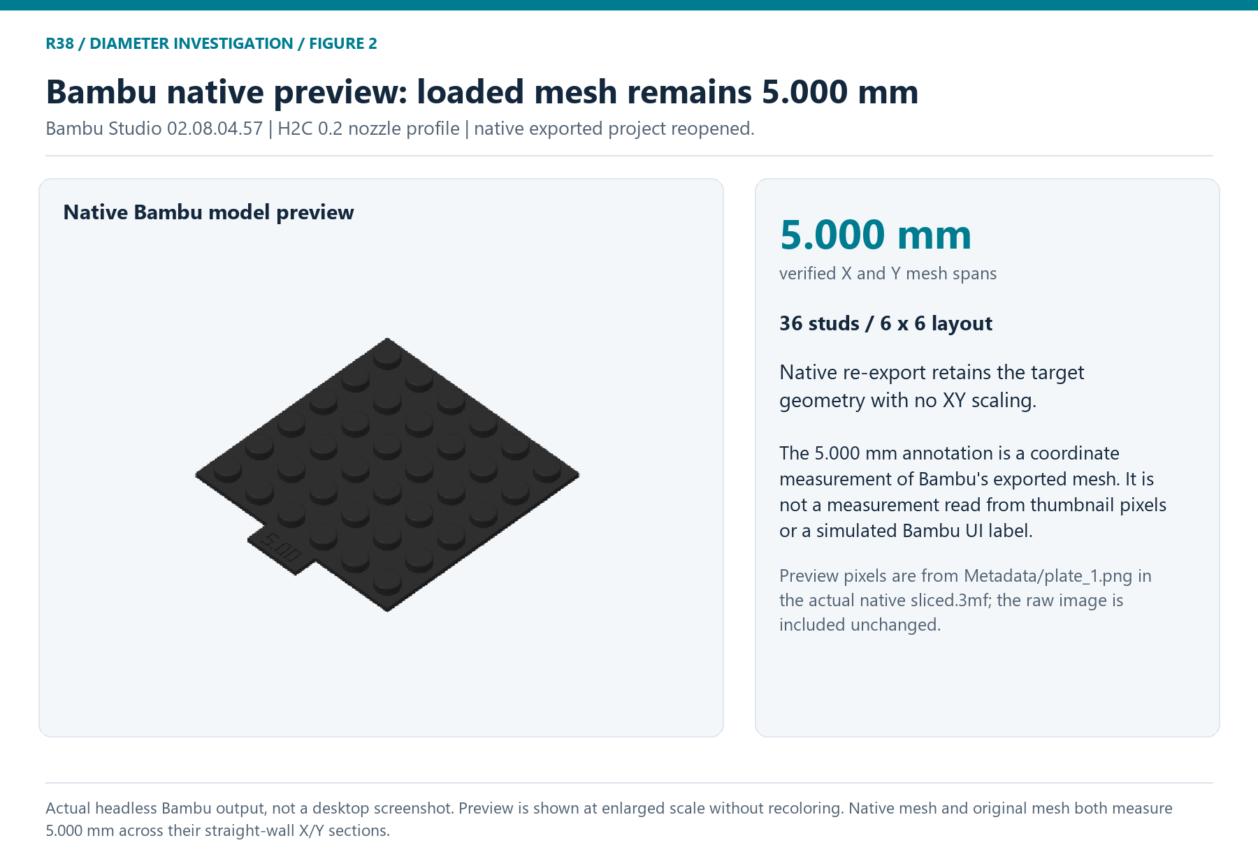

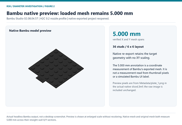

2. Native Bambu preview and re-exported mesh
The preview comes directly from Metadata/plate_1.png in Bambu’s actual exported sliced.3mf; the raw native PNG is also attached. Reopening that native project confirms 5.000 mm X/Y straight-wall spans for all 36 studs. The dimensional caption is an independent coordinate measurement, not a Bambu measurement-tool readout or a measurement from thumbnail pixels. This is native headless output, not a desktop screenshot.

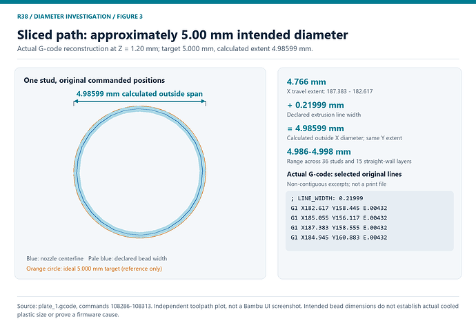

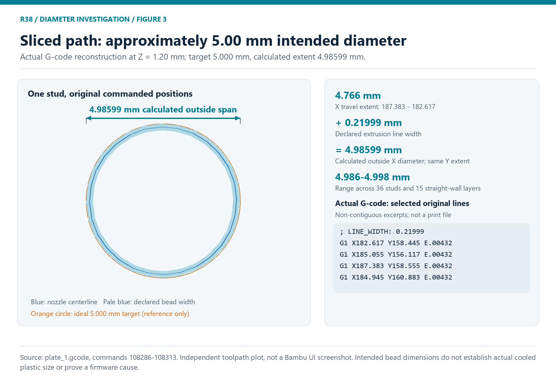

3. Actual sliced extrusion paths
This is an independent rendering of the actual G-code, not a simulated Bambu UI screenshot. All 36 studs x 15 straight-wall layers = 540 contours were checked. X/Y nozzle-centerline extents plus the declared bead width give 4.98599-4.99799 mm, approximately the 5.00 mm target. The bead width must be included: the nozzle centerline alone is intentionally inside the outside surface. The rounded crown is not used for the straight-wall measurement.

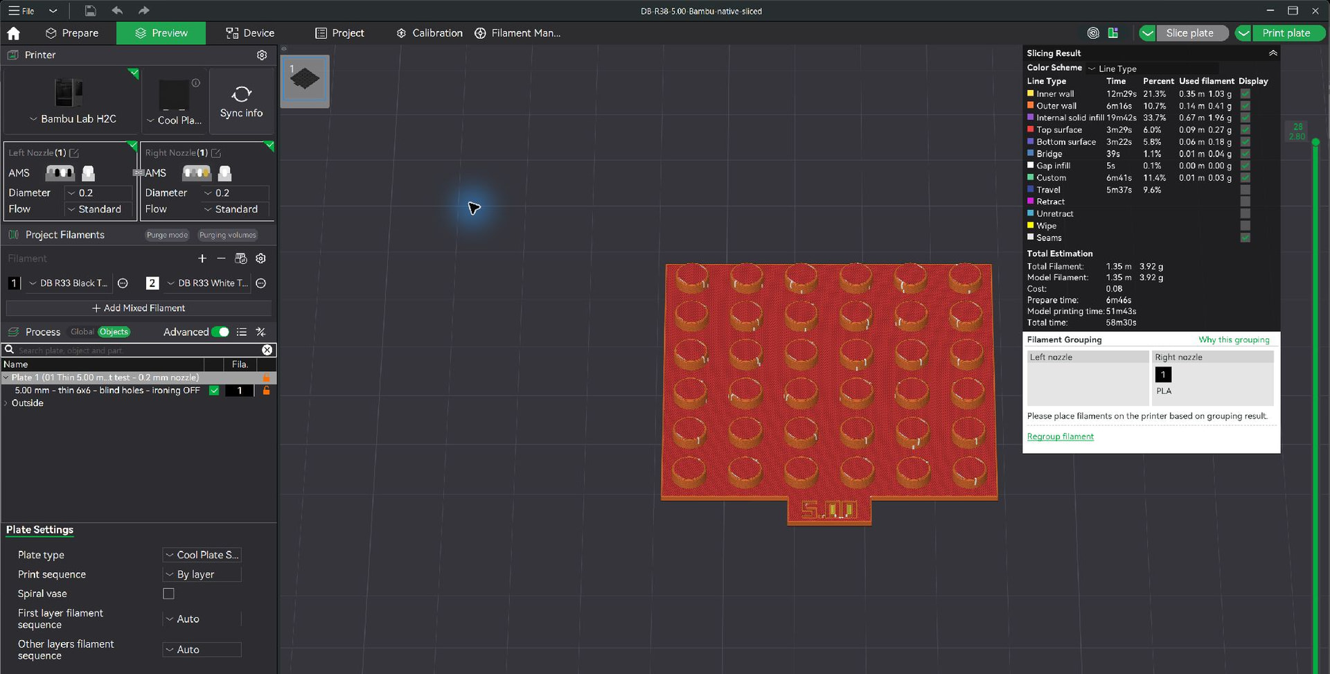

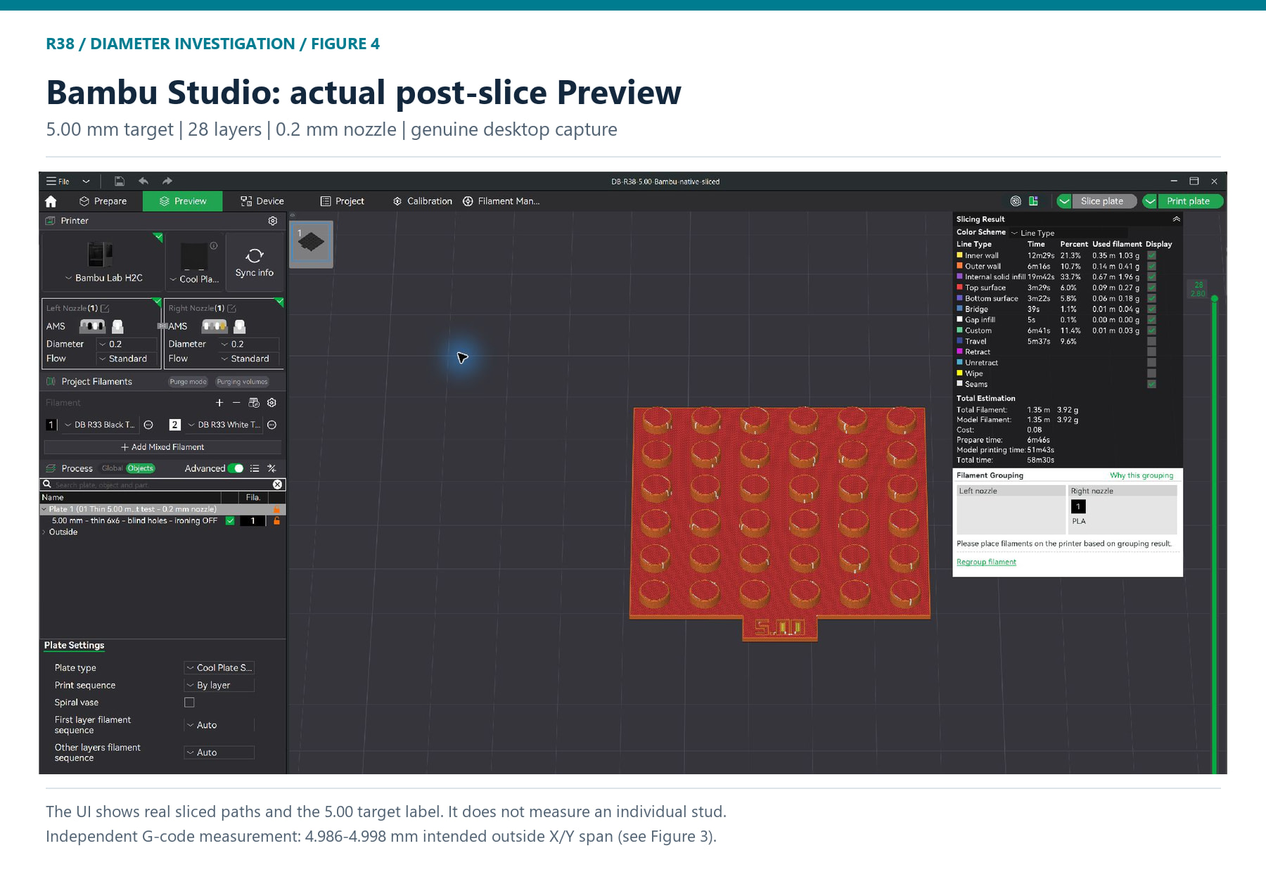

4. Native Bambu post-slice toolpath Preview
This is a genuine desktop capture of Bambu Studio’s Preview tab, showing Line Type colors and all 28 layers through Z2.80 mm. The native summary shows 58m30s / 3.92g. The previously saved sliced project was opened directly; no new slice or printer command was sent for this screenshot. Its 5.00 object name and engraved label identify the nominal design. Bambu’s Preview does not display a native individual-stud diameter measurement here; the separately verified mesh is 5.000 mm and its calculated G-code envelope is 4.986-4.998 mm. The caption does not pretend those measurements are a Bambu UI readout. The image is cropped only below the relevant application content to exclude an unrelated desktop notification; the unannotated application crop is included.

For this loop:
X nozzle-centerline span = 187.383 - 182.617 = 4.766 mm
Declared line width                          = 0.21999 mm
Intended outside X span                     = 4.98599 mm
Y nozzle-centerline span = 160.883 - 156.117 = 4.766 mm
Intended outside Y span                     = 4.98599 mm
The E values were also analyzed, not just X/Y positions. Summed commanded filament volume divided by the nominal non-bridge path volume is 0.980423, consistent with the saved 0.98 filament flow ratio to command rounding. This is a volume factor, not a 2% XY scale. The calculation uses the installed-version Bambu non-bridge extrusion-area formula: area = height * (width - height * (1 - pi/4)). An extrusion-width comment expresses intended deposition; it does not prove the cooled plastic attains that width.

  • Verified in the new reproduction: a 5.000 mm mesh persists through native Bambu re-export, and the emitted X/Y paths plus declared extrusion width remain about 4.986-4.998 mm. The artifact does not contain a 4.80 mm straight-wall target.
