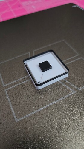

Hello! Since I do not have an AMS, I’ve been using the pause feature in Bambustudio to pause the print, then unload/load a new color in for some of my models. I noticed though that it would leave a little zit on the layer before the color switch.
I did some testing and for whatever reason, after unpausing the print, the printer tries to finish the last layer then immediately goes to the next layer. This is what’s causing the zit problem. I’m not sure if it’s a bug or not cuz using the slider below shows the nozzle is supposed to start the nozzle on the new layer.
I showcase this in the video and images below, any help would be greatly appreciated!
It basically returns to the same point it left off before the pause. I guess that’s the default behavior of Bambu Studio.
I can imagine that this is done for safety, so the code exactly continues from where it left off.
Only solution I see, is manually editing the gcode. But you need to be able to interpret the code before you start editing. Worst case scenario is that you crash the nozzle into something if you make the wrong edits.
Yeah it’s quite a bit silly, I wish it would just resume onto the next layer, I can’t imagine how it’s considered unsafe either.
The only solution I’ve been able to find is to duplicate the model and just use it as a sacrificial piece, but that seems unnecessarily wasteful. I wonder if this happens with an AMS?

It extrudes to the correct color; problem is after resuming the print, the nozzle starts at the end of the last layer then continues onto to the next. It’s a little bit hard to explain sorry if I’m not explaining correctly, that’s why I posted a video and some images lol

honestly it would probably require some manual gcode editing… wonder if its a thing in orca slicer. i’ll give it a whirl like you said and see what i can figure out (wondering if simply putting the pause one step further ahead might resolve this).
I tried turning down the temp, as well as using skirt someone had recommended on Reddit, and still the same issue; I’m starting to think it’s just the slicer messing up for whatever reason

Still having the same issue with Orca slicer, only setting I was able to find that I thought would help is under printer settings > multimaterial > manual filament change. I enabled it and tried printing it again but still having the same issue.

Unfortunate, seems like the only solutions I currently have are to just get an AMS or print out a sacrificial duplicate that’ll have the zit. Bambulab should really fix this, it’s unfair to users without an AMS. I made a github bug report, hopefully they reach back soon about this
