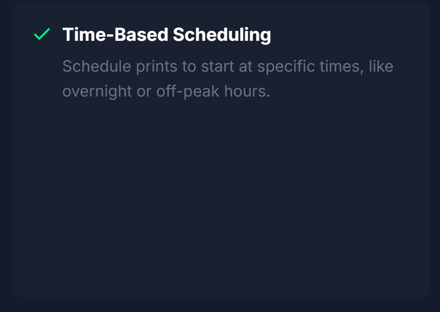

Option 1: Edit your gcode to add a pause at the beginning of the print for however long you want.
Option 2: Create a macro using AutoHotkey or similar application to click the “print” button after a predetermined amount of time
Oh, that would be so cool. I think if they implement this, it’s best handled by the printer itself. You can start prints from Studio, mobile or the printer itself. So only the printer is always involved.
Inserting the pause in the gcode to me seems the best method. Automated key press doesn’t work for me, other persons use the computer too.
Don’t know if the pause has side effects though. e.g. can you still cancel a print while a pause is active?
Is there an easier way to include custom gcode during slicing other than adjusting the machine gcode?
I think you’re alluding to the printer needing to complete the current command before it will action a stop?
I know output commands, like movements, fan changes, or temperature changes will only happen once the current command is complete. I honestly don’t know if a dwell can be overridden. I suspect the answer is “yes”, but in the worst case power cycle the machine.
And the easiest way to insert custom gcode is to slice the part, then drag the layer slider down to layer 1, right click it and select “insert custom G-code” , then you’ll want to do something like “G4 S10” which would be a 10 second pause prior to starting layer 1.
If you want the pause to be even earlier, you’ll need to manually edit to add it in.
I never heard of this bamboozled buddy thingie but I love what the link provided was claiming. Need to check out GitHub and get familiar with it. What a great piece of software. A trillion thanks for sharing. Appreciated.
Yes exactly. Maybe there is a gcode for “wait for user input with timeout”? But you are right, it’s not the end of the world if it is not interruptable. You could even insert a lot of 10 second pauses, so that interruption is delayed by at most 10 seconds.
