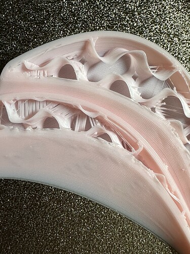

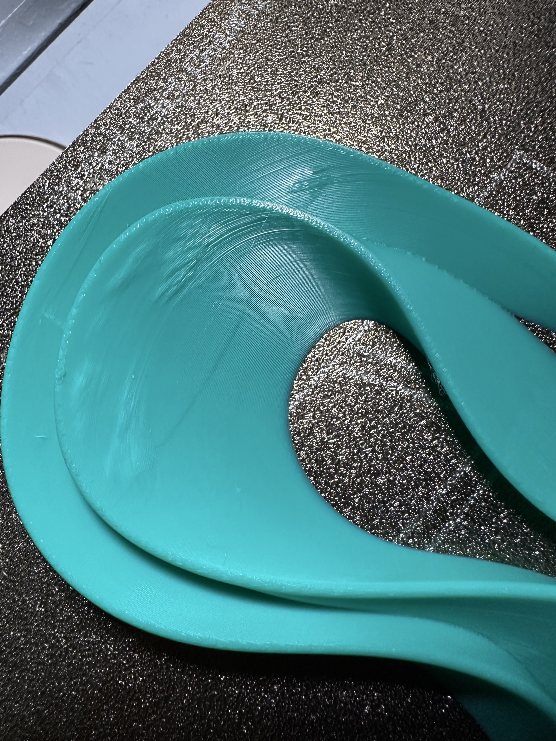

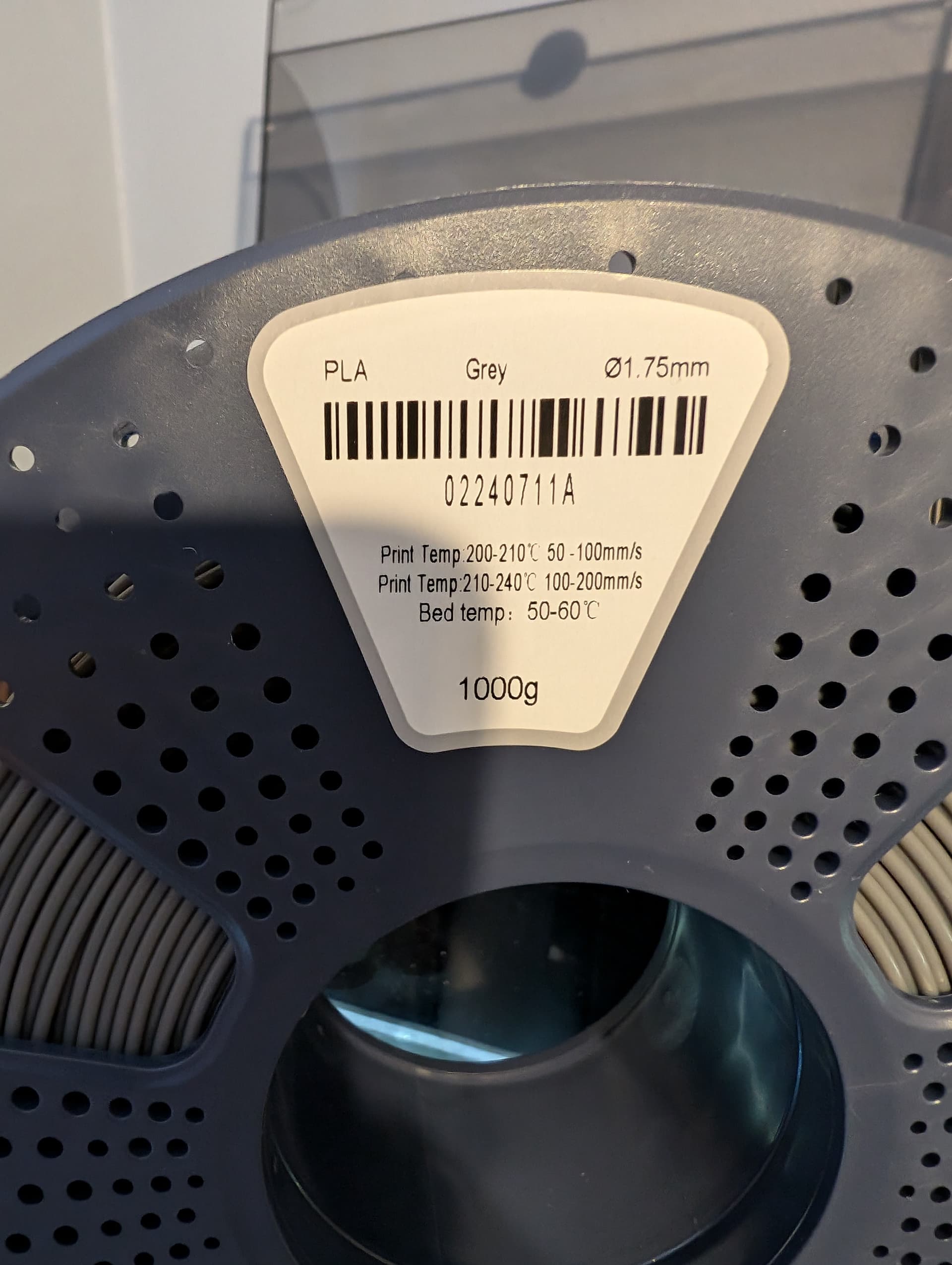

Should I stop using Sunlu filament? I’ve been using Sunlu filament since I first started 3D printing, with my A1 mini. Using the A1 doesn’t feel to be different. I end up printing the desired shape, but the print isnt smooth, I always have blobs or rough edges unless I switched to fuzzy skin to hide the imperfections. It feels like no matter how much I try. I can’t get that perfect print. I chose Sunlu because it was praised on, but also because it was cheaper than bamboo’s original. So, no matter what I use wether is PLA or PETG or TPU Or PLA silk, every Print has an issue. True, my printers don’t have the factory settings as I had to adjust the print beds on both. I am living in a part of Europe that’s doesn’t make it easy or quick to receive new filament, But at this point, I don’t have anything else to do.
So I’m asking you guys is it something related to my printers or is it something to do with the filament itself?
A1 - 2 walls 8% Gyroid PLA 215/55 texture pei
A1 mini - 3 walls 8% Support cubic PLA 215/55 texture pei
Are you printing at the speed set by the manufacturer? Sunlu is a good brand.
I think your problem with those prints is not the filament but the slicer settings. 8% is very low infill setting. you need quite some top layers to achieve a clean top surfaces, especially with those just slightly slanted top surface. How many top layers do you use?
I’ve got some Sunlu PLA and PLA+ 2.0. If either of those models is something you can share I’ll give it a shot on the X1C with your settings to start narrowing things down.

4 top 4 bottom.
printing a 15 percent on the mini now
and 25 on A1
Gotcha! .4 nozzle?

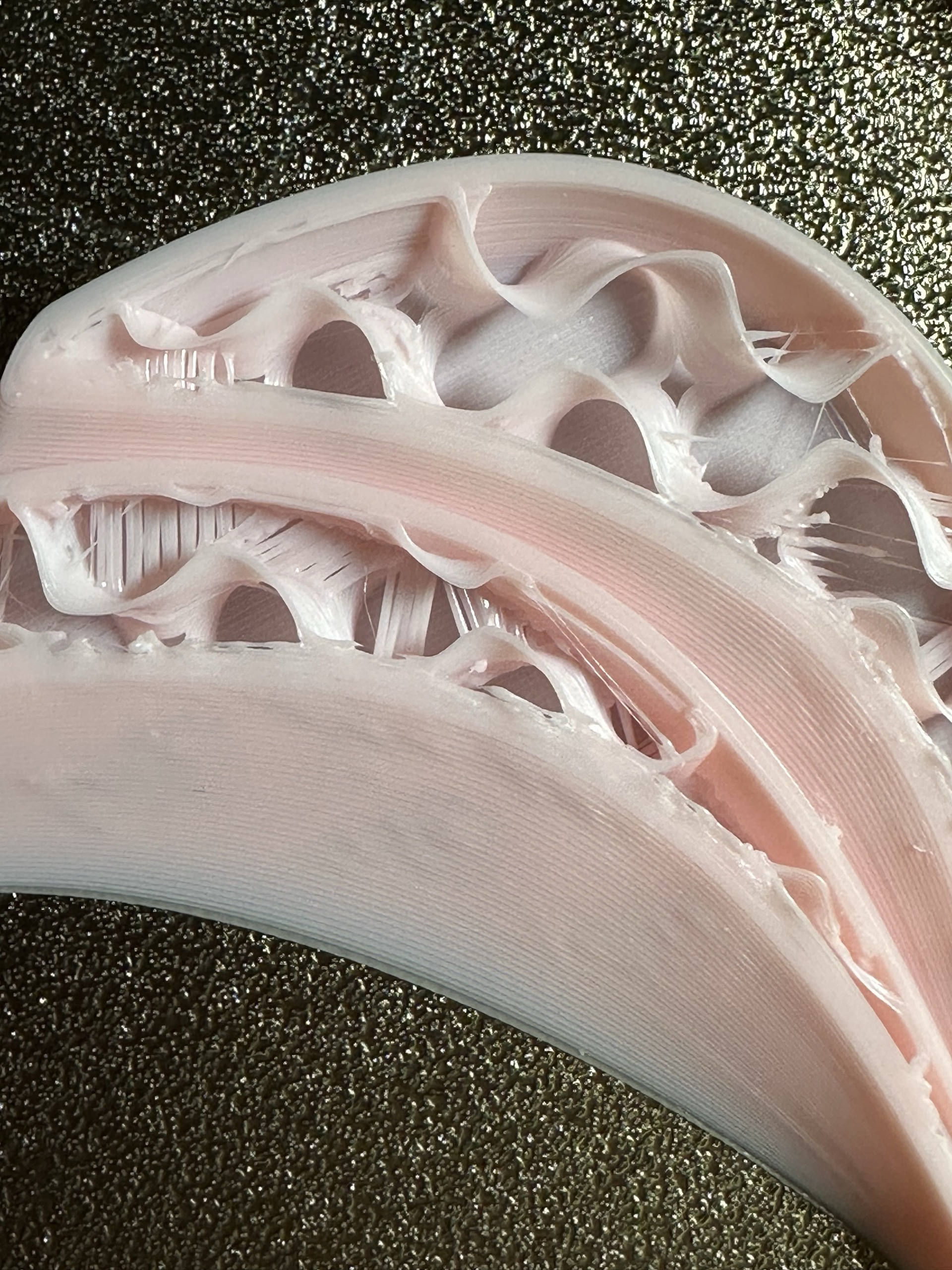

That surface texture and stringing kind of suggests moisture content in your filament to me but might be wrong on that.
Are you drying? How?
you might be right with the infill…

Im not drying my filament yet, but that is pla, basic…
Yeah, stock. On both printers
My default is 5 top layers with 15% infill. If I would print 8% infill, I would increase to 6 or 7 top layers.
I think those internal strings are normal. As you can’t see the infill later, the Slicer omits the retraction when travelling to increase speed and reduce load and wear on the feeder.

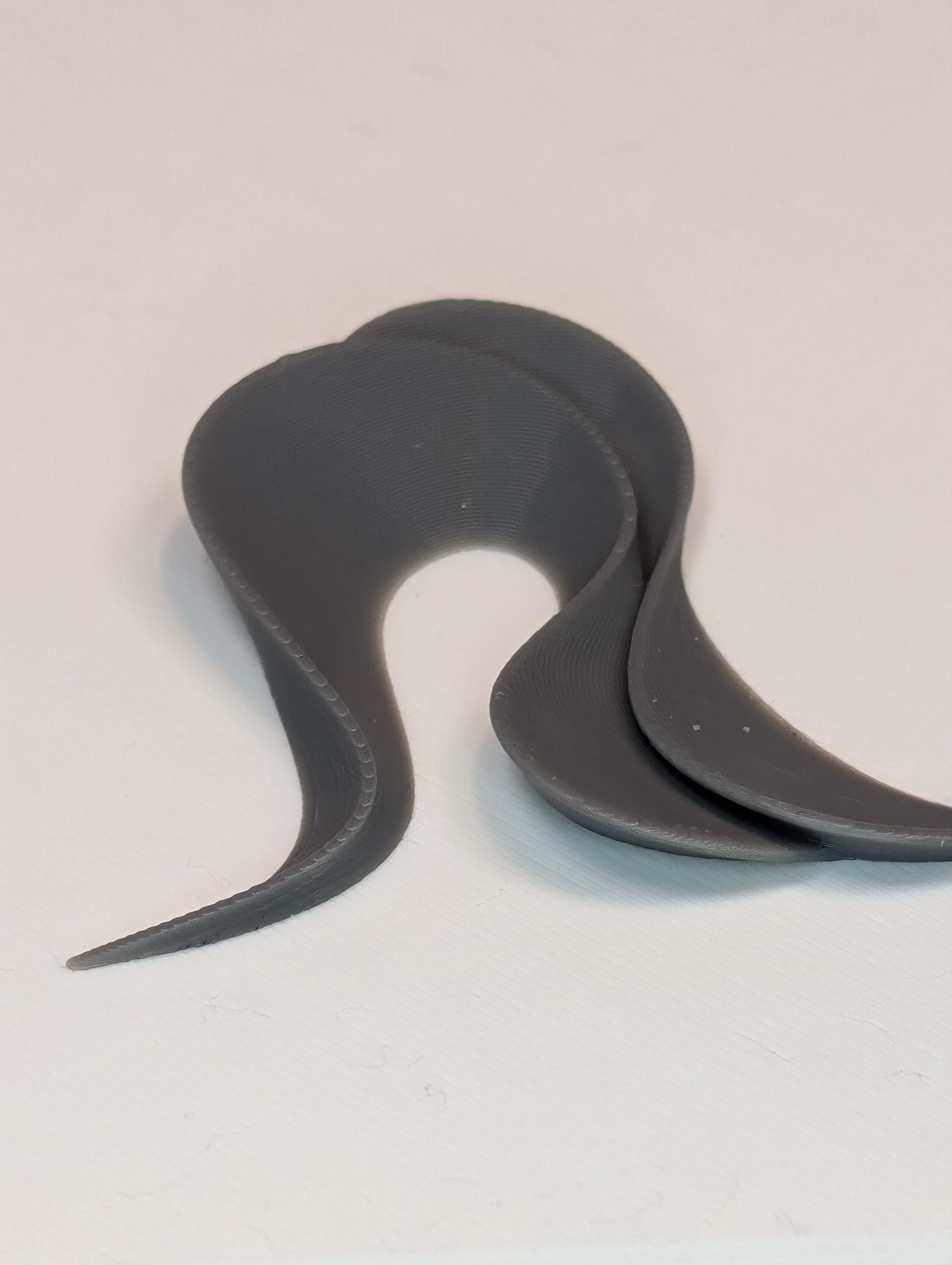

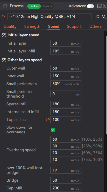

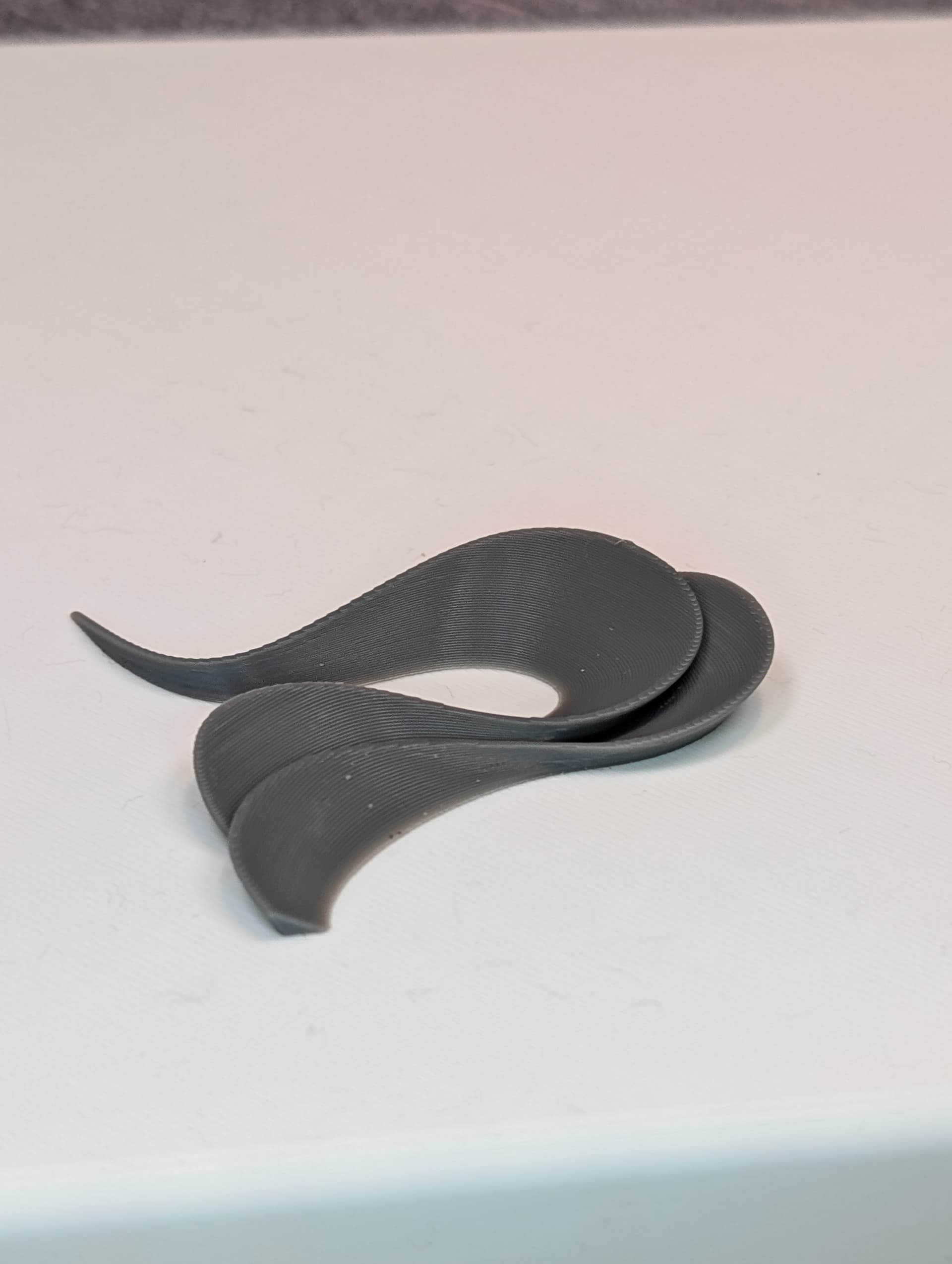

So here’s the basic Sunlu PLA on an X1C, 4 top layers, 4 bottom layers and 15% infill, with a .4 nozzle. Using the .12mm high quality profile.
So I think you can take the brand out of the equation. It’s got to be moisture or settings (or both).

I hear you friend :heart_hands: 15% just finished on the A1 mini and it looks the same ( more or less )
So definitely the settings.
