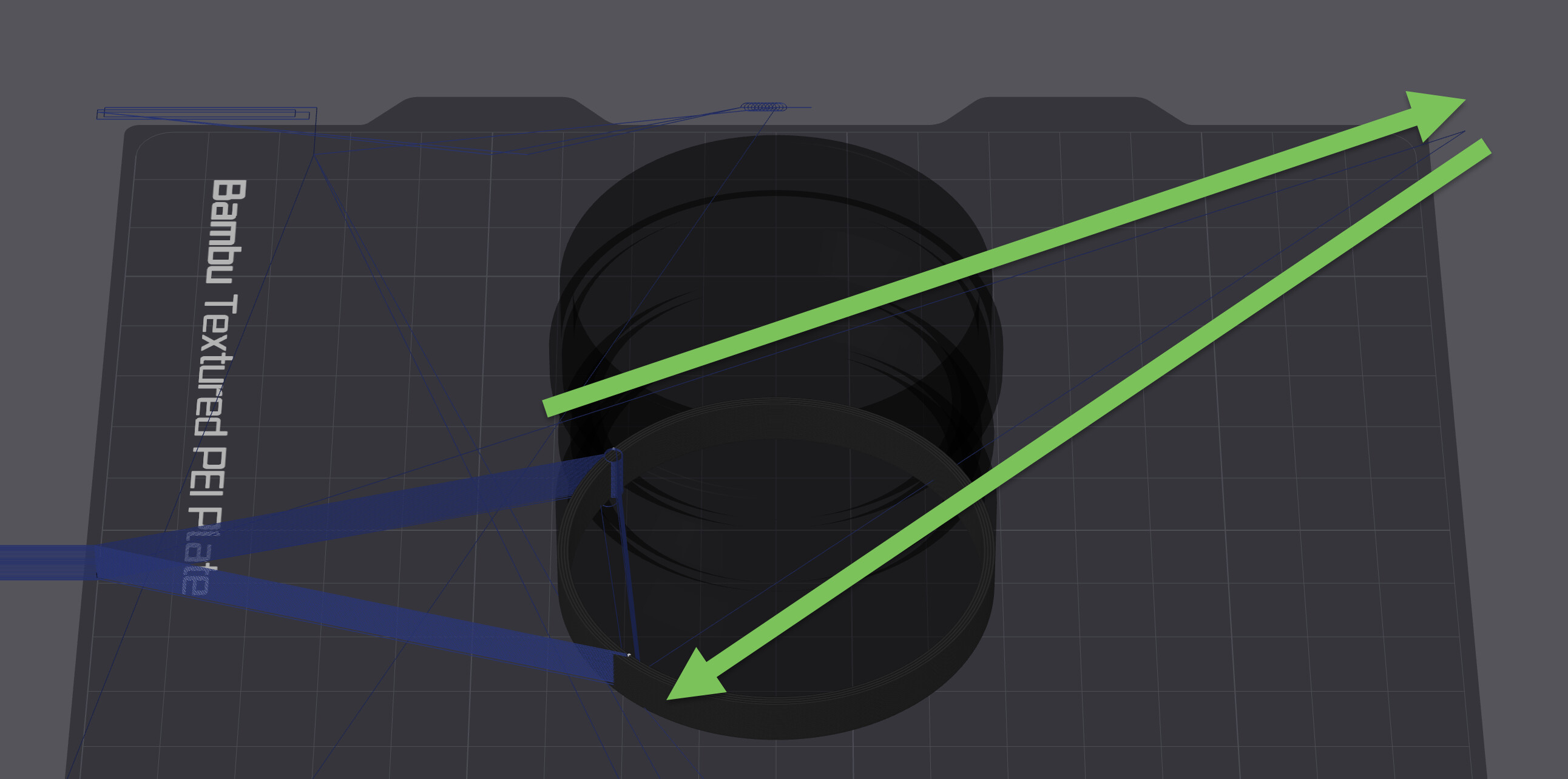

I am slicing a print in TPU and for some reason on layer 3, and only layer 3, the slicer is sending the print head over by the camera.
I am not sure what setting is causing this or why it’s doing it. I’ve added green arrows to this image to make it more obvious [as the dark blue lines are kind of hard to see].
It would be great if I could turn off whatever is causing this to happen as it’s causing a print defect on layer 3.

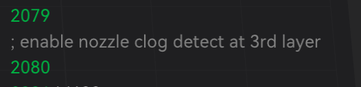

Found it in the gcode, but I have this off… Frustrating.
It is the slicer injecting it, and I can’t seem to turn it off in Bambu Studio unless I’m blind.
Found it.
