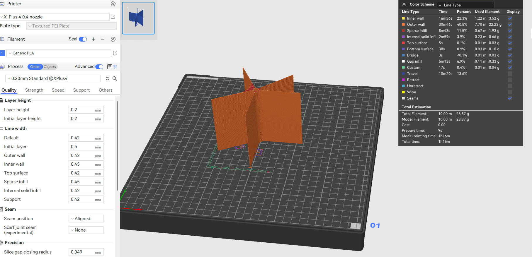

@StreetSports Since there isn’t yet an orca slicer profile for the Qidi Plus 4, are you relying on the Plus 3 profile to do your slicing, or have you found some other way?
What am I saying? I suppose you’re using the Qidi slicer. Of course.
I’ve gotten in the habit of using Orca slicer for everything, across all different machines, which is what threw me off. So much so that I’ve disqualified machines from consideration if they don’t have a presence in Orca Slicer. I guess you could say I’m ā€œall inā€ on Orca Slicer.
Still larger, but disappointing
@NeverDie Using the qidislicer which lacks some of the calibrations like vfa. I assumed someone would have posted the needed files for orcaslicer on guthub but havnt seen any yet.
Im running one last comparison on both now. The orca vfa tower.
@StreetSports Bummer. I guess the most you could do then, if you wanted to that is, would be to download the VFA model from printables and then either:
  1. Cut down the height and run prints at different speeds, or
  2. Manually change the gcode to change speed at different heights, like the Orca Slicer calibration does it.
Since that’s a lot to ask of anyone–unless they wanted to anyway–I wouldn’t blame you if you decide to wait. It sounds as though you have the skills to do it, though, if you choose to. I’m in no rush, so I’m good either way.
@NeverDie
Would it work if I just ran them both at a high flow rate and speed? To see the extremes?
I honestly don’t know. I’m aware of VFA’s, but that’s about it. Maybe someone who knows something substantive about VFA’s can chime in and post advice in that regard? If not, we could ask in one of the threads that’s focused on VFA’s, who may be unaware of this thread, and see if they might have ideas.
Judging from how the orca slicer VFA test is constructed, it varies speed over a range, so (purely guessing) it may be hit or miss whether one of the extremes will coincide with peak VFA production. However, I’d wager that peak production happens somewhere in the middle and that the extremes are meant to bound that. At least, if I were designing a test, that’s how I’d do it, and it seems like a reasonable approach to zero in on the best speed for the worst VFA’s.

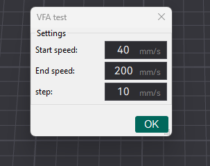

OK, I just now thought of a quick and dirty test: just print it at whatever speed the slicer defaults to, because that’s the speed you’re most interested in anyway. It’s not a complete test, but it’s still meaningful.
@Nebur Using Qidi Studio, which is more advanced than Qidi Slicer, it looks as though that will work. So that we don’t need to do this more than once: from your experience, do you recommend sticking with the default VFA settings presented in orca slicer vfa calibration?
Screenshot 2024-09-27 202313
If so, I get the gist of how to do it. It boils down to 17 different layers, each 5mm tall, starting at 40mm/sec speed and ending at 200mm/s speed, such that each layer is 10mm/s faster than the one just below it. I could setup the project in Qidi Studio for the Plus 4 and upload it here for @StreetSports to try printing.
@StreetSports Assuming you’re onboard for that, what filament do you want me to bake into the project?
@NeverDie
petg-hf. Will give me a reason to test it.
