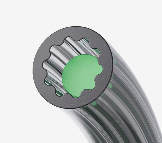

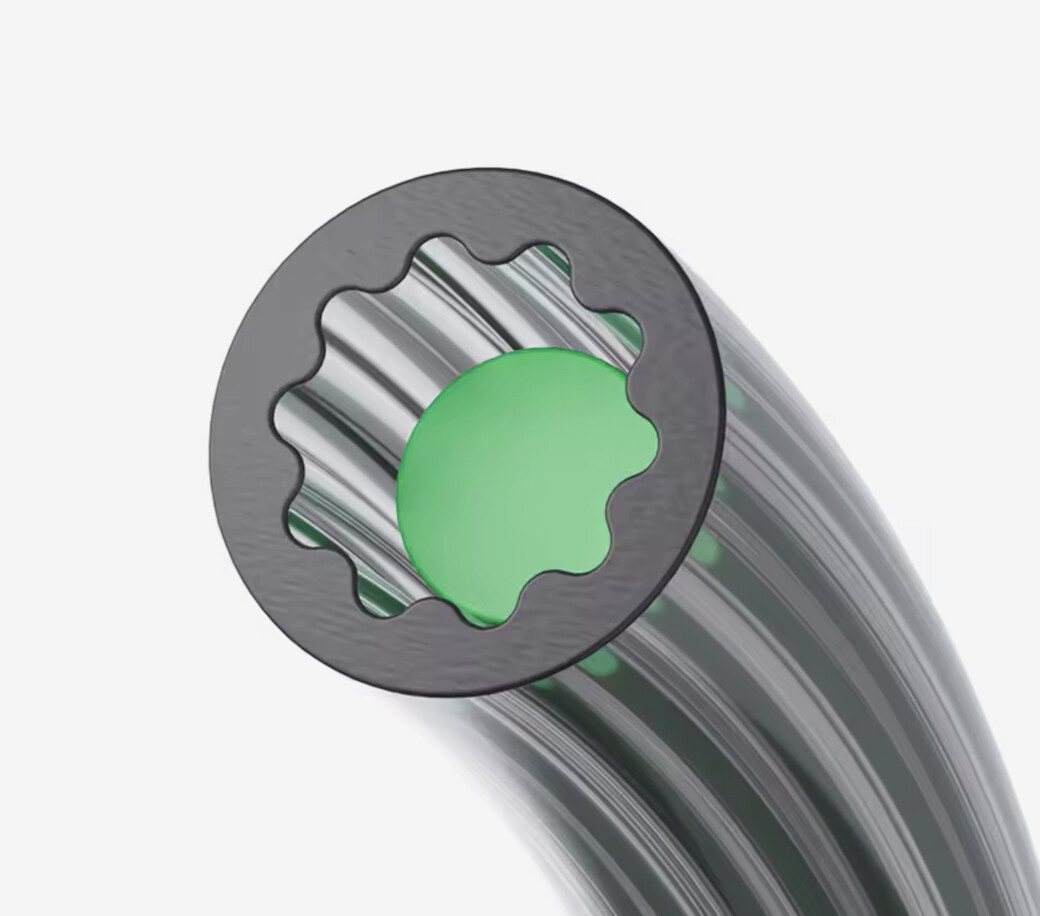

I got some of the recently released star shaped PTFE tubes from Creality. I was hoping it would reduce the drag when loading TPU from external spool. I was also hoping AMS HT would finally be able to load PPA and PPS without me manually working the buffer to “assist” it. Well … with both TPU and PPA it feels like there is more drag on the filament. AMT HT could not load PPA even with me working the buffer by hand to assist it.
TLDR: Dont waste your money on this. I guess that is the reason Bambu tested it but never released it.

What did you expect?
TPU is stretchable and will inevitably get between the “bumps” of the star shape, which only increases drag instead of reducing it.
And you definitely should not try loading PPA through the buffer — it simply won’t work properly. The bypass is the correct way to handle that. On top of that, PPA will wear down the star shape, likely unevenly, which will make it even worse once you switch back to TPU.
I run PTFE Tough and it works perfectly — zero issues, smooth as if it were lubricated
Maybe you are not aware but Bambu were testing this design and sent it (by mistake) to Stefan from CNC kitchen. I believe Tao said in an interview later on that it was to improve TPU feeding. I figure I would give it a try, perhaps when pushed it has more resistance, but when being puled its reduced. Ill test this with some 90A TPU when I have time, but for the AMS and hot end PTFE tubes its back to standard ones for now.

About the star-shaped PTFE: sure, in theory the reduced contact surface should lower friction, that’s obvious. But if the dimensions are even slightly off it might have the opposite effect. And uneven wear of the star shape will cause bigger problems in the long run than a smooth round tube ever would. Personally, I’d stay away from it.

Thanks for posting your experience! I wonder if the distance between the high points is actually less than straight wall, making the tube relative ID slightly smaller? Also, does this tubing seem stiffer to you compared to straight wall? Maybe less of a bend radius?
I measured the star shape is right around 1.85mm, so yes its tighter. Its about the same stiffness, I did not notice a difference.
Like I said before I suspect its got less friction when pulling filament though it, but not pushing. Maybe the tubes will be useful for 85A to allow feeding from external spool without removing the lid, although loading filament will be more difficult.
Bambu’s official PTFE is actually looser — 2.5 mm ID vs. the 1.9–2.0 mm ID you often see with Capricorn. So at ~1.85 mm, the star-shaped tube is definitely much tighter than both.

I think that it would increase drag instead of reducing it. If the filament sit on the groove, it would have 2 points of contact with the tube ILO 1

That’s not how friction works. Reducing the contact points only makes the drag higher on what’s left. Simple physics.
That’s a misunderstanding of how friction works.
For polymers sliding in PTFE tubes, the friction is mainly governed by the contact surface geometry and the normal force per unit area – not just by the number of contact points.
A star-shaped inner bore reduces the actual contact area between the filament and the tube. Instead of a full 360° surface press, the filament only touches along several narrow ridges. The spaces in between lower the total real contact area, which reduces adhesion friction and gives air gaps that reduce stiction when the filament bends. This is the same principle used in certain low-friction bushings and cable liners.
If fewer contact points automatically meant higher drag, ball bearings wouldn’t work. But in reality, bearings reduce contact to small rolling points, lowering resistance dramatically compared to flat sliding surfaces. Similarly, the star profile trades continuous sliding contact for controlled line contacts, lowering average drag under normal feed forces.
So, the star shape does not increase friction – it lowers it – by decreasing continuous surface adhesion and spreading the load across smaller, well-defined regions.
I didn’t say it increased friction. It stays the same.
You should check Amonton’s laws on friction: “The first law of friction states that the force of friction is proportional to the normal load pressing the surfaces together, and the second law states that it is independent of the apparent area of contact.”
You can’t compare this to ball bearings because they use rolling friction instead of sliding friction.
Amonton’s laws are valid for idealized dry friction between rigid, flat surfaces — not for polymer-on-polymer sliding inside a PTFE guide tube. Filament transport is dominated by real contact area, surface adhesion, and deformation of the polymer, which those 17th-century laws don’t account for.
That’s exactly why star-shaped liners exist: they reduce continuous contact, minimize stiction, and lower drag compared to full-bore tubes. If Amonton’s laws told the full story, lubricants, textured liners, and even polymer bushings wouldn’t show measurable reductions in drag — yet in practice, they clearly do.
And yes, ball bearings are a valid analogy. The principle is reducing continuous surface contact to controlled points or lines to lower resistance. Whether it’s rolling or sliding, the fact remains: less effective contact area, managed correctly, reduces drag.
So quoting Amonton’s laws without context oversimplifies the physics and ignores why these geometries are engineered the way they are.
Star shaped bushings reduce friction in rigid materials such as steel. Problem is with tpu, it takes the shape of star shaped tube and instead of reducing, it will increase contact surface.
