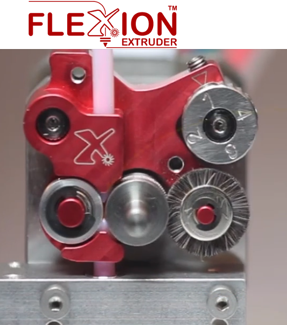

interesting! maybe we can make a wiper type like the extruders of TPU once haad!
https://www.3printr.com/flexion-extruder-perfect-extruder-flexible-filament-5041341/
