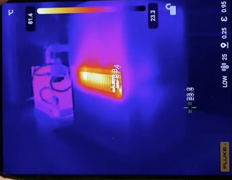

Looks like 80C at the outlet

Wow. Far lower than I would have guessed, and even below the “prolonged heat exposure” range for fire risk, so it handles that as well.
I certainly don’t know for certain, but I think it might be better to just open the cabinet door with the unit unplugged. That way you aren’t cycling the sieves (no idea how much that might even matter though).
At my typical humidity (40-45% RH) that would load the sieves to a bit over 20% w/w if they follow the graph I posted above in the thread. At 10% RH it’s about 15% weight/weight so it would be well in the working range. I wouldn’t plug it but use another hygrometer to monitor the humidity. When it can hold close to ambient humidity with the door closed the sieves are probably nicely loaded up.
Then when you plug it in it will start cycling and you can watch how the humidity comes down from a good load.

Well, then, @krellboy 's post explains it. It put to the questioin to grok what would happen if I blasted air from a hot air gun into a column of 3A at 80C and then transferred the sieves into a sealed container what the RH in the sealed container would equilibrate to at 20C ambient temperature, and the answer was 11-12%. If increased to 85C, then 10%. In both cases, it assumes that all the beads were uniformly heated to the given temperature.
It also confirmed the benefit of the air blast. If it were instead a thin layer in a vented oven (i.e. extracted moisture allowed to escape), then 85C drying temperature would translate to 12-15%RH, and if in a heap on the floor of the vented oven while baked for a few hours, 15-20% RH.
So, if @krellboy 's measurement is accurate, and it’s only around 80C, then 10% might require some luck, depending on how accurate Grok is in its calculatons.
[Edit: That’s the headline. There’s more to it though, depending on the exact composition of the 3A, as well as the RH of the makeup air used for the heated drying. So, it’s possible it could be less than 10%RH. And it also had suggestion for a more reliable way of estimating RH based on weight of absorbed water into the dry beads instead of what it considered less accurate RH sensors, but that’s a different topic for a different day.]
[Edit2: Chatgpt reviewed the work and added a bit more color to the question of 3A source by noting “UOP and Grace-Davison beads behaved appreciably differently, and binder/cation composition matters” in the scenario I put forth. In short, not all 3A beads will behave alike. Some could perform much better, resulting in a low digits RH% for the same scenario. From sunlu’s literature, I guess Sunlu didn’t pick that one, but if we ever did a swap-out on the beads, maybe we’d want to upgrade and enjoy the benefits.]
