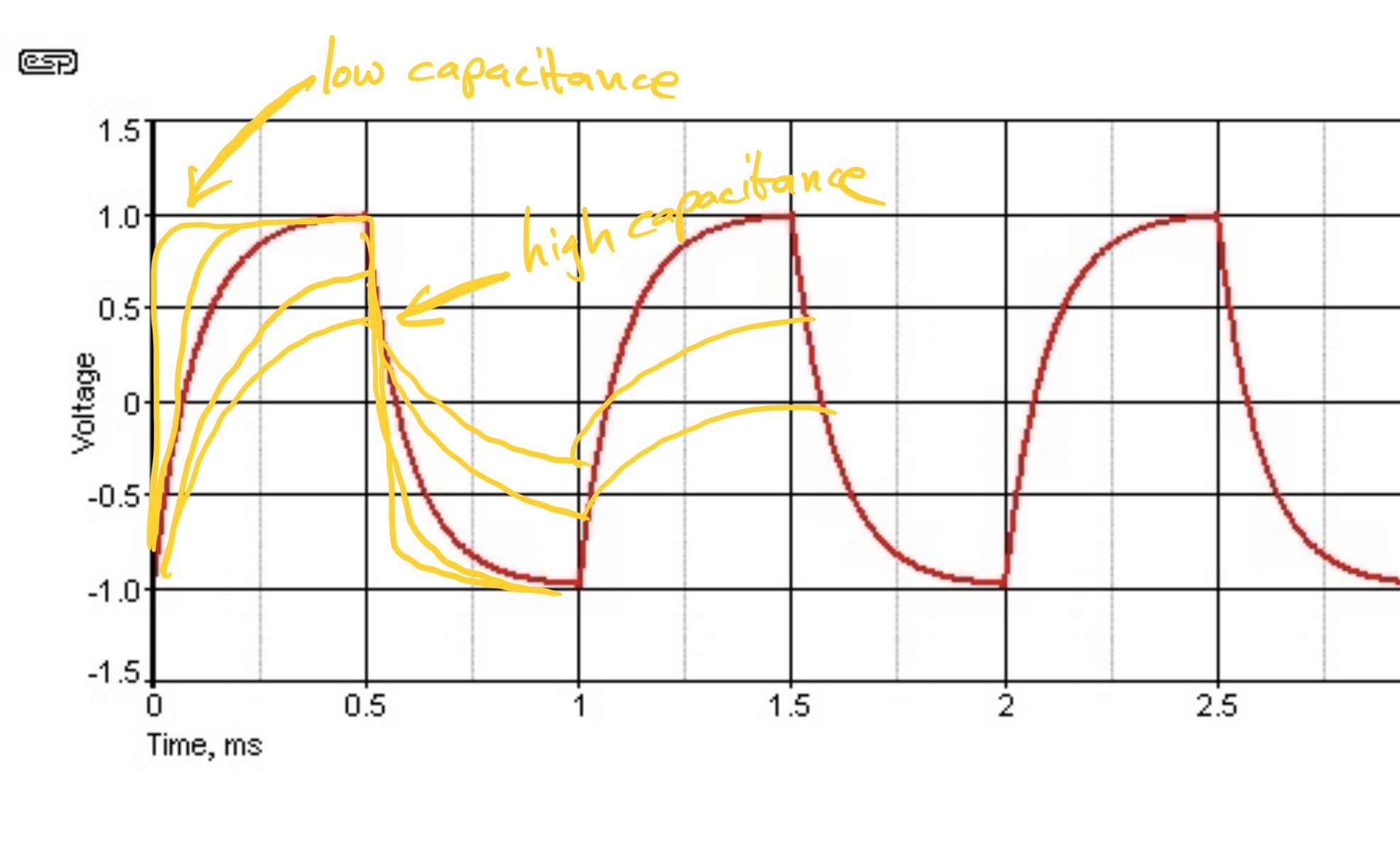

But it would be very analogous to putting a capacitor on a circuit with a square wave signal. I was looking for a good diagram that shows what happens to the highs and lows of a square wave as capacitance increases but not finding any that wouldn’t be confusing. Eventually, with a big enough capacitor, the square wave just turns into an average value without highs or lows with the average value being between the peak and the minimum.
This is the best I can find but had to add rough profiles for different amounts of capacitance. But what happens is the capacitance rolls off the leading edge more and more which is the bonus. The peak height (humidity) will eventually be lower as capacitance increases. That’s the water buffer aspects which is good. The problem comes at the lows. That same roll-off of the highs pulls up the lows which means the cabinet can’t reach the same low humidity.
Since it’s humidity difference between source and sink that drives the water movement, lifting the low humidity will slow water removal.
In the graph, voltage is analogous to humidity and capacitance is how much desiccant is added with more capacitance standing in for more desiccant. The average value will be a weighted average since the humidity profile isn’t a square wave but is a low duty cycle ‘square” wave.
I don’t know how understandable this stuff is but these kinds of effects and phenomena are found in many different systems since the driving forces all tend to behave very similarly. Electrical circuit analogies are very commonly used to describe all sorts of other physical processes.

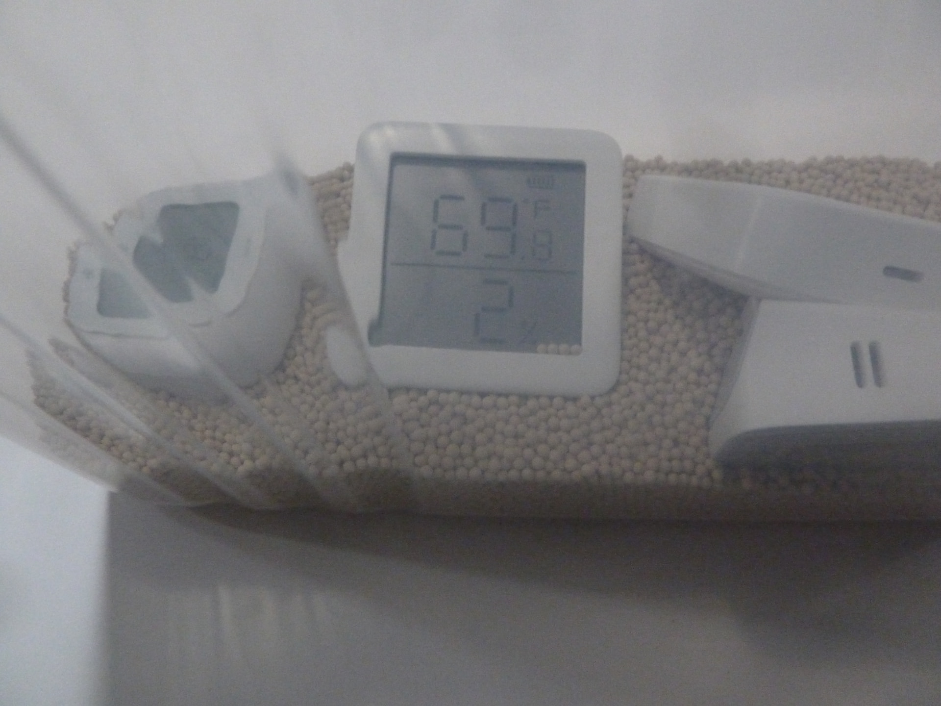

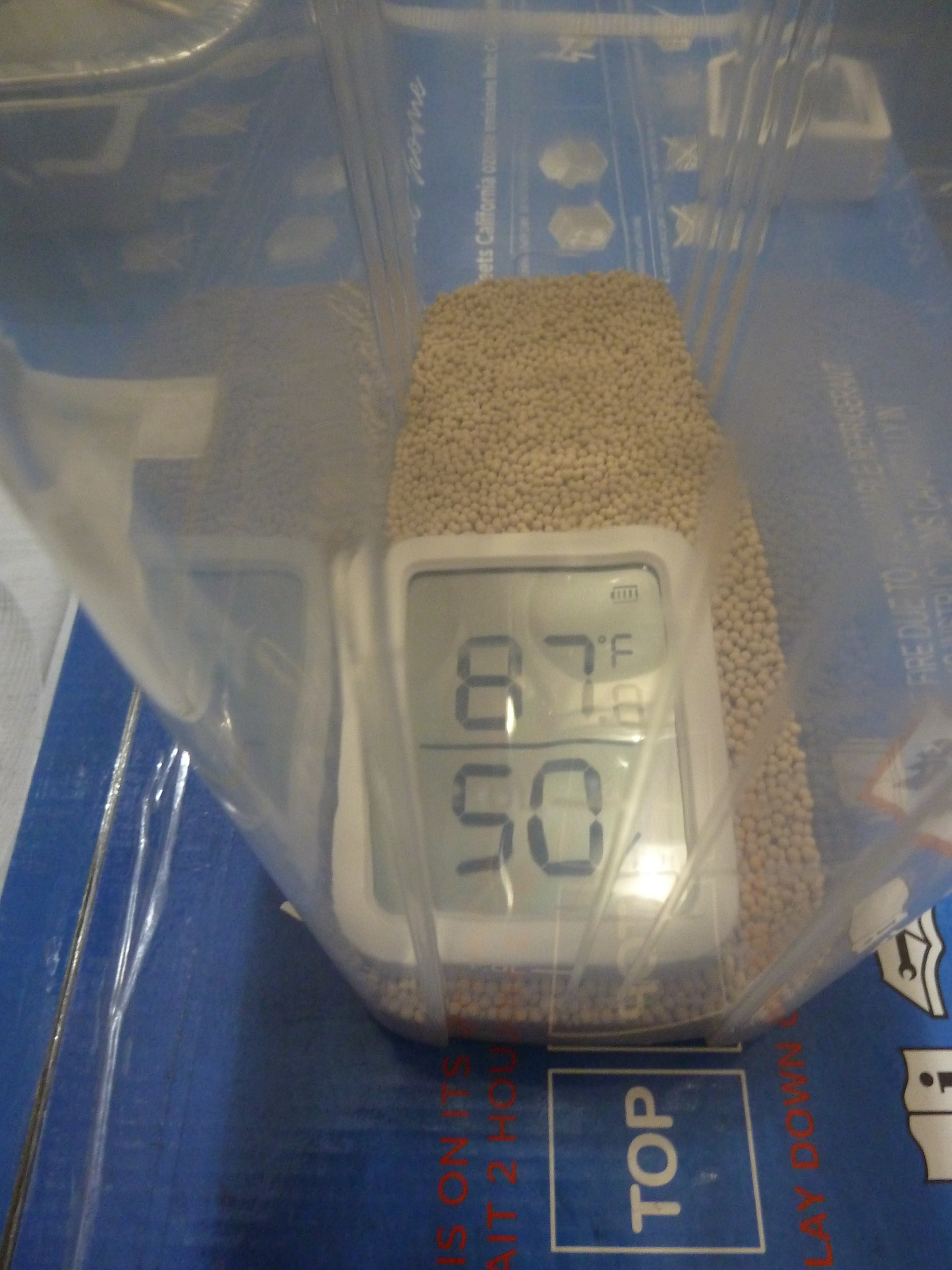

Continuing from the last photo, which showed the molecular sieves in a sealed cereal container maintaining 2%RH (see above).

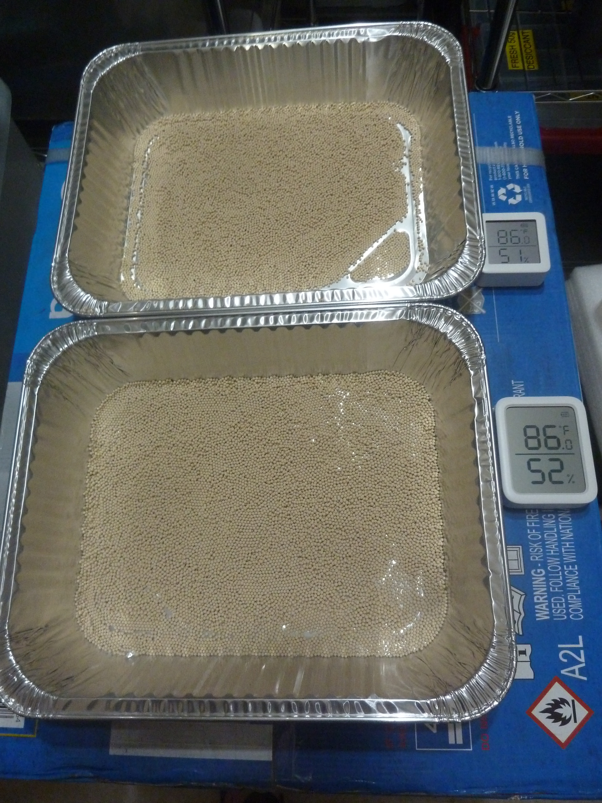

I empied the sieves onto two pans, each in a thin layer, and let them sit in my garage overnight and through the morning:

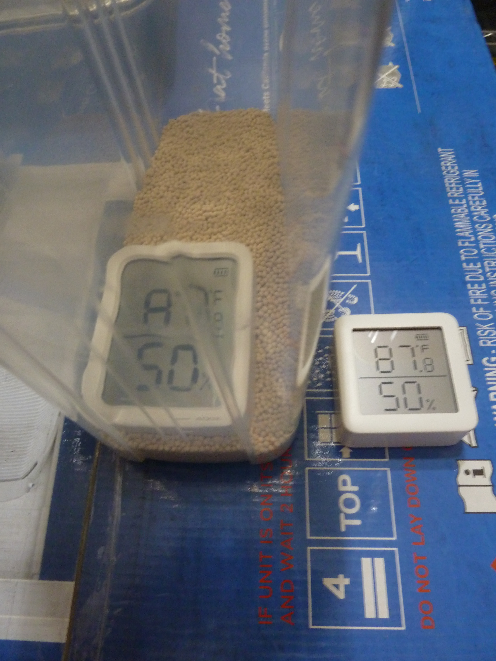

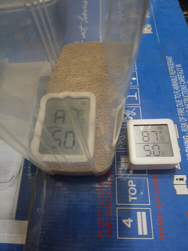

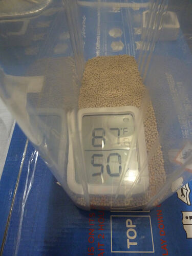

Then this afternoon I dumped them back into the same cereal container as before, sealed, and let it equilibrate. Here it is after equilibrating:
It matches ambient garage relative humidity. Therefore, it’s as saturated as it can get in this garage environment. No need to humidity soak it any further:

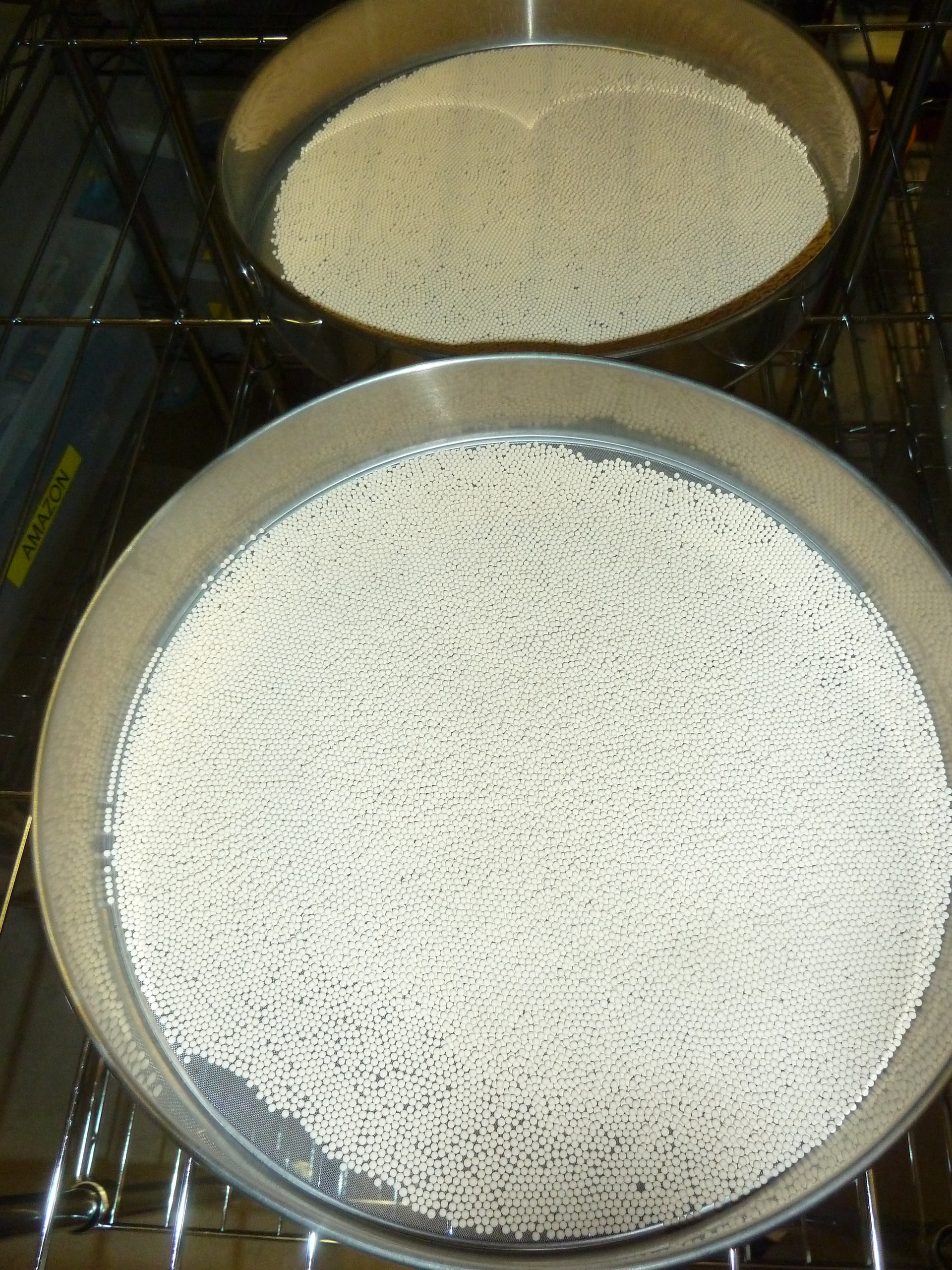

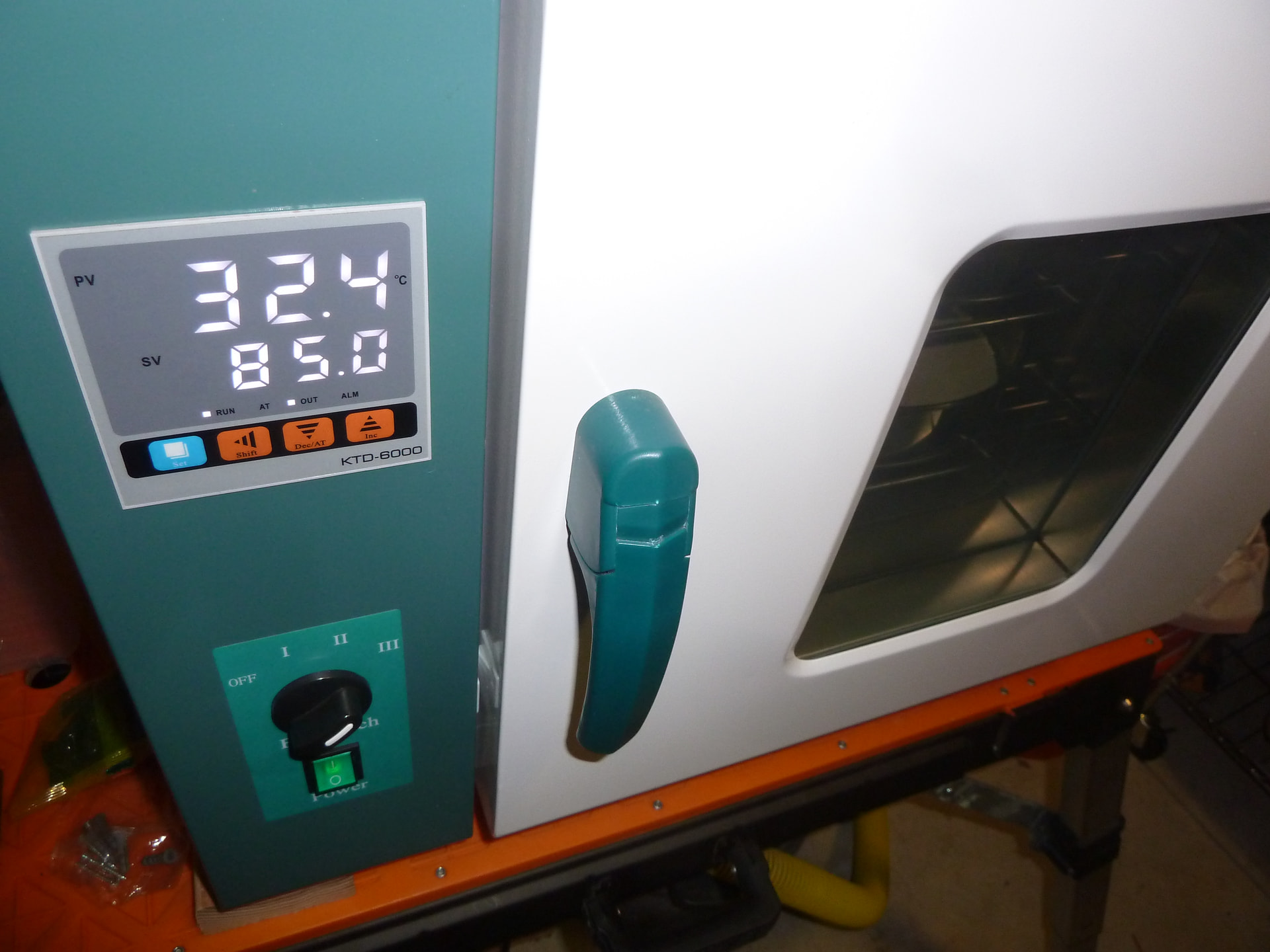

Next I poured it onto two flour sifter sieves, each with a “thin layer” of the sieves:

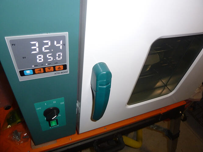

And put them in my blast oven:
Which I set to 85C:
whereupon it began it’s temperature climb.
How long should I run it for? I can cut it off at any time, but unless anyone here has a preference, I’ll terminate the 85C bake in about 2 hours, emtpy into a sealed 2 steel wall thermos vessle for it to cool off, and then pour back into the same cereal container as before, seal with the switchbot TH sensor inside, and let it equilibrate.
Question: Based on the discussion here, what RH do you predict it will have once it equilibrates inside the seealed cereal container? @Alex_vG ? @MZip ? @krellboy ? Anyone? Anyone? Buehler? Anyone?
I’ll snap a photo and post the result.
I think it would be interesting to run it at 80C, matching the photo above for 20 mins and see what happens. I’m not familiar with molecular sieves, and I have no dog in this fight but 80C for 20 mins should/might mimic the FilaDC’s performance. My guess would be hopefully less than 5%?

If you are trying to simulate the performance of the dehumidifier, by drying for 2 hours you probably got them way drier than the dehumidifier regeneration cycle does so I would expect a lower humidity when it cools. The time alone keeps this from being a fair comparison or analogue of the cabinet dehumidifier cycle.
You should regenerate the sieves for the same time and temperature as the cabinet dehumidifier since both of those materially affect dryness with any desiccant. Dry it longer and it will hit lower humidity. Cook it cooler and that will cause higher humidity.
The regeneration time is only a few minutes going by memory. I think all bets are off but if Krellboy’s temperature accurately reflects bead temperature I’d say below 10% but no idea how far below.
Another issue just to be aware of is you were careful to lay out monolayers of beads. If they are in a box-like configuration in the dehydrator that will likely skew results too. Plus the air circulation aspects probably introduce another difference.
If trying to simulate the performance of the cabinet dehydrator you need to match everything that matters where possible or else you’re testing something different that has less predictive value for the cabinet. You want to keep things you can’t approximate in mind when interpreting the results. And you want to minimize the number of differences. Depending on what differences you have, you can introduce positive and negative deviations that you don’t know magnitudes of and they may even cancel. Every unknown and difference steals the utility of a simulation.
