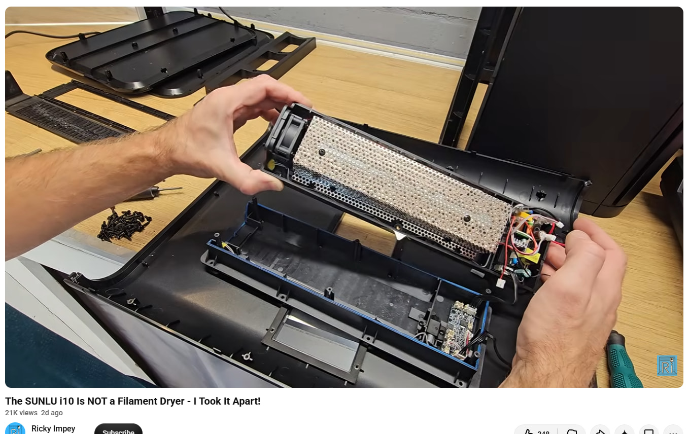

Did you guys see this? https://www.youtube.com/watch?v=PeMeoEEq3VQ
It’s a bit hard to follow this thread, so apologies if it was discussed.
Nice!
Bigger than I thought. I was afraid it might be tiny, more resembling the size of Bambulab’s itty-bitty dinky desiccant packs.

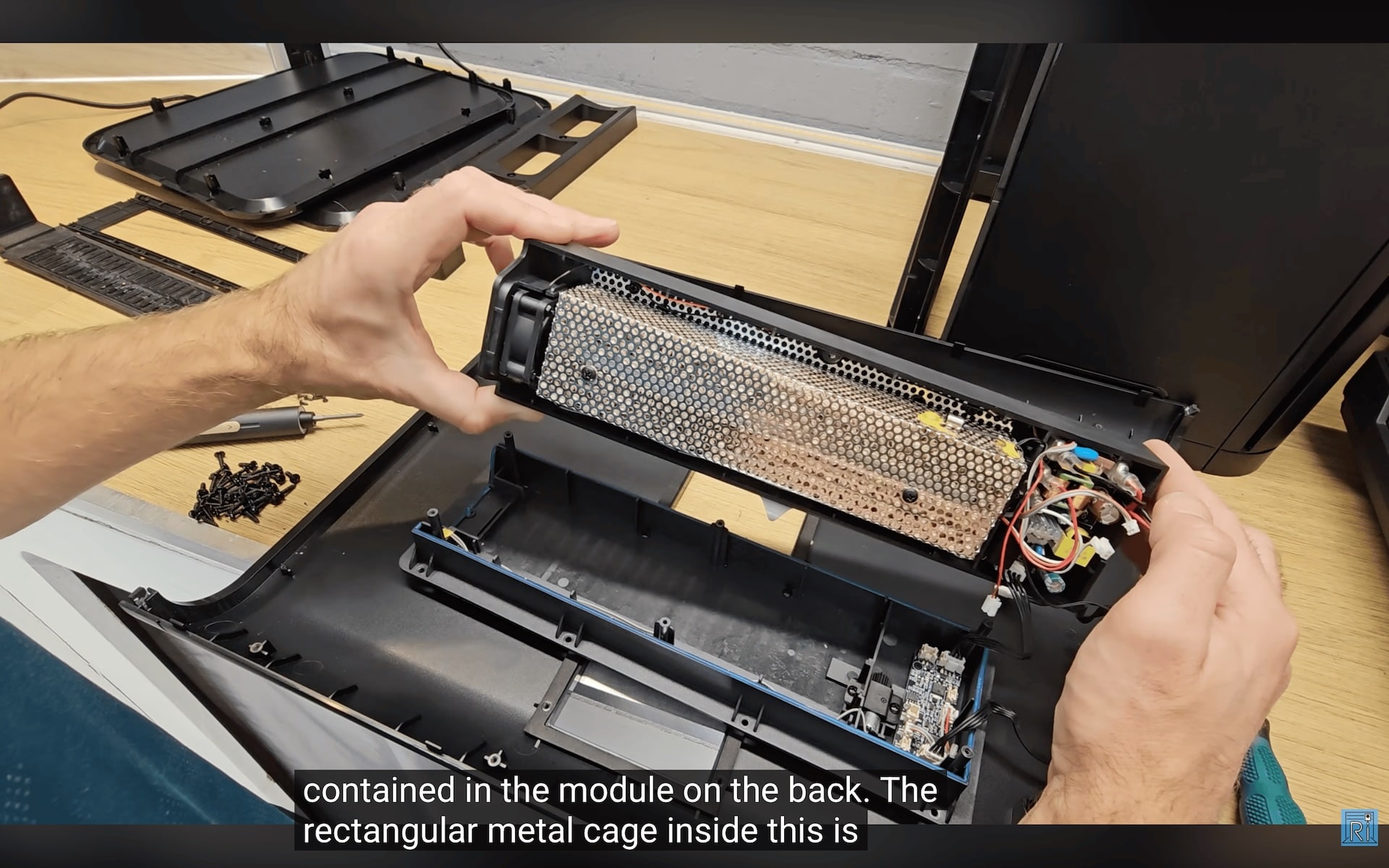

Great find! Check out this screen grab:
Check it out. I think what we are looking at here is an axial fan at left blowing air down a central tube inside the metal mesh desiccant box. That seems likely to be pretty good at getting air through all the beads. As I don’t see an obvious heater, I’ll bet it is also in that central tube: So the fan can force air through the heater, the hot air directly to the beads, and carry the moisture away.
He also noted that it seems to pull under 50 watts when drying, and is rated for 100W max. I guess with all the desiccant right there, it won’t need the massive heaters that filament driers use.
Yea, for sure an axial fan and a central tube (or likely a PTC rectangle) with sieves literally enclosing it. Appears to be a smart design and I think quite safe.
I wonder if it’s running off 12VDC, as a lot of 50w fan ptc heaters do? Neither here nor there, but it would seem like another layer of safety compared to powering it straight from mains AC, like certain AC driven 3d printer heated beds that ran into problems that I’m sure we’ve all read about.

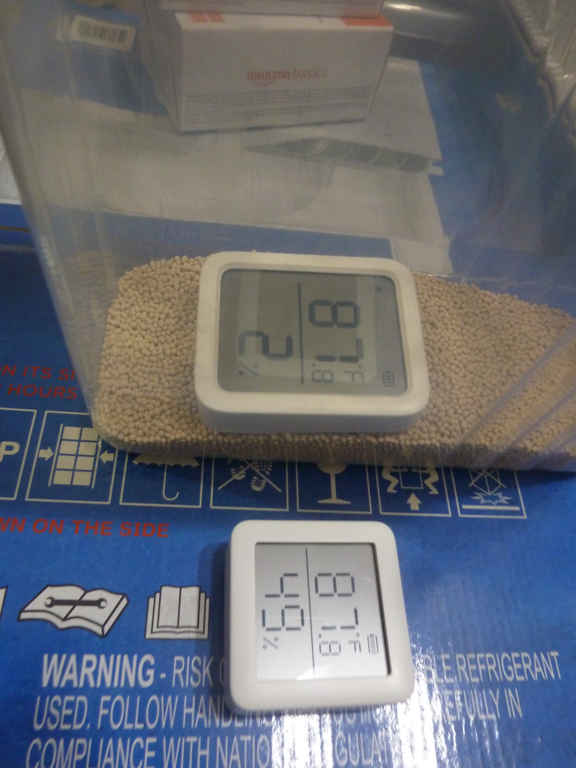

Probably the last photo in the series, but I was surprised when I walked past it this evening that the molecular sieves in the earlier experiment had dropped all the way to 2% (or, more technically speaking, whatever it is that the switchbot hygrometer is reporting as 2%). I had removed the sealed serial box from the blocks, so this time interior and exterior temperatures read the same.
Very impressive! I take this to mean you could actually dry molecular sieves to a usuable level (admittedly not ideal, but useable) inside an 85C capable filament dryer if you wanted to. That stands in stark contrast to Bambulab’s recommendation for the molecular sieves it sells, which, AFAIK, is to treat it as garbage and throw it out rather than regenerate it. Bambulab’s stated reason for that is that the little bit of silica gel with indicator dye that they include in their molecular sieve packets would not survive the usual temperatures that molecular sieves are regenerated at. While that concern is valid, it would survive 85C. So…news you can use if you so choose.
