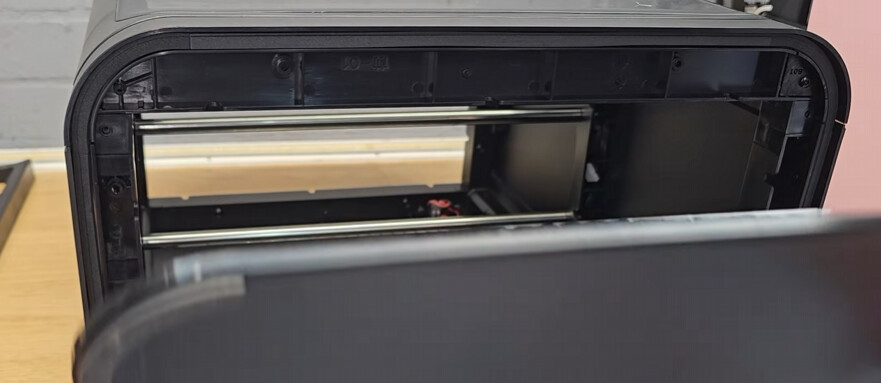

If any sealing is even necessary. But that is something I will test. I just didn’t see any gasketing.
But stuff gets co-moulded with different plastics all the time. Maybe the gasketing just wasn’t visible or it was and I didn’t recognize it. Or mabe the gasket is integral to the part.
It was there. Looks like a typical EPDM open cell rubber.
That was barely on the screen but definitely there and as I thought, I missed it.
Thank you very much! It would have been odd for them to miss a detail like that and they didn’t.

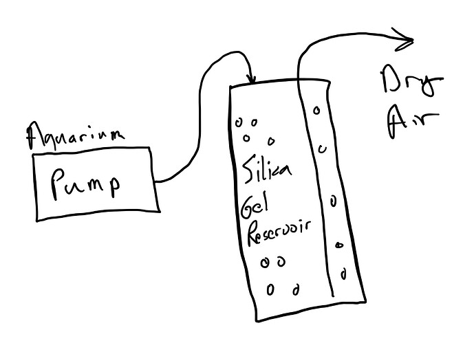

As an aside, it’s easy to supercharge filament drying to not even have to worry about wet vs dry spools, plastic types, etc. It’s dead simple and absolutely works. Since I started doing a dry air purge my dried filaments pull right to 10% indicated - as low as my filament hygrometers go - and I just do not see water issues/effects. All my filament settings are stock. I don’t have to tune out water. It just works.
And this is all it is.
It’s best to add the aquarium pump air at the top of the bead column and take the dry air off at the bottom. You also need some kind of screen or something to keep beads from getting pulled into the tubing by static electricity. Plumb the dry air in near the bottom of the filament dryer. But this is the basic system. You can use a plastic water bottle as the bead column. Long and narrow is better than short and wide. Multi-bay filament dryers may be too much for an aquarium pump. Use indicating beads (orange not blue) and you know when to recharge when the color change starts nearing the bottom/exit.
Nobody has to put wet spools into these cabinets. Those who don’t dry (or don’t dry well) who go through lots of filament will possibly keep these cabinets running at high humidity all the time and not see the full benefits you paid for.
100% agreed. For the benefit of others, I’ll just briefly mention another bonus of your method of using dry air as a purge gas during the drying process is that it yields predictable and repeatable drying results that don’t change just because the ambient humidity might change. It makes it an especially good fit for drying when a mix of different filament types are to be co-housed in an i10. For those reasons yours is the most professional method that I’m aware of, and should avoid the need to “keep 'em separated”. With the i10 coming online, hopefully more people with mixed filaments will recognize this advantage your method has and adopt it.
Hopefully sooner rather than later, but having seen how set in their ways so many people are, for many of them it won’t be until pigs can fly. Their loss. Maybe they’ll come around eventually when they see enough other people doing it.
You are 100% correct - drying to consistent RH provides consistent melt behavior. It also bundles up differences between plastics. RH determines which way water flows but if two spools have equal RH values, same plastic or not, they won’t be supplying water to the more hygroscopic stuff. (There’s more to that than just that statement though.)
And not everyone needs dry air. Putting their dried spools in these cabinets will tattle on how well they are drying, though. If they can’t get their cabinet humidity to come down, barring some malfunction, their filament is just wet to some degree. Easily verified by running the cabinet empty.
But I’m very familiar with the results of using dry air and I won’t dry filament without it. Since I started using dry air I’ve had occasion to rush printing with filament that wasn’t fully dry and it’s very noticeable. To each their own, though.
