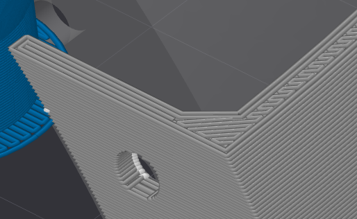

Hello!

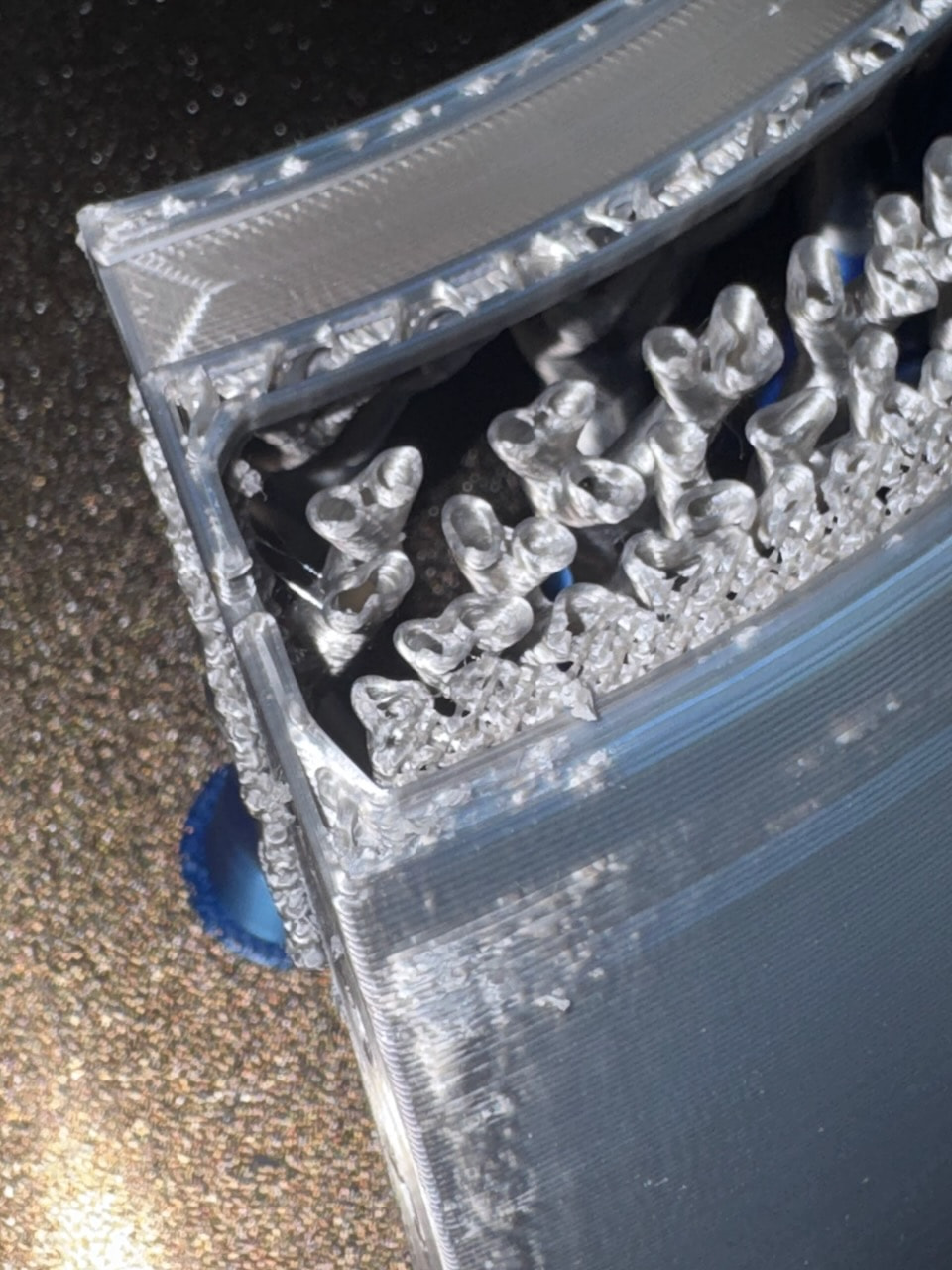

I’m trying to print a part that is roughly a quadrant of a sphere, and regardless of the filament (PLA, PLA Silk+) and printing speeds I used (I’ve went down to 50mm/s) I’m getting some serious surface artifacts when reaching certain Z height that disappear right after it.
Because the part is a spherical shell the wall thickness gradually increases in x-y (although it is a constant 2mm otherwise). Could that be a factor at all? Am I doing something wrong, or can I do something to workaround it?

From the first pic, it looks like the issue starts much further down at the edge and may be linked to Flow Dynamics/Pressure Advance.
I would try to:
  • Dry the filament (again)!
  • Ensure the Auto-calibration is enabled (or even run a dedicated calibration for flow dynamics)
  • Check previews for line type, flow, fan and speed (unfortunately, there’s no acceleration preview)
    => Line type: Do the really bad layers correspond to an area with significant solid infill? If yes, dry the filament and consider a lower minimum shell thickness.
    => Flow: Is max Flow the speed limiter for the walls? Or is it Speed?
    => Fan: Unlikely but possible: Do the fans change at the layer/edge? Lag can affect print performance but I would not expect it on this geometry. I’d expect that to potentially be observable on the inside though.
  • Reduce accelerations

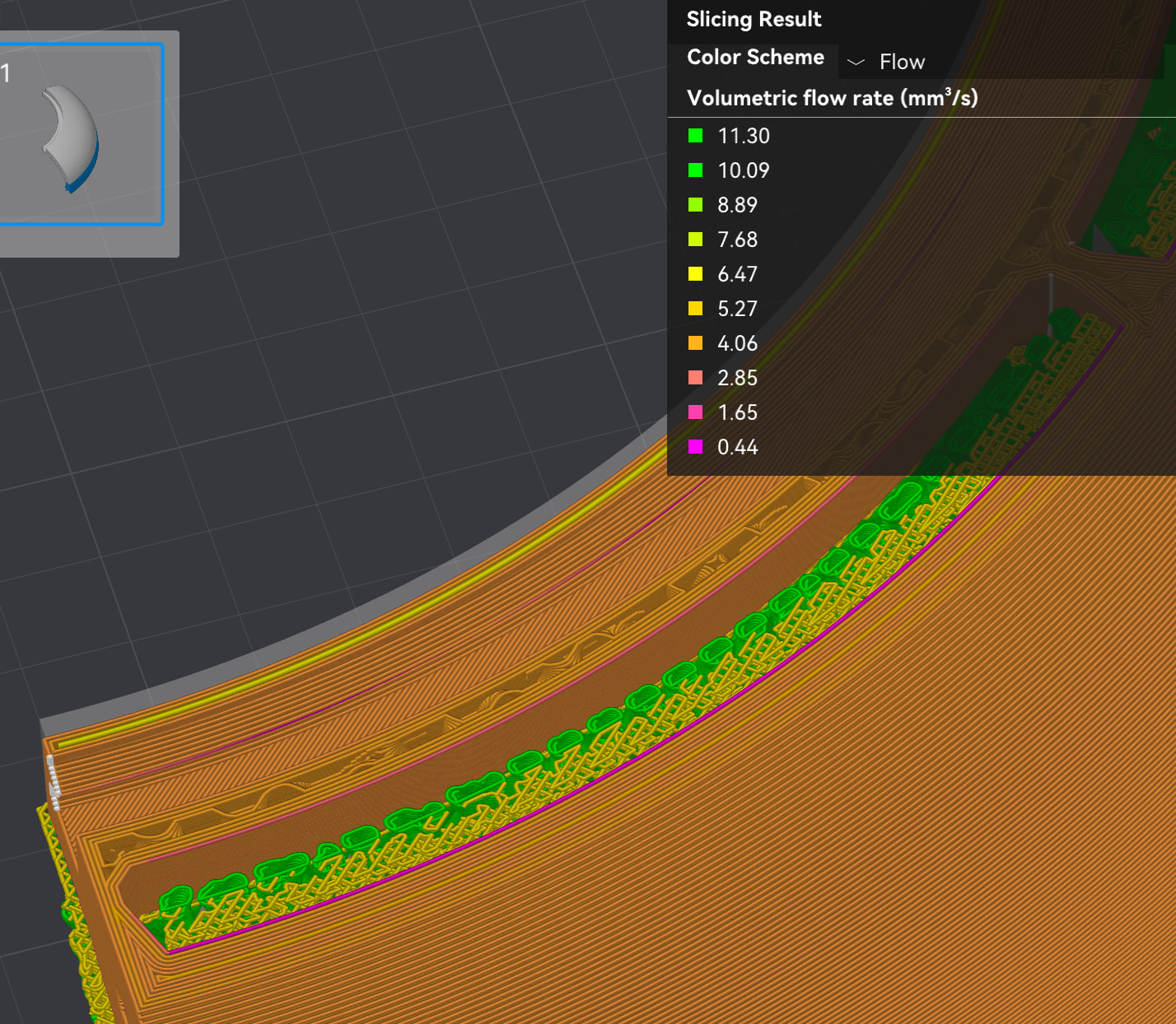

    I’ll check line types, flow, and fan settings…

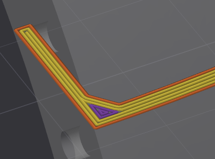

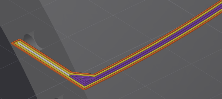

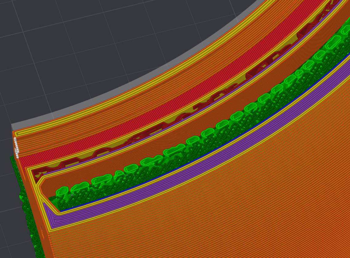

I wonder if it is narrow solid infill detection working against me…
Here’s with it:
Here’s without it:
There are also no significant differences of flow rate and fan speed between affected and unaffected areas.

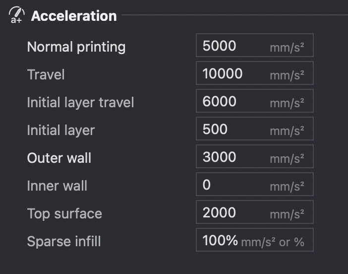

That is good but you may want to go a bit lower still with the Outer Wall. In your first pic, you can see a slight bulging at the corner already in the blue. That bulge indicates flow dynamics being slightly off.

That may be a case but I have not come across this failure chain myself. Of the two pic’s, I’d prefer the first path planning for a nice smooth print. But that is probably just me.

Can you see solid infill in the preview?
I’ll give a try to 2000mm/s, same as top surface!
Yup, pretty much all the way through

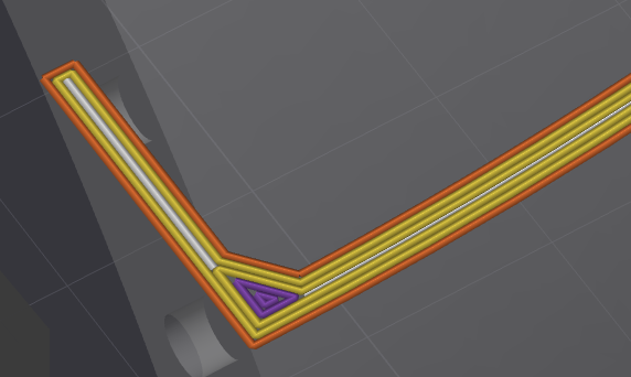

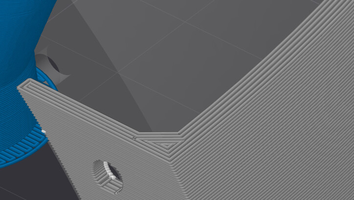

Hah, Arachne is interesting to try. Classic:
Arachne:

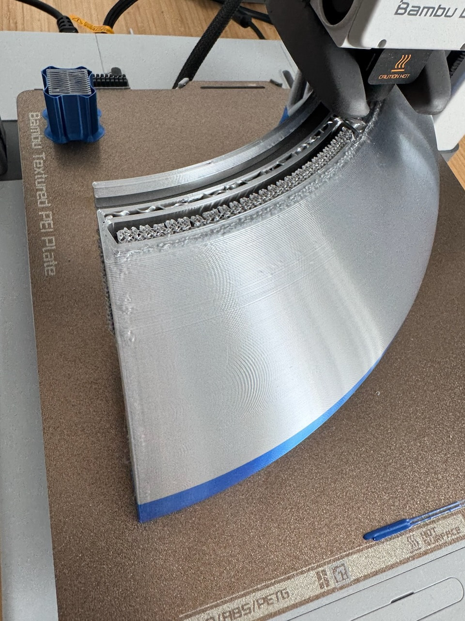

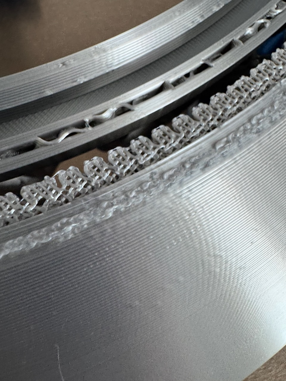

Update, I’m getting much better results due to either speed, wall loop count, or Arachne line types, but the issue still begins to appear although much later than before. This time however, one of the corners has detached from the build plate during the print so maybe I can blame everything on it….

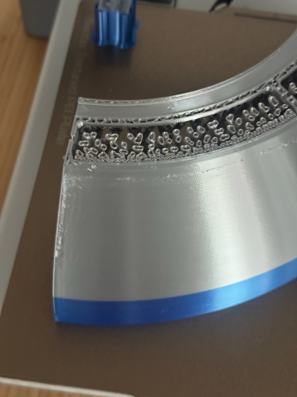

It is interesting that solid infill seems to be overextruded, even though it looks like it should have been printed exactly like the walls and with the same speed:
OK, some improvement, but warping. I am afraid that with reduced speeds, the warping is a clear indication of either a cold print environement (what is your room temp and can there be drafts?) and/or still too much moisture in the filament as well as a need for renewed plate cleaning.
In facts, this warping may also explain the flow dynamics defects appearing higher up.
As for the solid infill, the print looks like “Monotonic line” but the preview shows “Concentric”?
A common solid infill issue at shallow angles is edge curling. It lools a bit like overextrusion, but is actually due to a wide sheet cooling on top of the previous layer. As it cools, it shrinks, pulling the edges up. A lower layer height (variable layer height!!!) can help a lot.
