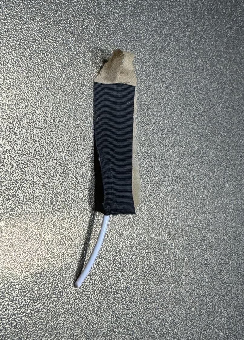

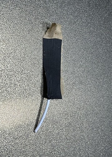

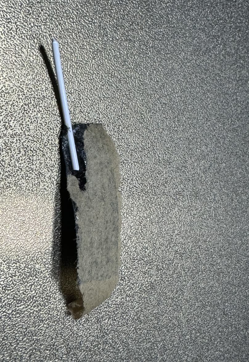

I’ve been having a mixed time with this tape issue. I’ve had the tape release fine on several rolls, but I’ve also had several instances where the tape came off and jammed the AMS up. Very frustrating. I’ve been printing mostly with PETG-HF, and it’s been an issue on all of them. You guys that know me too, know how many big things I’ve been printing lately, so a lot of having to switch rolls.
Yeah, so overall though, I haven’t had too many issues, but when it is an issue it’s an ISSSUE. I’ve had a couple of prints fail because of that, and that can be spendy. When you’re a day into a print, a roll into a print, then the AMS jams, and you’re trying to fix it, but yeah.
Were they the new way Bambu is telling us they have switched to or the old way where someone just stuck a wad of tape over the filament?
I guess I hadn’t entirely taken notice with the previous ones. It did happen again though. It pulled the tape off then jammed up in the AMS. I was able to get it unjammed and snipped the end. Here’s some photos

I can’t say for certain but that looks like the new way @SupportAssistant said they are now taping spools by the photos in this linked post:
If it is, the problem may not be solved and folks should stay vigilant. For those still having issues, they provided a link to report in that same post.
@Josh-3D - I’m going to guess that spool was dried too where it was exposed to some heat? Any chance you know the serial number of the spool? They want that if people report further problems.

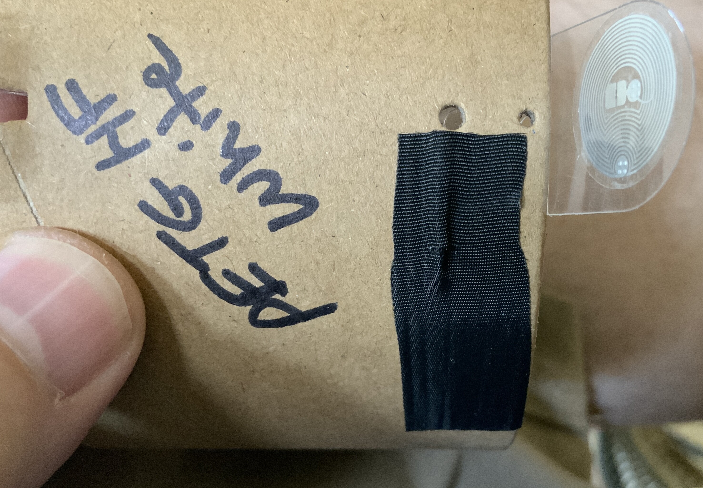

Encountered what looks like the new taping method at the end of a spool of white PETG HF.
Instead of letting the AMS try to pull it free, I snipped the filament near where it disappeared under the tape and decided to have a look-see after replacing the spool.
I tried pulling the little tail of filament with my fingers to see if it would pull free and it did not. Then I grabbed some pliers to pull the little tail free and it did come free but only after pulling pretty hard.
I don’t know how hard the AMS can pull on a filament strand but it seemed to take a lot of pull to get it to come free. Worse, it was gummy with tape adhesive residue on the filament surface where it had been captured under the tape.
Just my opinion but I don’t trust the filament to always pull free of the tape with that kind of grip it has, and I’m not a fan of the adhesive residue getting pulled through the filament path and into the extruder.
This spool was dried with heat at 55C so that could have helped the bond and helped transfer adhesive to the filament. But I don’t trust this new filament attachment method to cleanly finish off a spool and the adhesive doesn’t seem to stay on the tape.

It does look like the new tape method that was show above by @SupportAssistant on Aug 21st.
Looks like it wasn’t resolved and they still have issues…
To be fair, I did not let the AMS even try to pull the filament free. It might have plenty of pull to do that. I didn’t give it a chance to prove itself and it’s the only roll I’ve hit so far with this tape anchor method.
But the adhesive residue on the filament tail was real. Whether or not that is actually an issue for the filament path and extruder is another thing. The path and extruder might not care.
Really curious what others notice as they hit end of spool with this tape method.
Until there’s more information, I’ll be cutting the filament free and trying not to let the tails go through the filament path and extruder, though.
