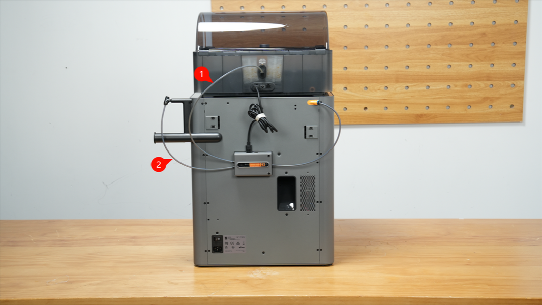

I have an P2S Combo (with 2-in-1 Buffer). In addition to the AMS 2 Pro I also want to buy (and hopefully connect) an AMS HT. And, I still want to be able to connect an external spool.
So,
  • P2S Combo
  • 2-in-1 Buffer
  • AMS 2 Pro
plus
  • 4-in-1 PFTE Adapter
want to buy and connect
  • AMS HT
and retain at least one (1) external spool.
  1. What is the preferred way of connection this?
  2. What do I need to buy in addition to actual AMS HT?
Thank you for you help.

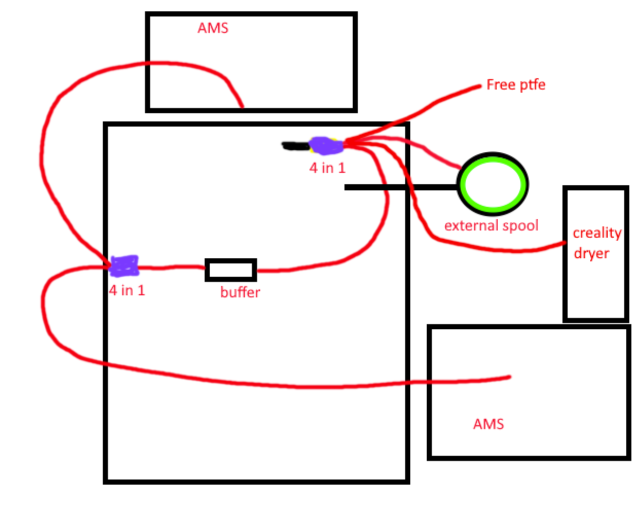

Buy one extra. I have 2 on my P1S. One to connect both AMS (OG and 2 pro) without using the expensive Hub and one at the filament inlet of the printer, through there the 2 ams feed and up to 3 external spools or other dryers.
Here my masterpiece

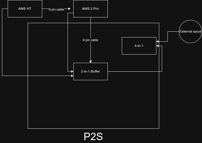

This is my idea of how I should connect everything.
Which mean I could just buy the standard AMS HT.
Long version:
I have a P2S Combo (AMS 2 Pro) with a 2-in-1 Buffer.
I’m reading the instructions for the AMS HT and P2S, but I can’t make sense of them. In addition, I want to connect a 4-in-1 PTFE Adapter for external filament.
“If only connecting one AMS HT to X1/P2/P1/A series printer, the PTFE tube coupler, 4-pin cable and Filament Buffer are required. If connecting multiple AMS HT units, we recommend that you purchase an AMS Hub.”
As far as I know, there’s supposed to be a 6-pin cable between AMS units.
Here’s what I was planning to connect — will this work?
Buffer:
  • Input 1: AMS 2 Pro
  • Input 2: AMS HT
4-in-1 PTFE Adapter:
  • Input 1: Buffer
  • Inputs 2–4: external
Will this work?

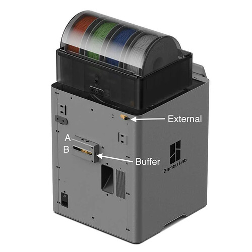

The buffer has two inputs, and you have one external input.
If you only need the following (from your original list), then you have all you need:
  • AMS 2 Pro
  • AMS HT
  • External Access
Connect as follows:
  • Buffer A: AMS 2 Pro
  • Buffer B: AMS HT
  • External: Whatever
If you wish to add more choices, you could add a 4-in-1 adapter to the Buffer (A or B, as it doesn’t matter) and another to the external connection.
  • Buffer A: 4-in-1 adapter
    1. AMS 2 Pro
    2. Future choice
    3. Future choice
    4. Future choice
  • Buffer B: AMS HT
  • External: 4-in-1 adapter
    1. TPU 95A
    2. Exotic filament
    3. Future choice
    4. Future choice

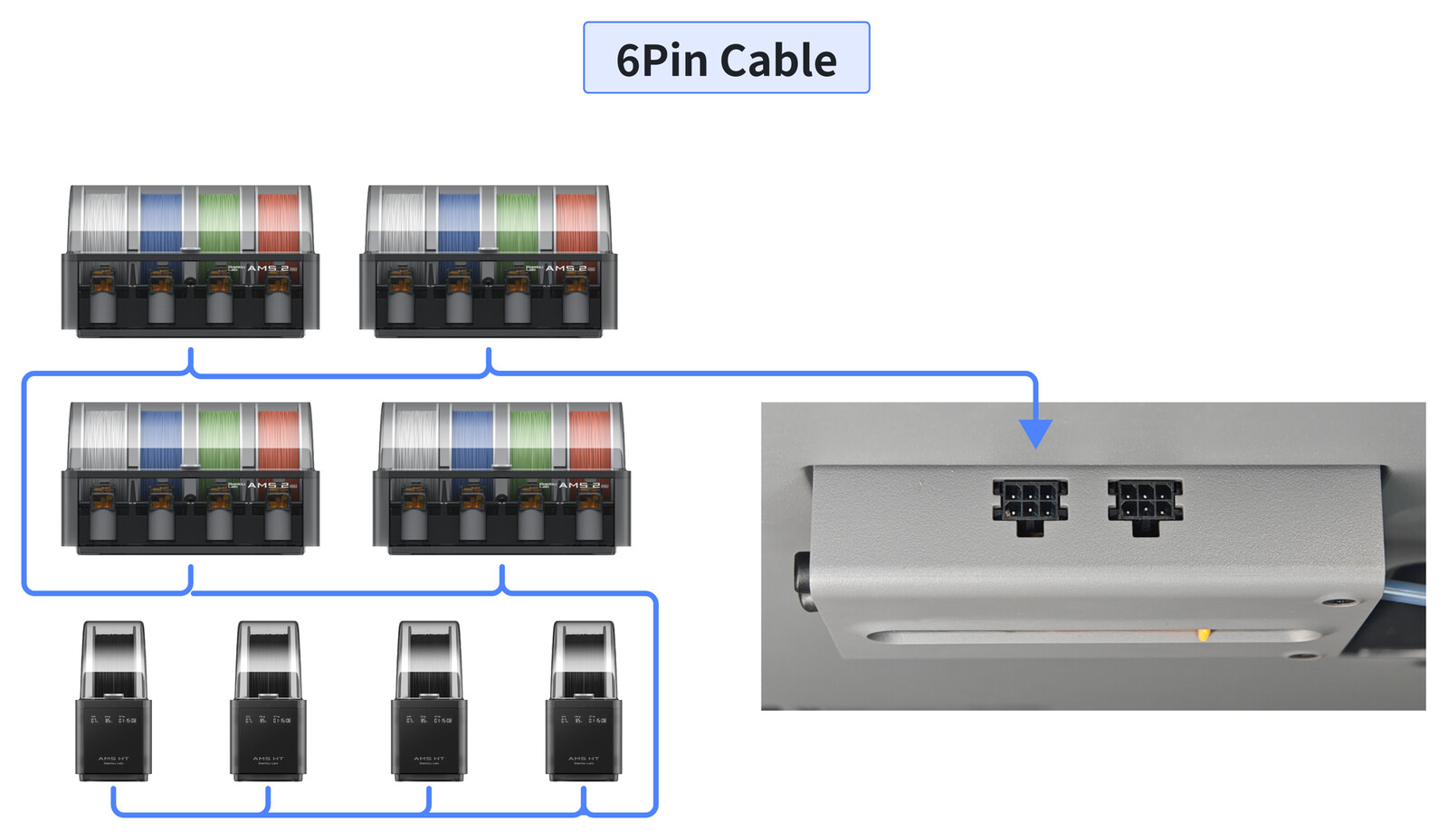

Connecting the cables is easy. Connect the first one to the printer via either buffer socket (ONLY one, the second is for future features or time-lapse), then connect to the AMS, from the AMS to the next AMS until you have daisy-chained each AMS you have connected.
Example 1:
  • P2S to AMS 2 Pro
  • AMS 2 Pro to AMS HT
Example 2:
  • P2S to AMS 2 Pro A
  • AMS 2 Pro A to AMS 2 Pro B
  • AMS 2 Pro B to AMS 2 Pro C
  • AMS 2 Pro C to AMS HT

How do you feed the filament from the buffer to the toolhead?
…and one output that goes (more or less) straight to the printer inlet (upper right corner on your picture)
Wouldn’t it rather be like this?
  1. AMS2 → Buffer A inlet
  2. AMS HT → Buffer B inlet
  3. Buffer Outlet → 4-in-1-Adapter inlet (1, 2, 3, 4)
  4. External Spool → 4-in-1-Adapter inlet (1, 2, 3, 4)
  5. 4-in-1-Adapter outlet → Printer inlet (not “External”)
Just the way @xsynatic has drawn it.

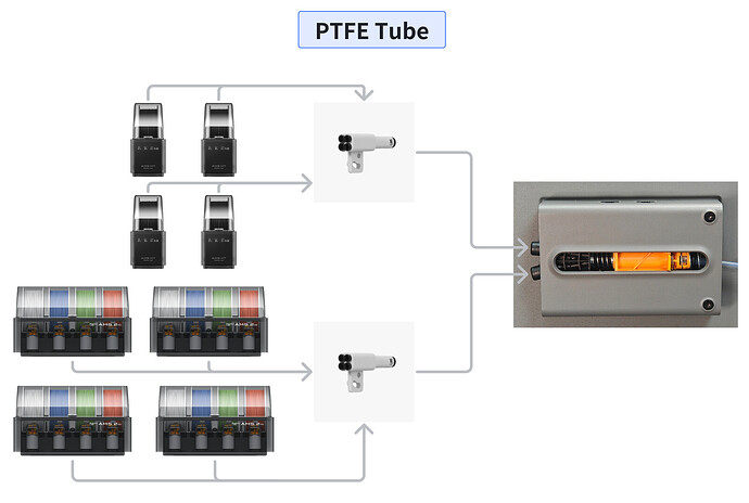

(Picture from the wiki)
One can, of course, create a more sophisticated variant for future enhancements:
AMS2 (1), future AMS2 2…4 → 4-in-1-Adapter[A] inlet (1…4) → Adapter[A] outlet → Buffer A inlet
AMS HT (1), future AMS HT 2…4 → 4-in-1-Adapter[B] inlet (1…4) → Adapter[B] outlet → Buffer B inlet
Buffer outlet → 4-in-1-Adapter[C] inlet (1…4)
External spool → 4-in-1-Adapter[C] inlet (1…4)
sth. completely different → 4-in-1-Adapter[C] inlet (1…4)
sth. truly unexpected → 4-in-1-Adapter[C] inlet (1…4)
Adapter[C] outlet → Printer inlet
data wire wise a bit of a nightmare (at least when it comes to cable lengths), but it’s all in the wiki: (P2S FAQ | Bambu Lab Wiki)
Nowhere it says “do refrain from connecting a third 4-in-1-Adapter between Buffer outlet and Printer inlet”…
