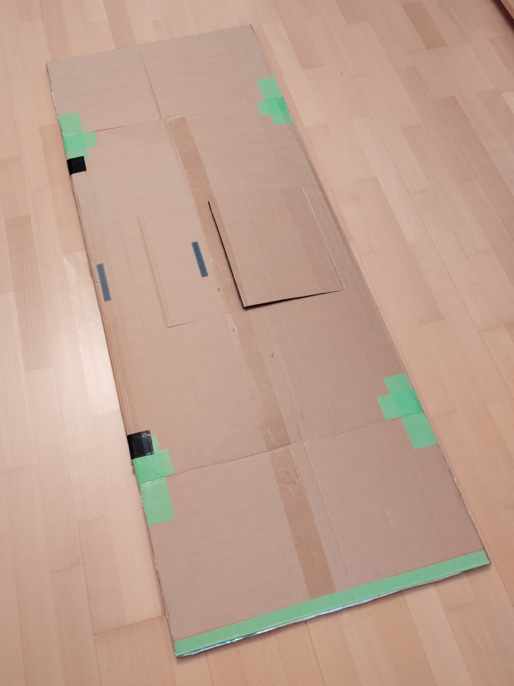

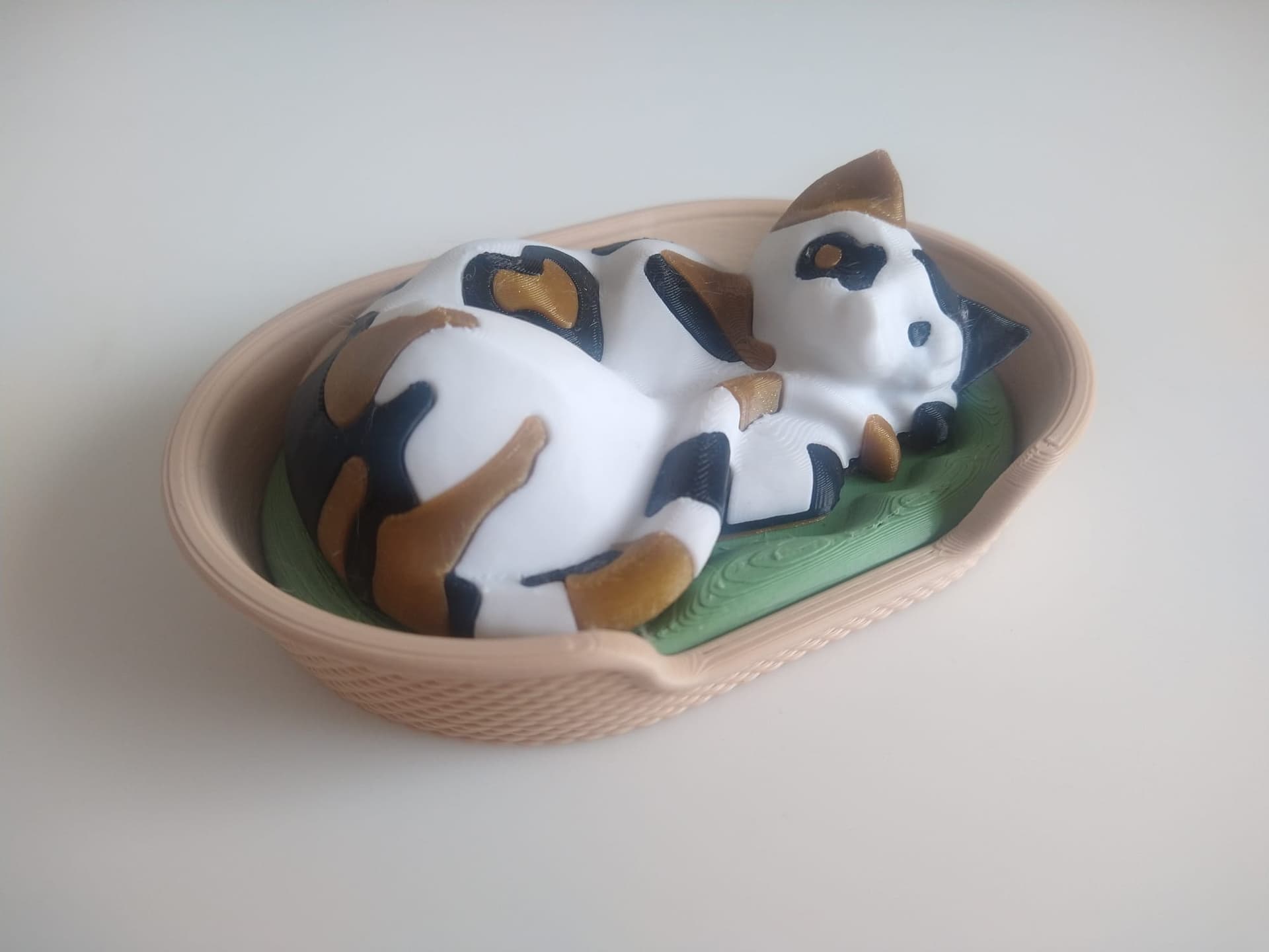

You can use a simple piece of paper or a poster board to create a clean “Sweep” or “Cyclorama” background. I use a simple white poster board that I purchased for under a dollar, taped inside of a cabinet. This gives me a lot of room to work with.
Sweep
Result:
Sweep Result

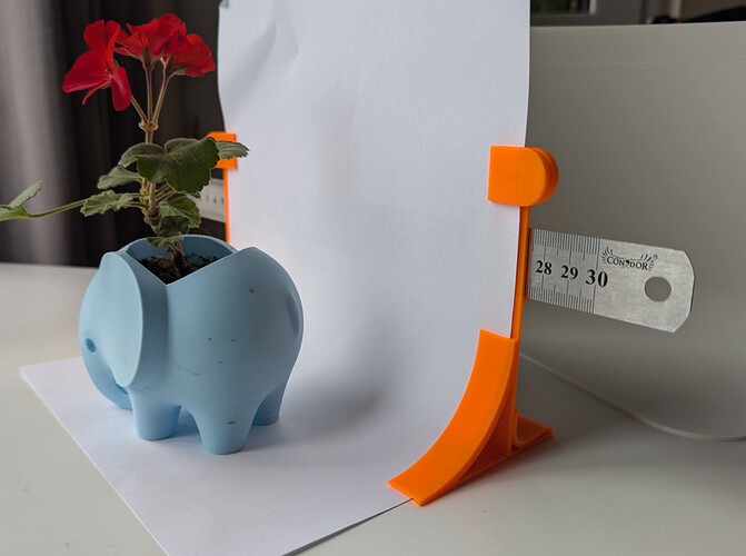

You could also purchase other colors for more variety. Make sure not to pick an annoying color, like hot pink or neon green. This could make it hard for people to see the model. You can also print a stand like this for the paper:
Screenshot 2024-11-01 at 3.43.35 PM
Photo Studio Stand by franceschellifederico

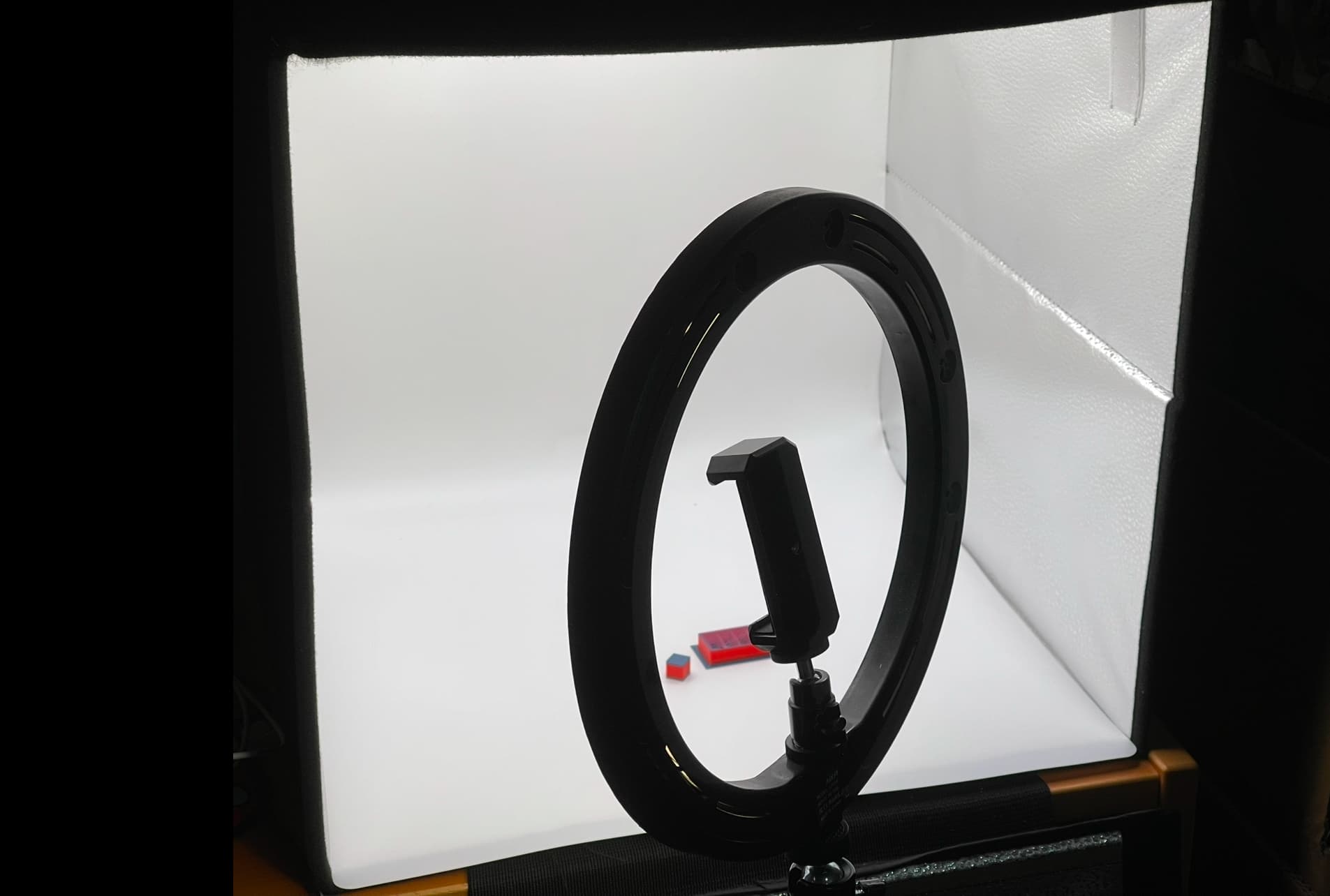

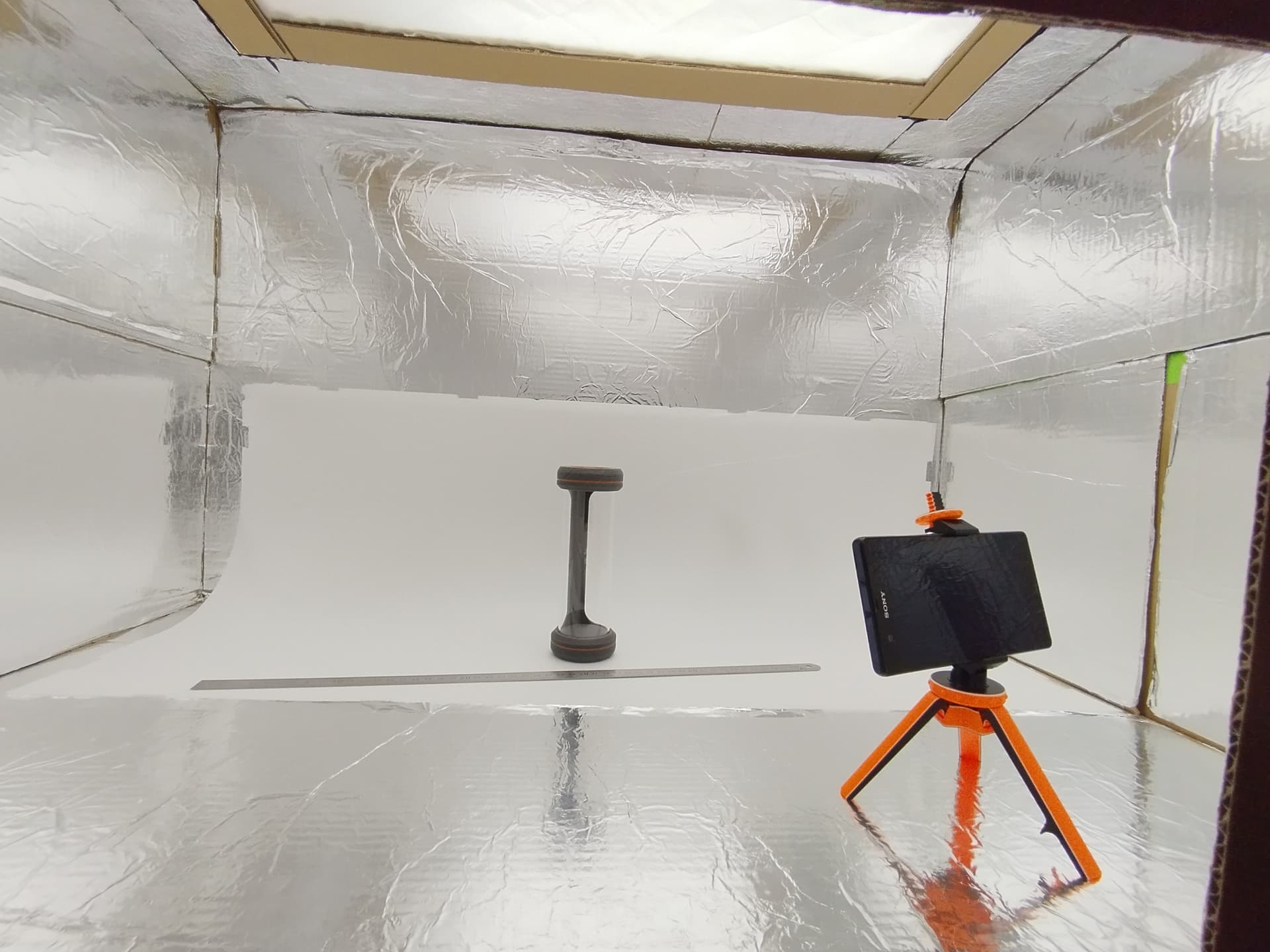

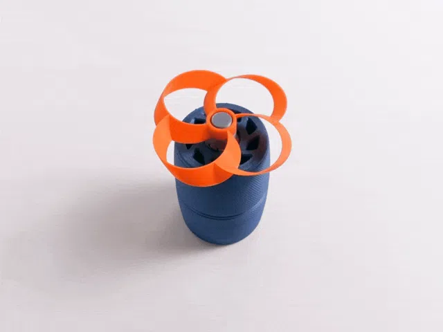

There are also purpose-built photo boxes, like this one that @MalcTheOracle uses. As it’s unavailable on US Amazon, I’ve found an alternative:
Result:
Lightbox
Image from Gyro3 Triad Fidget Spinner by MalcTheOracle

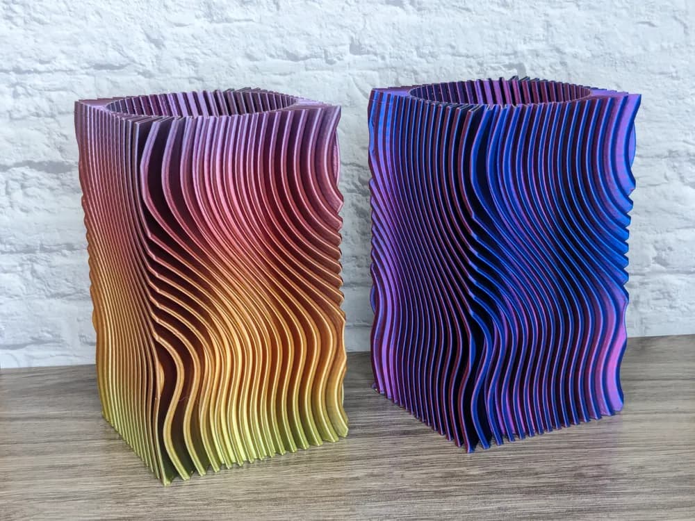

And this one that I made has a 2d print-out of some brick and a piece of flooring purchased cheap from a hardware store:
Image from Pencil Cup: Ribbed Cube Spiral (Vase mode print!) by Zammer 3D

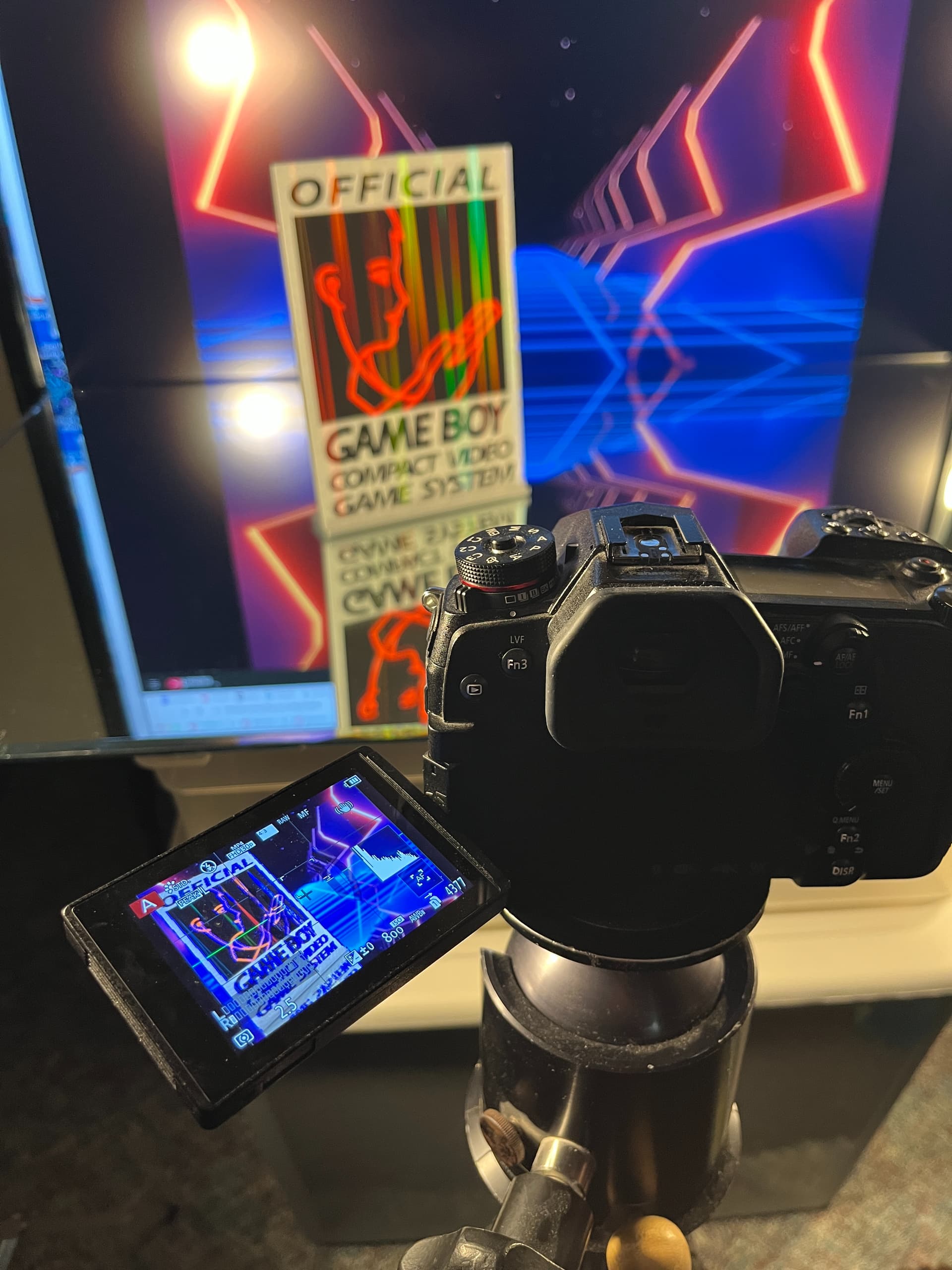

Or if you want a really fun and customizable backdrop, follow this suggestion from @kertgartner:

@MalcTheOracle uses this ring light, which has a built in phone holder…
…and I use this softbox, but any large light is good.
Softbox Light
A large light will make the background more evenly lit, and will reduce reflections and shadows. If you only have a smaller light source, you can use a reflector (a large sheet of paper/poster board works well on a budget). If you have an adjustable color light, play with the color temperature. Usually a mid-range color works best, but it can depend on the look you’re going for and the model colors. The sun always works as a good light as well. It’s pretty dang big, so shadows are usually pretty soft. You can shoot outside or near a window to take advantage of the natural light. I recommend trying to shoot photos at the same time of day whenever you need them. This will make the lighting more consistent across your uploads.
