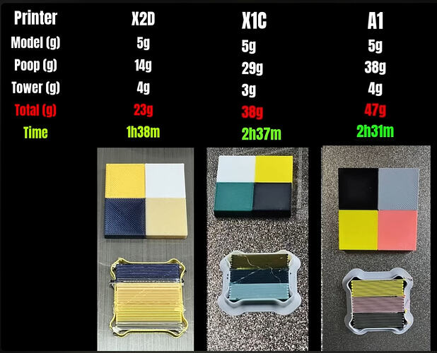

The core promise from Bambu (and the many YouTubers promoting the X2D) was simple: drastically lower print times and far less waste.

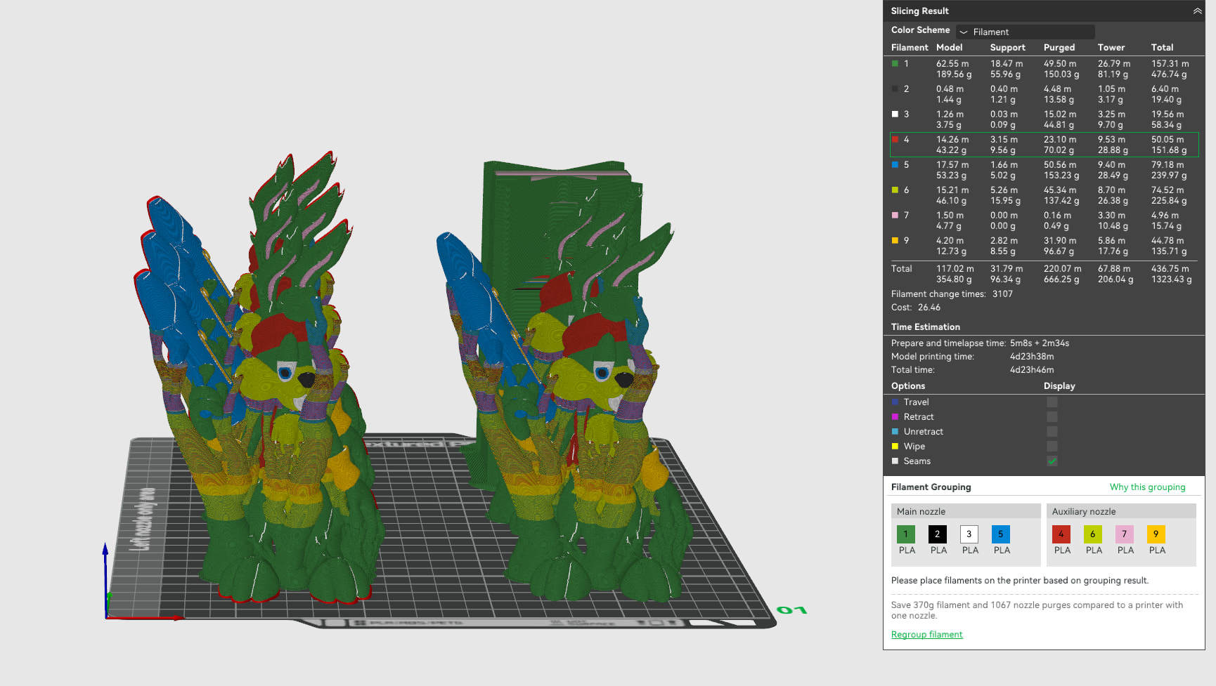

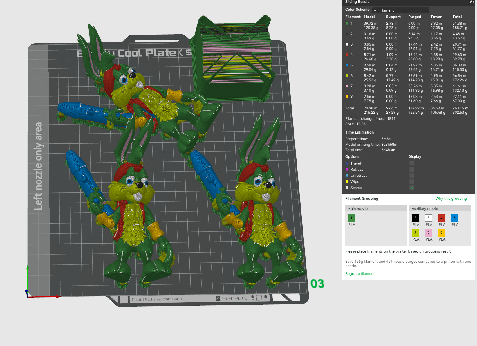

Let’s dispel those claims. As I detailed in a forum post the X2D frequently takes the same time, or longer, to print while offering only marginal filament savings. In the example I posted, a two-color multi-nozzle print took three hours (15%) longer while saving a whopping 20 grams (3%) of filament.
This isn’t a bug; it’s by design. The secondary nozzle is inherently slower, so anything it prints increases total time.
The waste reductions are equally misleading. Model waste falls into three categories: supports, the wipe tower, and purge material.
  • Supports: Cannot be eliminated.
  • Purge: The X2D reduces purge volume, but that depends on color count. If you use more than two colors, you still require color swaps and purges, even if reduced.
  • Wipe Tower: This was the biggest surprise. The tower exists to stabilize extrusion pressure when starting a new filament. I expected it wouldn’t be needed once filaments were loaded into both nozzles (e.g., in a two-color print). Yet the X2D still prints a wipe tower, and actually uses more filament on it. Bambu claims this stabilizes internal nozzle pressure, but competitors like Prusa achieve the same result using a micro-purge of approximately 13 milligrams (0.013 g).

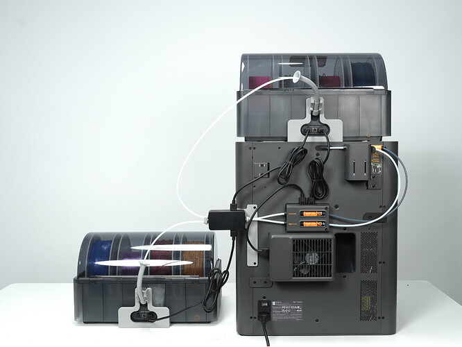

For the X2D to be genuinely useful, you need the Filament Track Switch. It shouldn’t be optional; it should have been included by default.
The main problem is that the X2D is already a mechanically complex machine. Adding the filament switch makes it even worse. Compare the rear profile of the X1C to the X2D.
X1C
X2D
Every extra mechanical component or PTFE tube represents another potential failure point that requires clearing, repairing, or replacing.
Furthermore, the filament switch does not support Silk PLA, a basic filament type that existed long before Bambu started making printers, rather than a niche new material.
