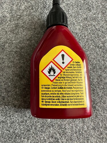

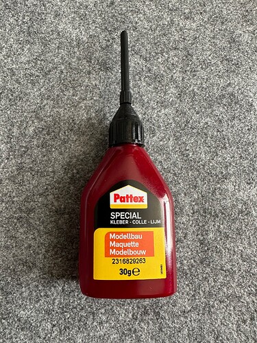

What type of glue did you use?
Im not an expert but this one worked for me. I needs quite some time to dry but once it does it holds the magnets in place well.
