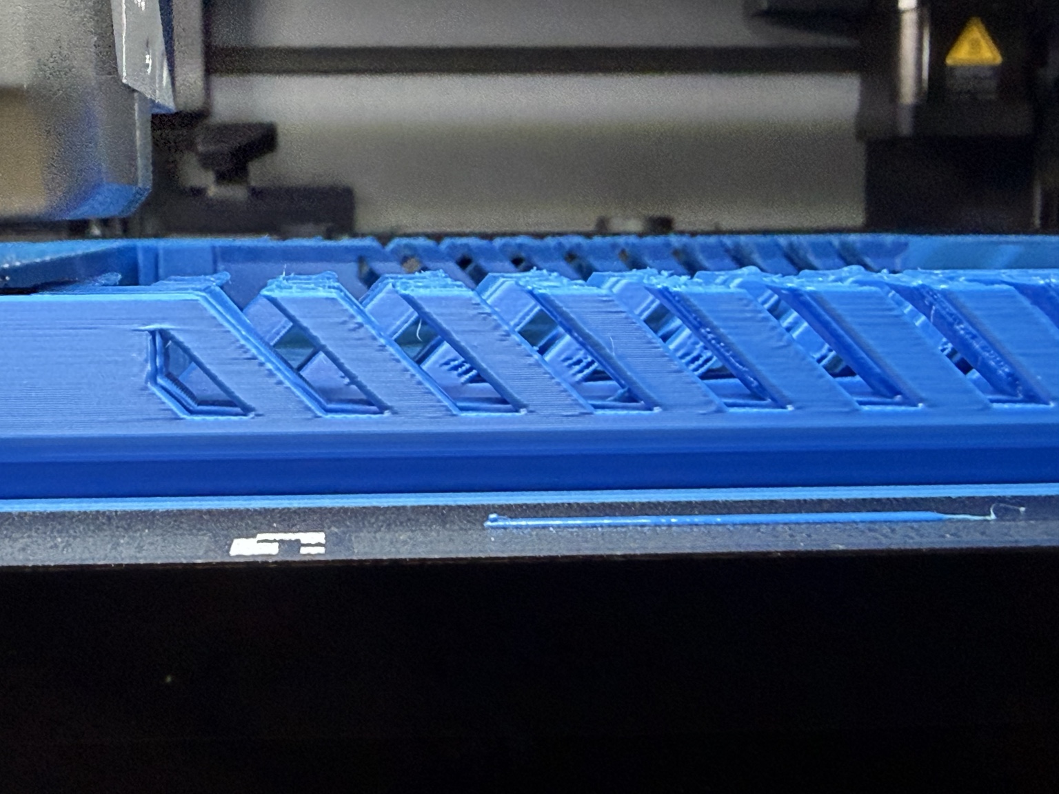

Hello, I’m still fairly new to printing and I’ve been running into issues with Bambu Lab PETG Basic all day. First it was with some desiccant boxes — specifically the lids curling and getting pretty ugly edges. With some tuning I was able to get them to an acceptable place for what they were.
However, when printing my riser tonight, I went back to the stock Bambu PETG Basic profile and ran straight into the same type of issues again.
Does this look primarily like insufficient small-layer/overhang cooling, too much temperature/flow for these features, or possibly an issue with Bambu PETG Basic itself? Someone else printed this exact model successfully on a P2S using PETG-HF, and I’m trying to understand what changed.
PS- Is there any chance the Bambu PETG Basic profile in Studio is the old PETG?
Filament was dried in the AMS 2 Pro at 65°C for ~12 hours before printing.
These pics are from using 0.4 nozzle + 0.20 mm layer height + stock PETG Basic profile
Thanks in advance!
I see quite a bit of stringing. Did you dry the filament before use? Bambu recommends drying before use. Fresh out of the package does equate to dry. PETG absorbs moisture quicker than PLA.
Once you have properly dried the filament, You should performa filament calibration for Pressure Advance (K value) and Flow Ratio.

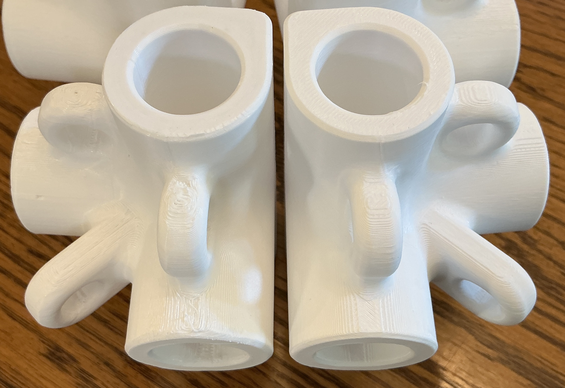

My prints with it aren’t terrible but not the best either. It works but there can be minor issues especially for me with supports. The left part shows the bottom of the part where supports attached. The part on the right shows the upper surface of another part.
Unfortunately I don’t have any good advice for cleaning up prints using it. Your issues seem more pronounced so maybe higher water content - if any of the issues are due to water.
Yep — it was dried for ~12 hours at 65°C in the AMS 2 Pro before printing. I included that in the original post. I haven’t done PA/K-value and flow calibration on this spool yet though, so that’s something I can test next.
Thanks, that’s really helpful. That lines up pretty closely with what I’ve been seeing — the PETG Basic isn’t completely unusable, but the stock profile seems pretty unforgiving on supports/overhangs and small features. Mine was dried for ~12 hours at 65°C before printing, so while moisture may still be part of it, I’m starting to wonder if the profile/material combination itself is just not ideal for this kind of geometry.
Good to know PETG-HF has been noticeably better for you though. I may grab a spool and do an A/B test on one of the smaller failed vent pieces rather than reprinting the whole riser.
Also, I’m not entirely sure what I’m looking at in that photo :joy: but whatever it is, the print itself looks really nice!

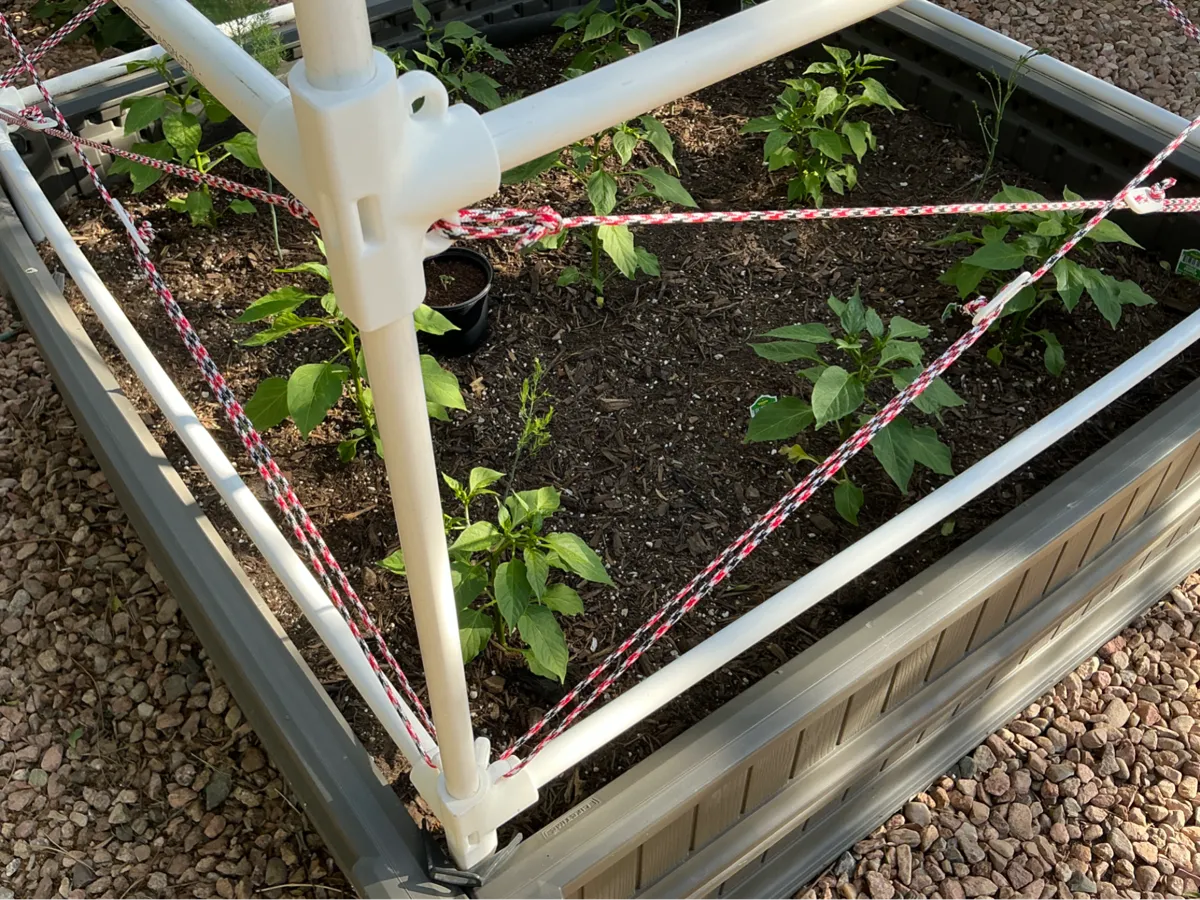

Thanks for the words about the model. Those are fittings from a free-standing greenhouse or frame for netting cover for a garden.

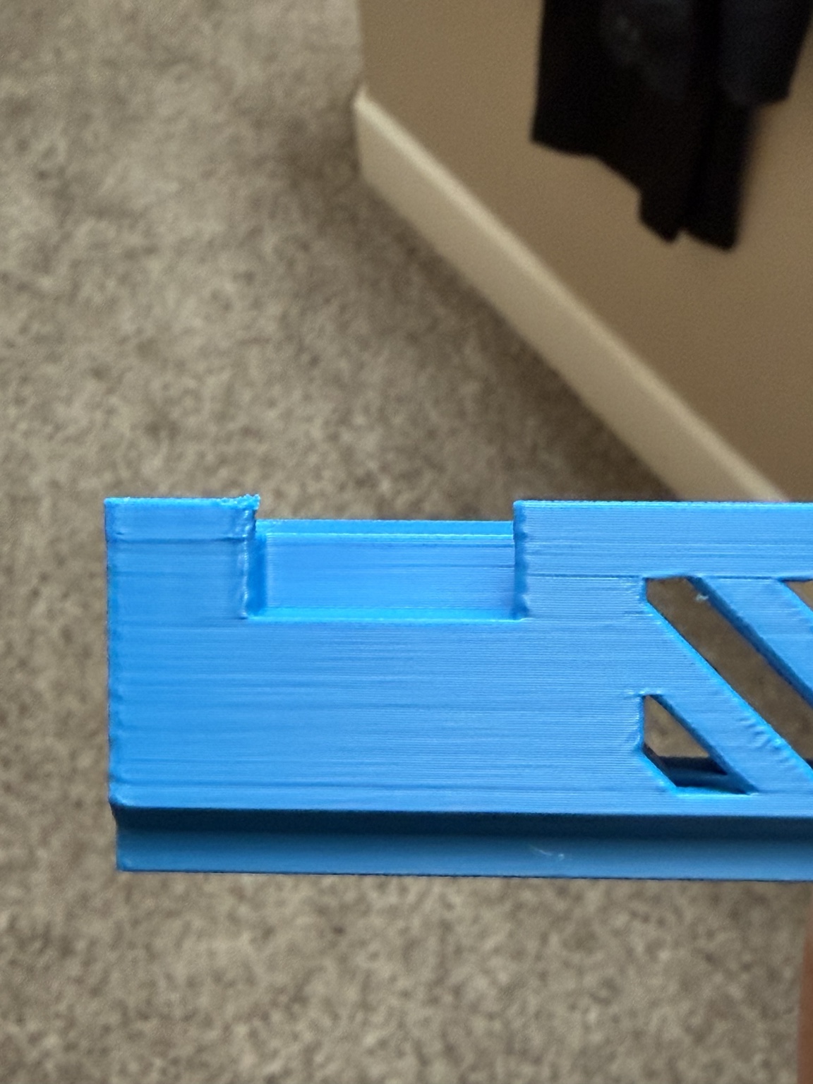

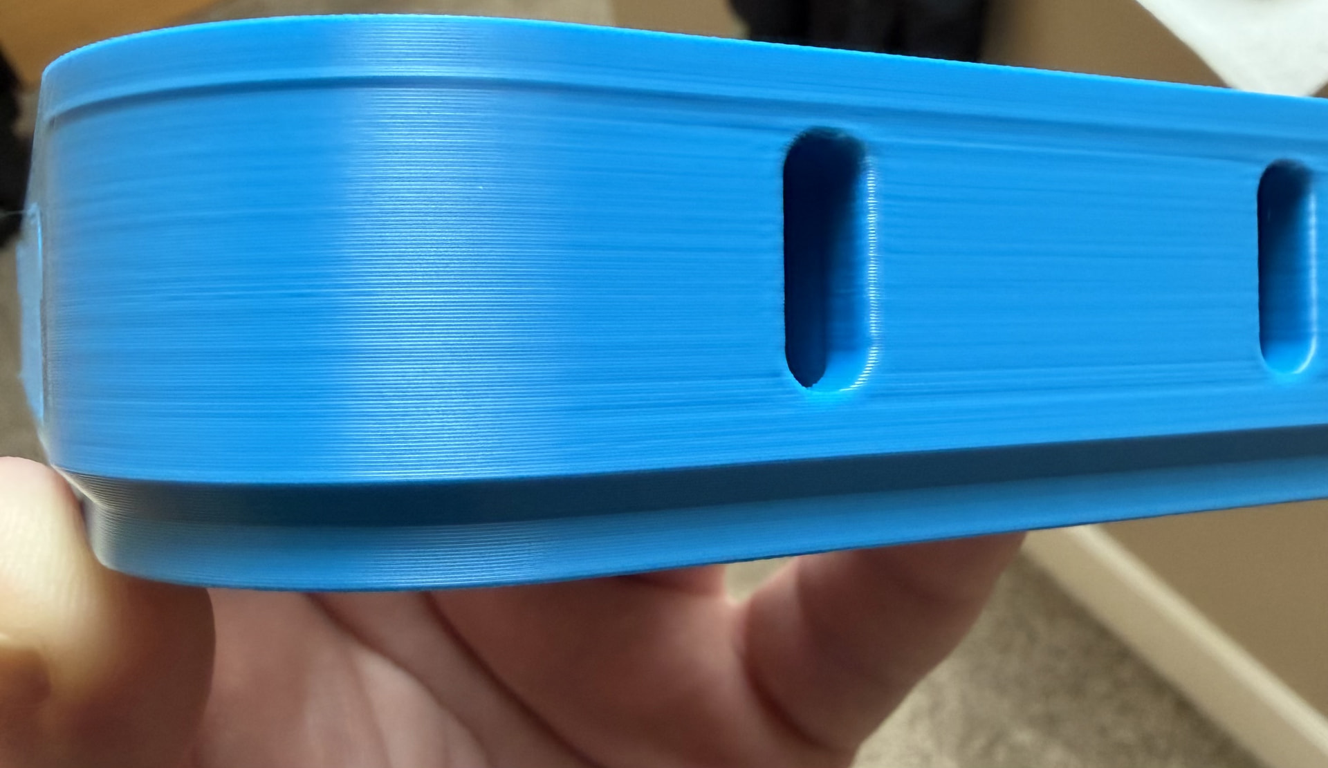

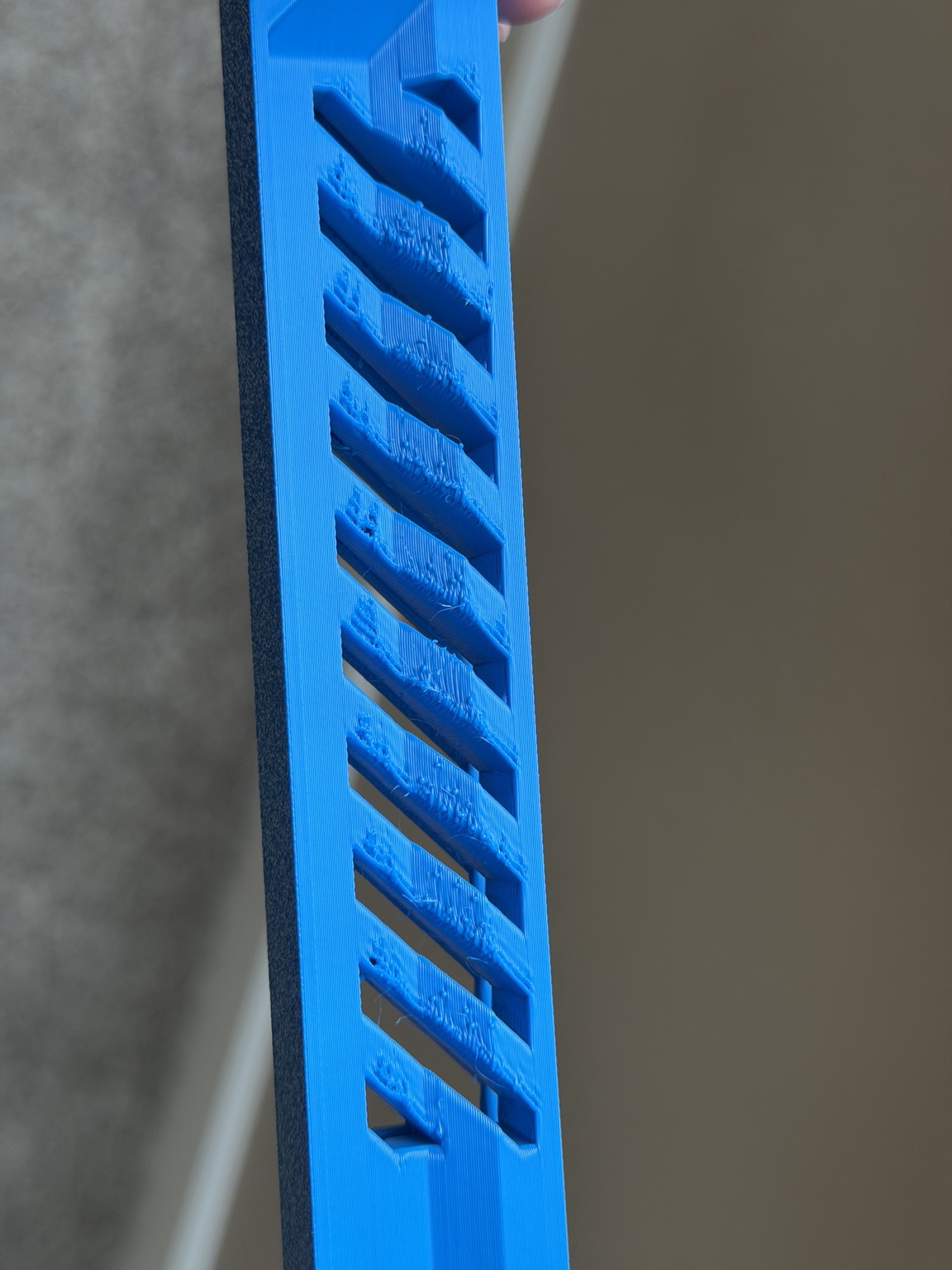

Update now that the print is finished:
I pulled the parts off the plate this morning and added a few photos. The inside of the vent section is significantly worse than it looked mid-print, and one outside vertical/corner section also has poor surface quality. However, some of the long exterior vertical walls on the exact same print came out quite clean.
ahhh makes more sense now, cool design!
