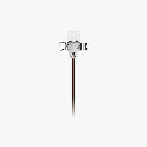

In the event @StreetSports is correct about some of the mating surfaces being a bit too loosey goosey, I notice that there is a replacement right-hand hotend heating assembly:
A different version is also sold for the left hotend.

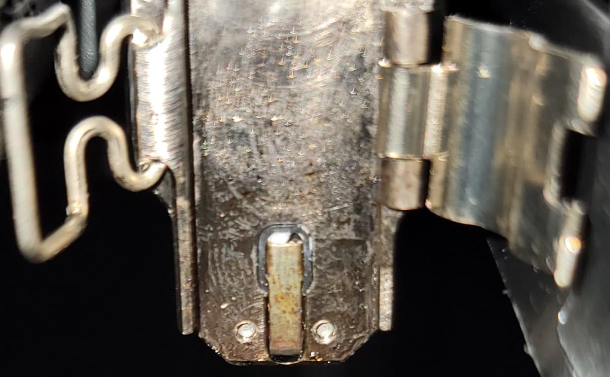

From what I can tell looking at my nozzle. The rectangle sensor in the back sticks out a little past the rest of the heating assembly. Not much but just enough to have a very small gap everywhere else. I think this is by design to make sure the sensor has a full mating surface. Like everyone else, I think its due to using a lot of PETG HF in the other nozzle. PETG HF vaporizes more than other filaments. I’ve done about 10 prints so far where I swap the right nozzle out for another nozzle I’ve deemed to be HF (the stock 0.4mm standard nozzles that only get high temp filaments in it) and the problem went away.

When I zoom in on the photo I took (posted earlier and zoomed in more here):
I would agree with you, but I do see crud on the rectangular piece (is that the temperature sensor?). The only place I don’t see it is in those two little divots. Therefore, I hypothesize that those two divots are where the actual contact is made, and everywhere else is standing off to one degree or another. Does that make sense? On the other hand, the rectangular crud is a different color (a brownish orange), which is different from the black crud. Is it a different color because it didn’t get as hot? Another piece of the puzzle perhaps.
What are those two divots anyway? Are they just for alignment with the the nozzle, or are they like pogo-pin type connectors for passing current or signals? I need an anatomy lesson as to what it is that I’m looking at.

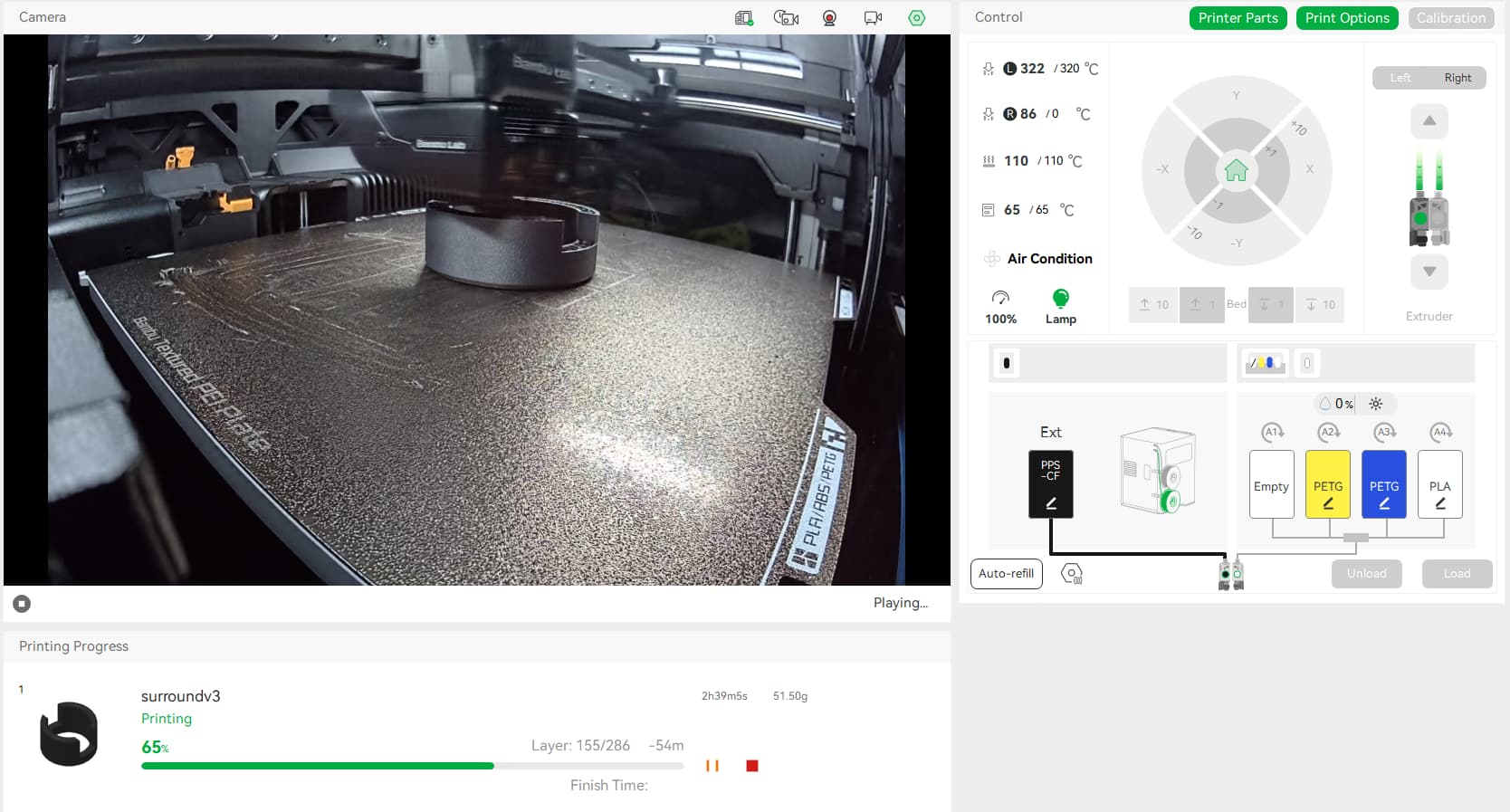

Reporting back: Nothing loaded into the right nozzle, but I notice that while print PPS-CF from the left nozzle, the right nozzle drifts up in temperature to 86C. Not sure how well either PLA or PETG would withstand that without consequences if it were loaded into the right nozzle:
Consequently, out of abundance of caution, I’m using a 0.4mm nozzle that has NEVER had any filament loaded into it on the right nozzle, so that there’s no residual below the cutline. I means I have to dedicate a nozzle to just that purpose when printing the high temperature filaments in the left nozzle.

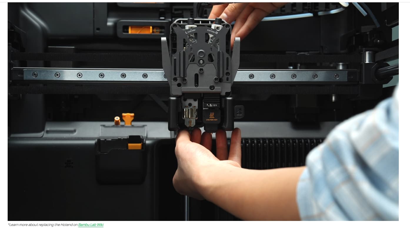

I can see now why the left nozzle is inherently easier to remove, after watching this bambulab video:
[to see the full video, click here: Bambu High Flow Hotend - H2D | Bambu Lab USA Store or go to the H2D hotend listing in the Bambulab online store]
In brief, the left nozzle moves up and down, whereas the right nozzle stays fixed. If I had paid closer attention to my H2D, I would have (should have?) known that. :blush: Well, maybe I’m not the only one, which is why I point it out for the benefit of anyone else. That means any residual filament below the cutline won’t get in the way with the left hotend, whereas you may have to finese the right hotend a little.

  1. Heat up nozzle to 190C
  2. Pull on nozzle end and pivot upwards
  3. Pull out hot end and take out residual filament
  4. Set nozzle temp to 0C
