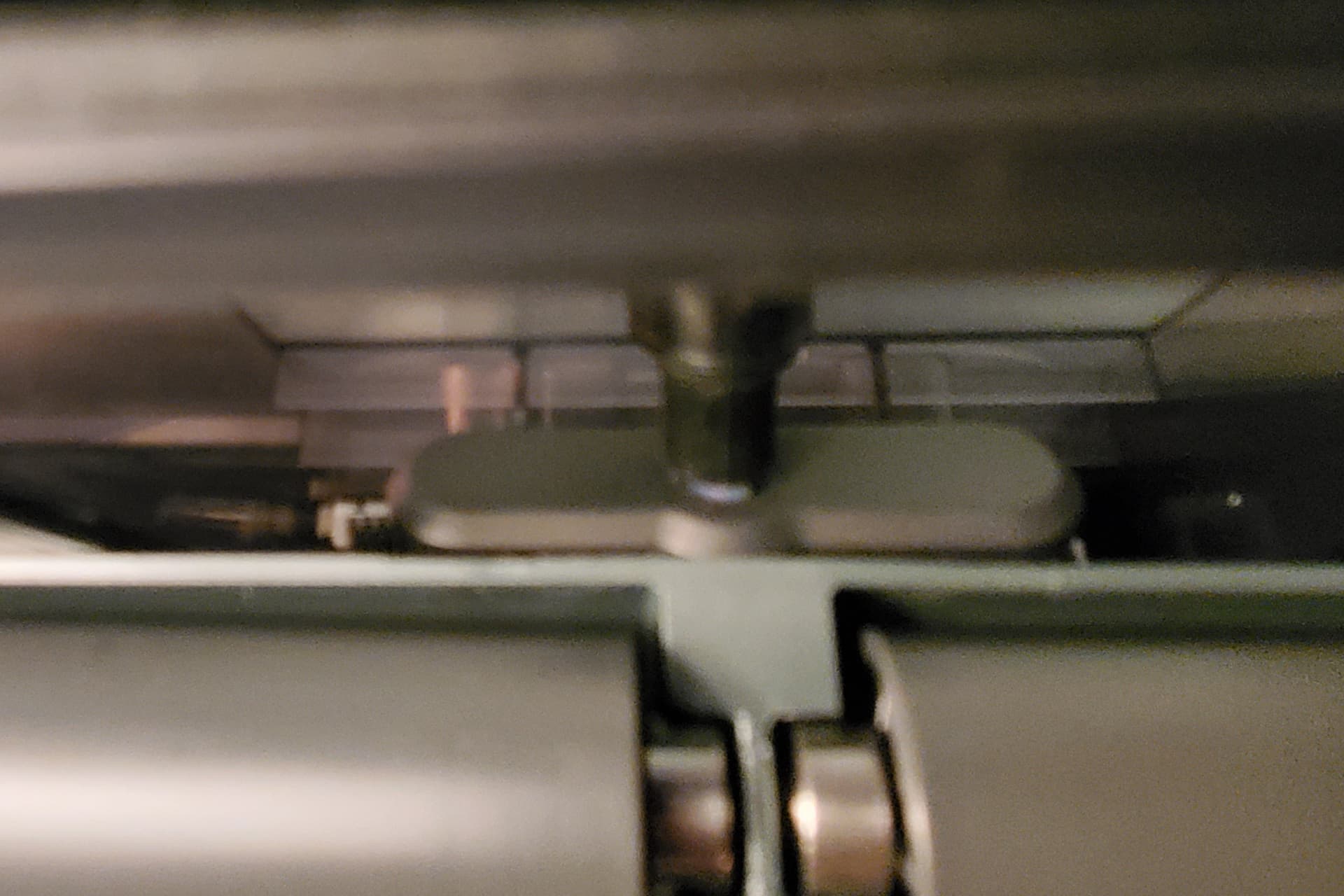

Thank you all for your responses. The trouble I am having is either that I do not have the hand Strength to push on the thing you need to push to release the tube, or I am pushing the wrong thing. It looks So easy in all the videos, but on my system I cant seem to move it. I am attaching a picture of what I see, maybe you can tell me What Im missing. Thank you.
Did you get the stuck roll of filament out yet? To remove that one you have to turn off your printer. The printer locks the motors during the “pull back failed” error. I assume you have this error cos it’s the #1 thing that locks up the filament. After turning off, check the buffer (grey thingy with springs) at the back of your printer to make sure it’s not locked either, then try to yank the filament out from the release.
If you’ve gotten that one out already, it’s possible you have a piece of filament still in the PTFE; it shouldn’t require that much strength to push (I’m a tiny asian girl with the hand strength of a 90 year old granny on deathbed). You just have to hold that down and lift the unit up at the same time. Don’t pull too fast because of the cables connecting the housing and the unit.

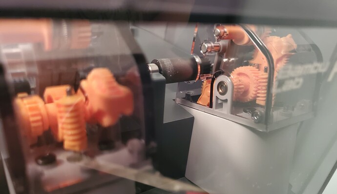

The printer did not generate an error, rather when I went to set up a print, the AMS simply did not show up! The nozzle had moved back to its home position after the calibration completed. I am pretty sure I could print if I just put a role of filament on the place on the back Where you Put filament when you dont have an AMS as the printer appeared as ready to Print before I turned it off to resolve this AMS issue. I have attached another image here which shows the gear on the right that is stuck in the up" pusition and you can see the one next to it which looks the way they usually look in the resting position.

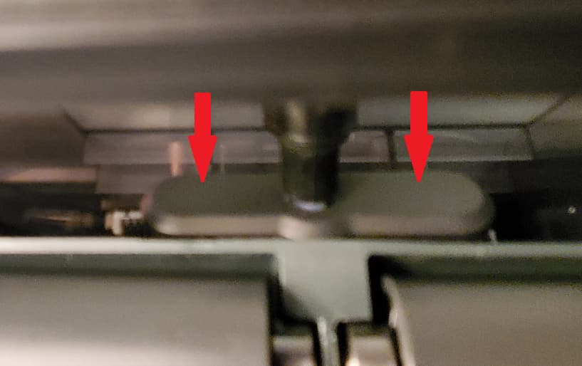

For the second problem, to remove the PTFE you want to put one hand in the space pictured. Split two fingers, one on each side of the PTFE and push both sides of the black part:
While pushing that down with one hand take the other hand and pull the PTFE tube up from behind the printer.
Once you have it out the insides of the AMS will come out easily. Just be careful because the two wires are really short.

I have been doing it the way you describe above, but the tube just will not budge So I just must be not doing it right which I cannot understand because frankly it’s just not Rocket Science.
I’m using my two fingers to press the tab on either side of the Black end of the tube down, and pulling the tube with my other hand to no avail and nothing,it just won’t move!

The rear AMS tube can need a bit of force to unplug even when pushing down firmly on the release indicated by @PrinterMcgee above.
Especially if the PTFE end is frayed or the PTFE coupler is broken. You may need to use pliers to get a good grip and subsequently replace the PTFE if repeated wriggling does not get it to budge.

The PTFE tube fittings used are push to connect. These style of connections are designed to resist being pulled out and so you typically need to push the tube in while pressing the release button/mechanism.
No problem! Is the filament still going from the spool in the AMS to the buffer? That could be what’s stopping the PTFE from coming out. If it is I would cut the filament at the spool and try again. Also using @EnoTheThracian and @RandomKhaos suggestions above.
