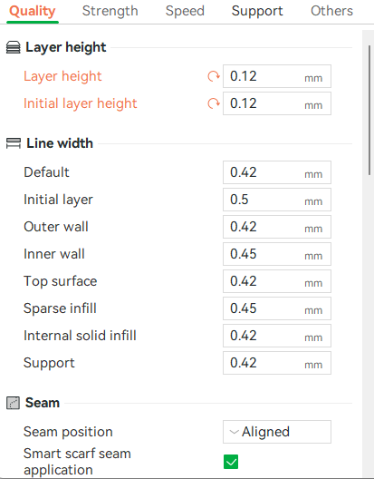

Hello, I am having some major problems getting Lithophanes to print on my brand new H2D. It has me seriously considering returning it. The printer settings are attached, I am using basic white Bambu PLA. Please if anyone knows a fix or a settings issue let me know. I am looking to find all the help I can get. I have done calibration tests and extrusion. It is also leaving blobs or little small specs of filament of the lithophane that is hindering the picture. If any of you smart people know a fix let me know ASAP. This is a brand new printer.

I could not tell you. I downloaded the settings for a 3.mf on Makerworld. Do you have settings you use?

You should try using the 0.12 fine HQ it will have diffrent process settings
Looks like one side warped up into the nozzle. Try a 0 gap brim after cleaning the plate and drying the filament. Also, if you want to print such a thin part vertically, youre going to have to run very slow. Maybe start by trying silent mode

If you look closely, the initial layer height was set to 0.12 mm, which doesn’t provide a strong foundation or good brim adhesion. The 0.12 profile are better optimized for this purpose.

Yes unfortunately this was already dried on a 8 hour cycle in the AMS 2 Pro
