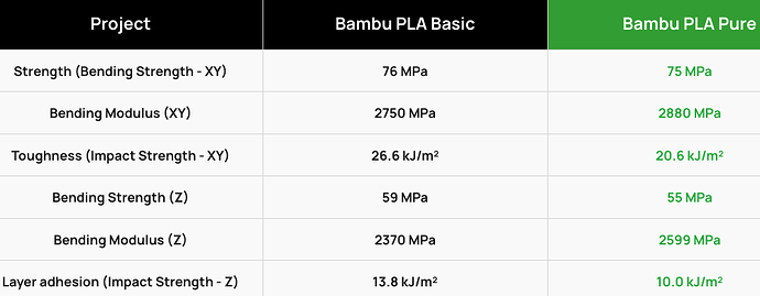

PLA Pure has similar strength to PLA Basic. So I am thinking why not. The only cons are that it is $2 more and at present has fewer colors available. I have requested a gray color which is what I use for prototyping.
What do you think? Am I missing something about PLA Pure that makes it not recommendable for such use?

Per 10kg it is reasonable enough a price. It’s hard to quantify what “price” people want to pay for safety but 12/kg is a pretty low premium cost anyways.
Maybe Dr. Igor Gaspar will do a mechanical review comparison vs PLA basic, etc, that would be fun.
