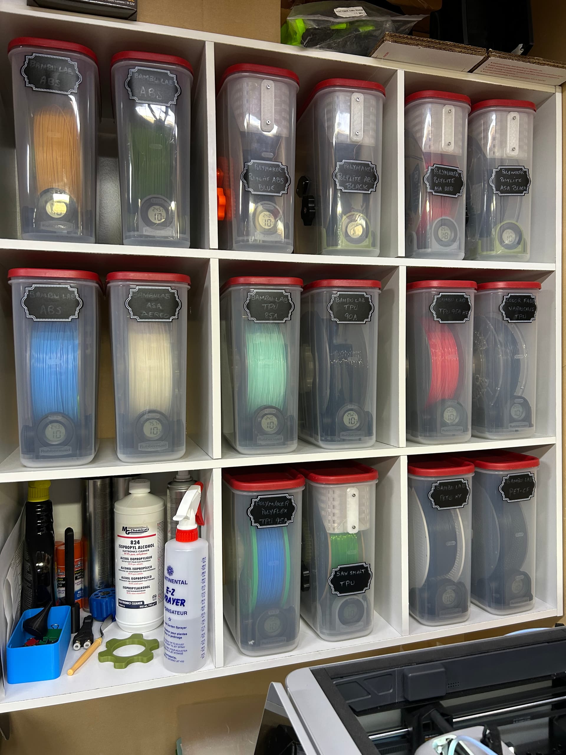

After multiple bag seal failures, I also went to the Cereal containers with desiccant as well. Much more reliable solution.

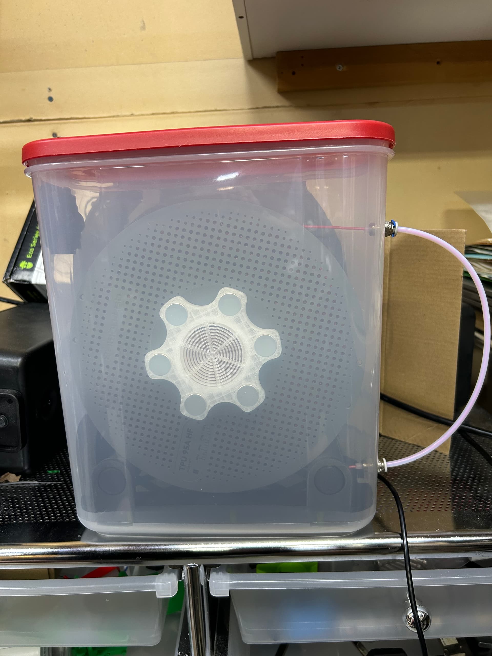

Every time I look at zip bag reviews before buying, I always get steered away because it’s always the same as what was said here. I use the 21 cup Rubbermaid container for my most valuable filaments. They are expensive but work very well and are pretty much indestructible. I had developed a rewind system that required multiple holes but have since found two great solutions requiring only two holes for PTFE tube adaptors which I glue to form a seal. The PLA I usually keep in zip bags with desiccant but might start using boxes for them as well.
I find that using real bearings in the roller base work better than printed ones and the magnetic retract desiccant system works amazing.
My Setup:
The base and rewinder are on makerworld:
filament-dry-box-for-rubbermaid-21-cup
filament-spool-dryer-without-lid-retracting-system
