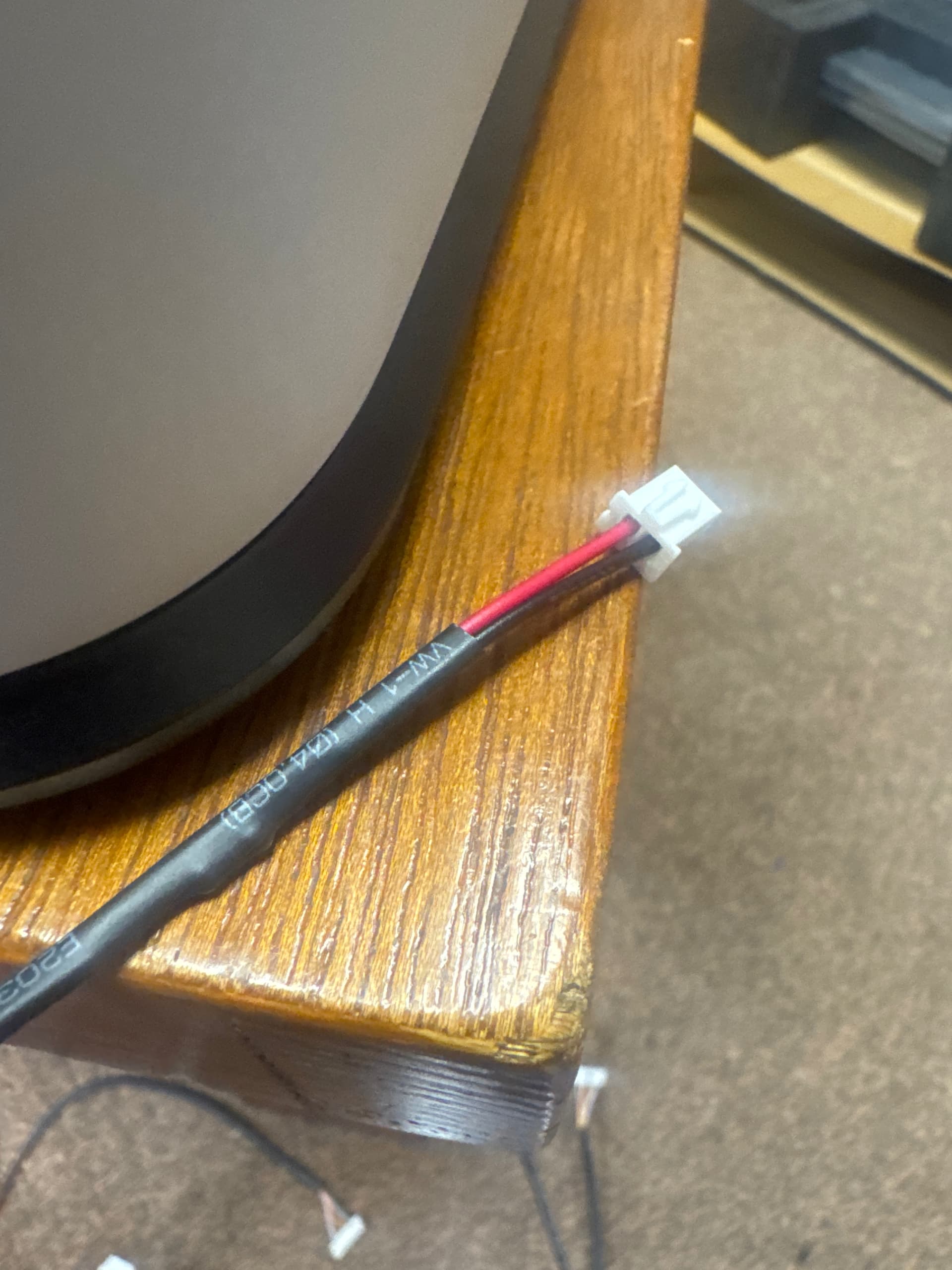

That really seems like bs. I didn’t check the data cable as some wires may have been swapped or some added but I doubt it but how can a 2-wire power cable be different, gages are the same and can’t be reversed :wink:

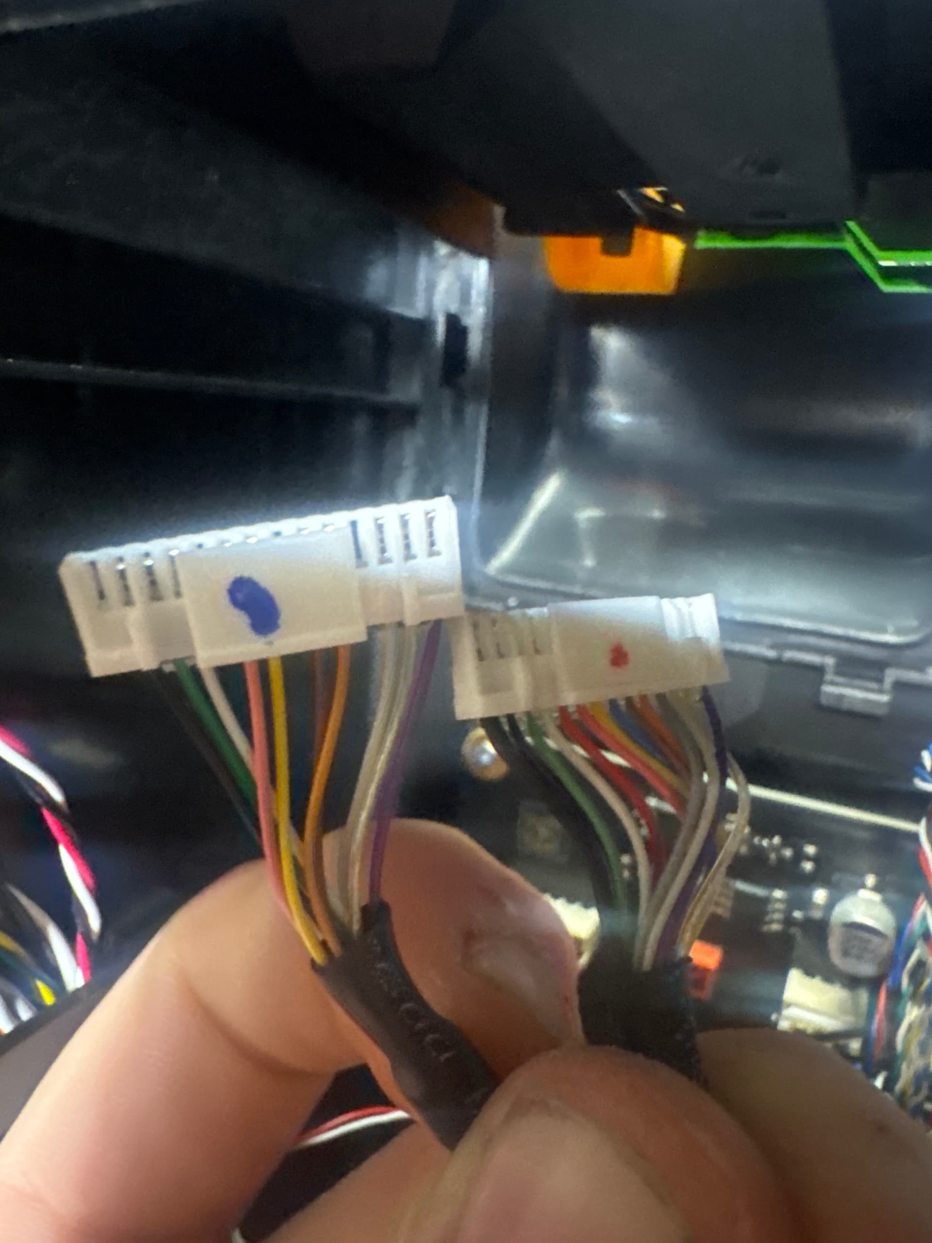

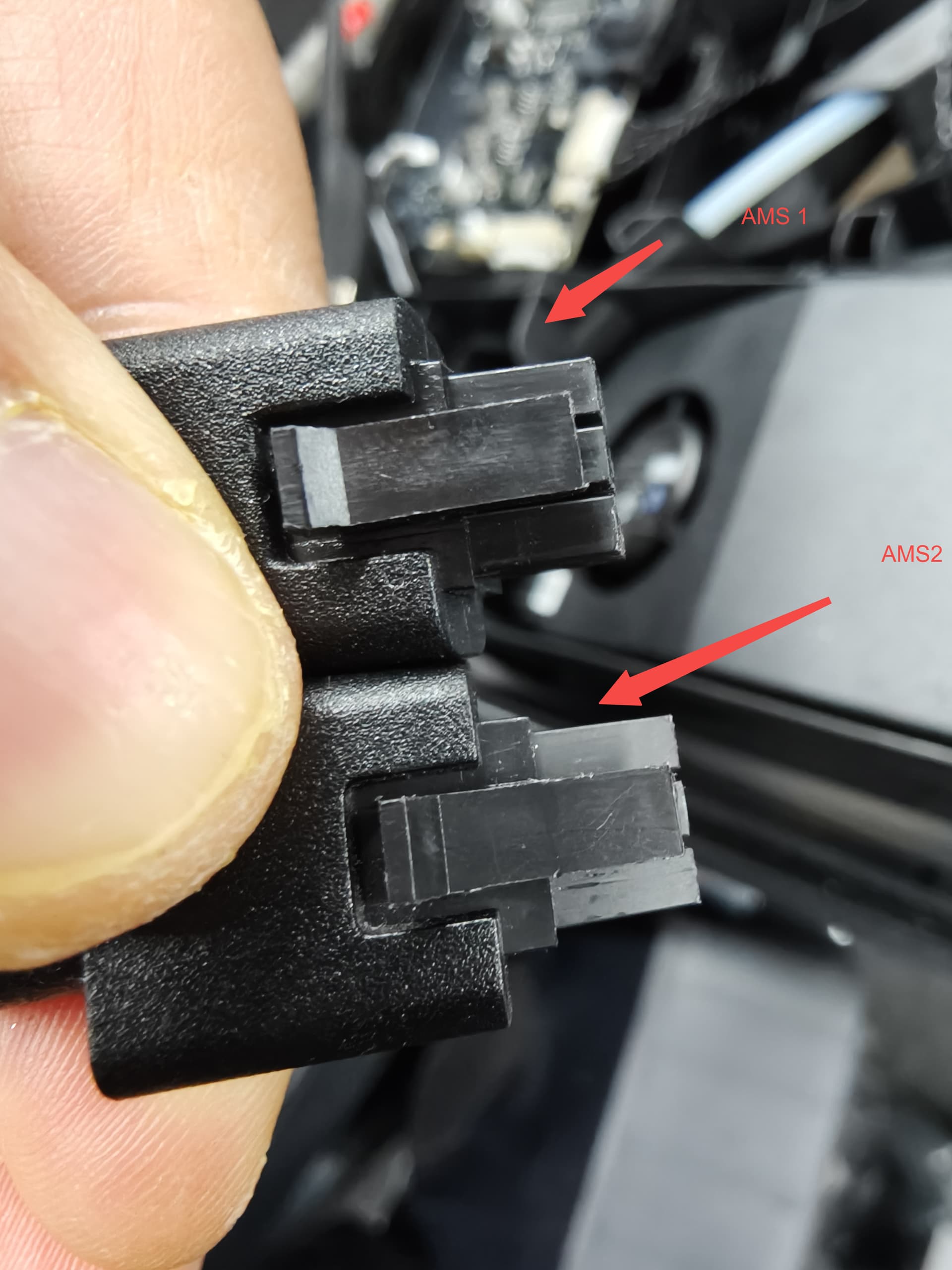

I will check later to make sure the data cables are the same they should be but it may be similar to the ams 2 pro and it 6 pin cable being different compared to previous generations

The AMS cables are only physically different because of the slightly deeper recess of the AMS2, nothing electrical.
Ok guys I looked the ap power cable now just has a cover over the entire thing and yes the ap data cable is different is has less connectors and more in other places “probably removing unnecessary wires after a few connectors we’re also removed”

Still wonder why the power cable is required, does it seem to be of larger section (lower gauge)?

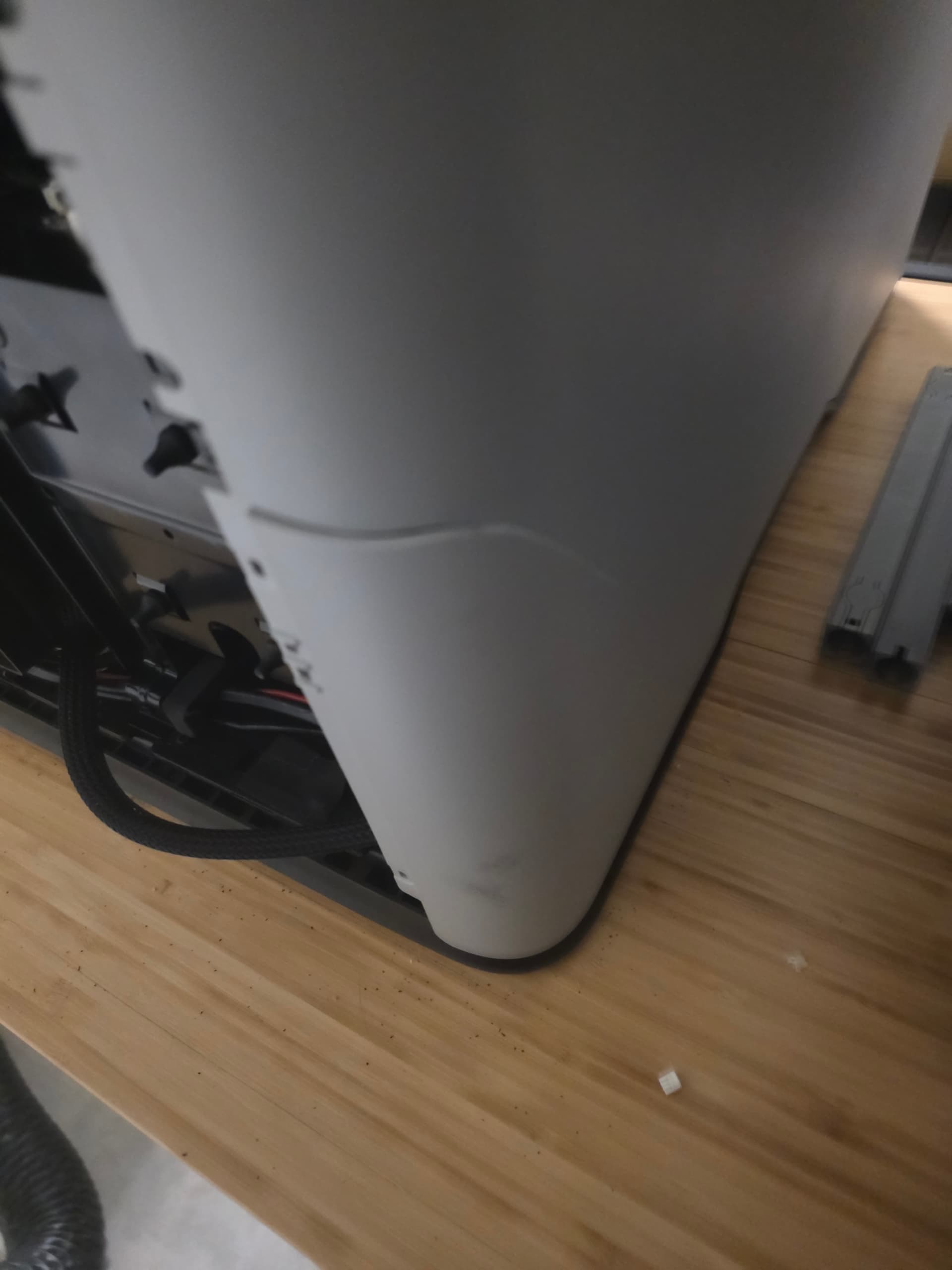

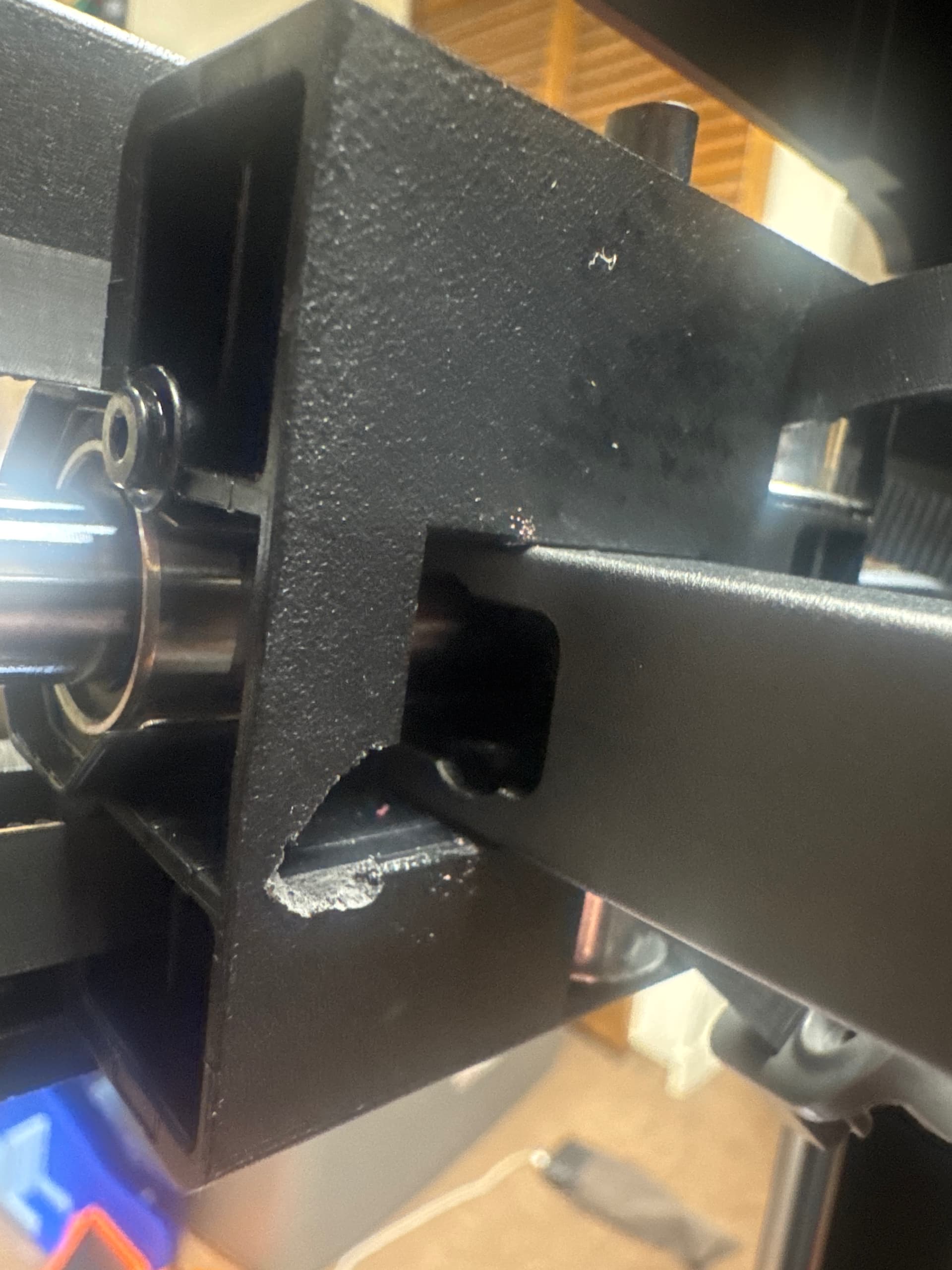

■■■■. Well the left pabel on my unit developed a massive fracture during the upgrade. Guess I can deal with both at once :confused: .
Maybe I’ll just get the black panels at this point…
I am doing that right now any tips I can’t get the top to come of the panel to come loose “ never mind figured it out there are more plastic pieces than I though would have been nice to know that”
I wish I could give a tip, but it’s plastic that goes through a ton of heat cycles. I’ll let you know if they cover it under warranty or offer a discount on a replacement piece. Here’s a photo if it helps.

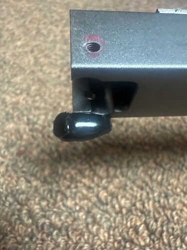

Was there glue/something on the back of your old linear rails in the assembly’s?
There was some adhesive behind the fan. The crack happened when I was putting it back on though. It is material fatigue.

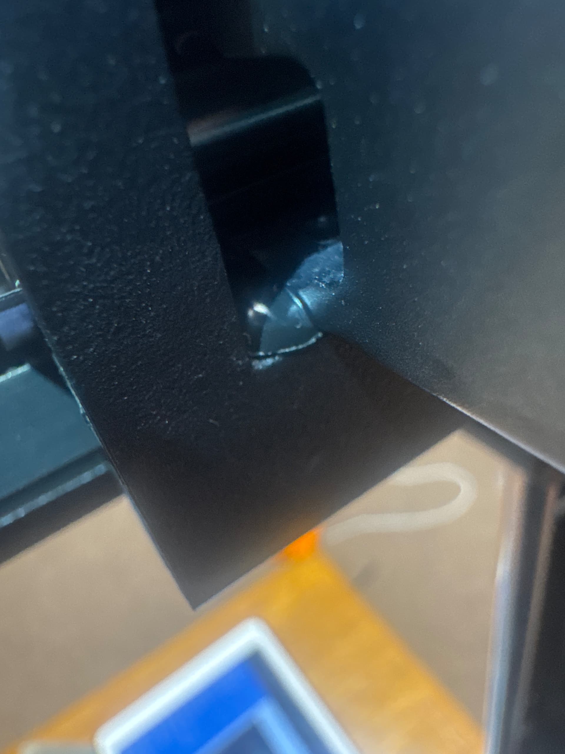

This stuff is stoping from removing the old rails
Well crap it’s just visual though so…..
You need to angle it for release. ■■■■-eyed. Bring one rail forward and one back.
bRo this was welded onto both the rails there was no way it was coming off
File a ticket. They should cover something like that.
